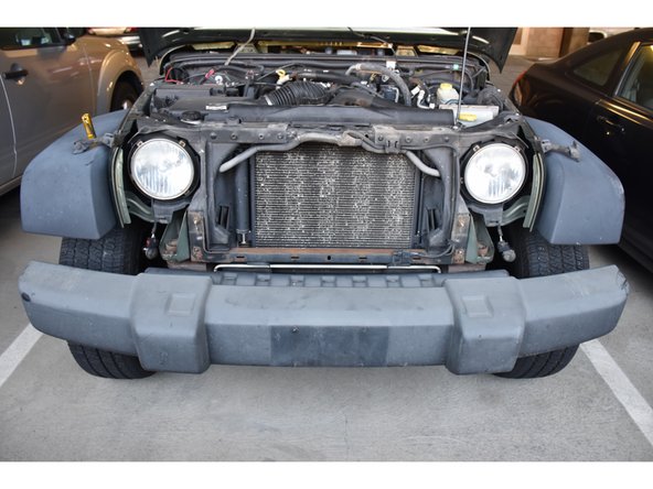

    • Locate the two gray latches on either side of the hood near the headlights.
    • Pull the latches away from the hood to release the latches.
  2. 2007-2012 Jeep Wrangler Headlight Replacement: crwdns2935265:02crwdnd2935265:01crwdnd2935265:02crwdne2935265:0 2007-2012 Jeep Wrangler Headlight Replacement: crwdns2935265:02crwdnd2935265:02crwdnd2935265:02crwdne2935265:0
    • Reach under the hood and push the lever left to right. You should now be able to lift the hood.
    • Prop open the hood by inserting the support rod into the designated hole on the underside of the hood.
  3. 2007-2012 Jeep Wrangler Headlight Replacement: crwdns2935265:03crwdnd2935265:01crwdnd2935265:03crwdne2935265:0 2007-2012 Jeep Wrangler Headlight Replacement: crwdns2935265:03crwdnd2935265:02crwdnd2935265:03crwdne2935265:0 2007-2012 Jeep Wrangler Headlight Replacement: crwdns2935265:03crwdnd2935265:03crwdnd2935265:03crwdne2935265:0

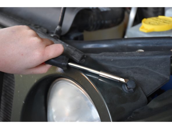

    • Locate all six push on fasteners on the top of the grill.
    • Use a flathead screwdriver to pry up the fasteners, and make sure you put the screws somewhere safe.
    • If the fasteners will not come up, use two flathead screwdrivers on either side of the fastener to remove.
  4. 2007-2012 Jeep Wrangler Headlight Replacement: crwdns2935265:04crwdnd2935265:01crwdnd2935265:03crwdne2935265:0 2007-2012 Jeep Wrangler Headlight Replacement: crwdns2935265:04crwdnd2935265:02crwdnd2935265:03crwdne2935265:0 2007-2012 Jeep Wrangler Headlight Replacement: crwdns2935265:04crwdnd2935265:03crwdnd2935265:03crwdne2935265:0

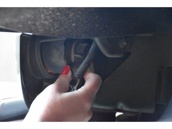

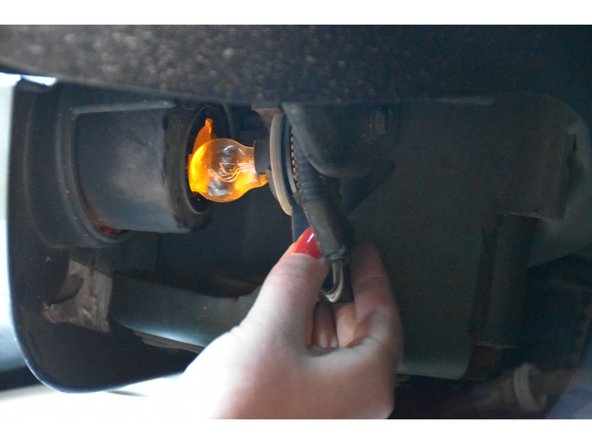

    • Locate right and left blinker lights under the fenders.
    • Twist blinker light toward the ground, and make sure you pull the bulb out carefully.
    • Make sure you are handling bulb carefully.

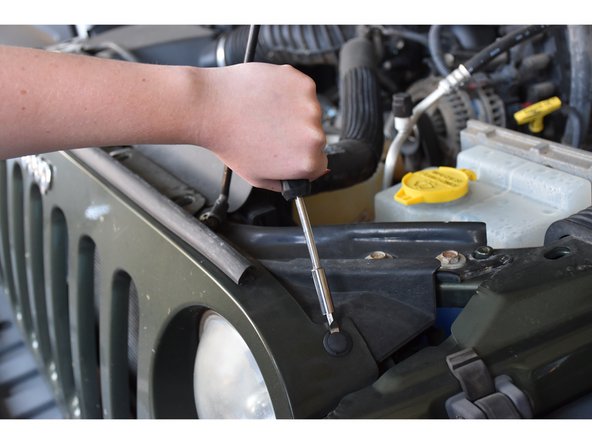

  5. 2007-2012 Jeep Wrangler Headlight Replacement: crwdns2935265:05crwdnd2935265:01crwdnd2935265:03crwdne2935265:0 2007-2012 Jeep Wrangler Headlight Replacement: crwdns2935265:05crwdnd2935265:02crwdnd2935265:03crwdne2935265:0 2007-2012 Jeep Wrangler Headlight Replacement: crwdns2935265:05crwdnd2935265:03crwdnd2935265:03crwdne2935265:0
    • Make sure all fasteners are removed from top of the grill, and the top of the grill is loose.
    • Firmly pull the bottom of the grill until the grill disconnects from the jeep.

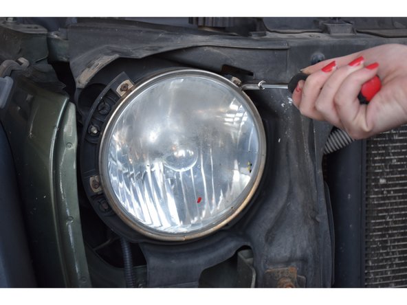

  6. 2007-2012 Jeep Wrangler Headlight Replacement: crwdns2935265:06crwdnd2935265:01crwdnd2935265:02crwdne2935265:0 2007-2012 Jeep Wrangler Headlight Replacement: crwdns2935265:06crwdnd2935265:02crwdnd2935265:02crwdne2935265:0
    • Locate the 4 screws holding the headlight in place.
    • Use a star bit screwdriver to unscrew the .164-18 x .625 mm star bit screws around the headlight, and make sure you place screws somewhere safe.
    • Hold the headlight when unscrewing last screw to prevent the headlight from falling.

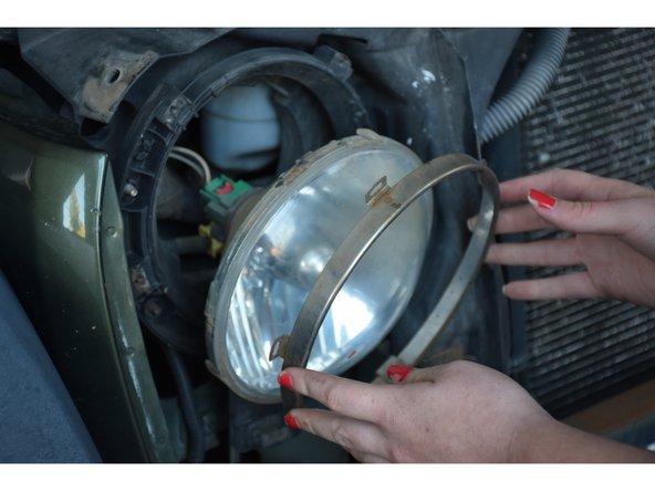

  7. 2007-2012 Jeep Wrangler Headlight Replacement: crwdns2935265:07crwdnd2935265:01crwdnd2935265:02crwdne2935265:0 2007-2012 Jeep Wrangler Headlight Replacement: crwdns2935265:07crwdnd2935265:02crwdnd2935265:02crwdne2935265:0
    • Use your hands to carefully remove silver ring from the headlight.
  8. 2007-2012 Jeep Wrangler Headlight Replacement: crwdns2935265:08crwdnd2935265:01crwdnd2935265:03crwdne2935265:0 2007-2012 Jeep Wrangler Headlight Replacement: crwdns2935265:08crwdnd2935265:02crwdnd2935265:03crwdne2935265:0 2007-2012 Jeep Wrangler Headlight Replacement: crwdns2935265:08crwdnd2935265:03crwdnd2935265:03crwdne2935265:0
    • Locate red tab on the headlight plug connector, and push it away from the headlight.
    • Firmly pull the connector away from headlight to remove.
