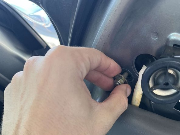

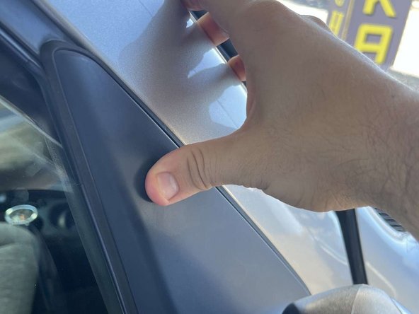

    • Remove the plastic piece covering from the mirror bolts.
    • Place the flat head screwdriver behind the plastic covering for leverage.
    • Pop off the plastic piece to uncover all the hidden bolts.
  2. 2006 Toyota Tundra Side Mirror Replacement: crwdns2935265:02crwdnd2935265:01crwdnd2935265:03crwdne2935265:0 2006 Toyota Tundra Side Mirror Replacement: crwdns2935265:02crwdnd2935265:02crwdnd2935265:03crwdne2935265:0 2006 Toyota Tundra Side Mirror Replacement: crwdns2935265:02crwdnd2935265:03crwdnd2935265:03crwdne2935265:0

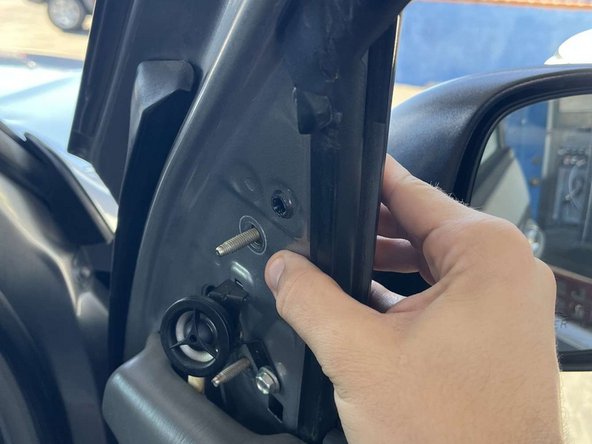

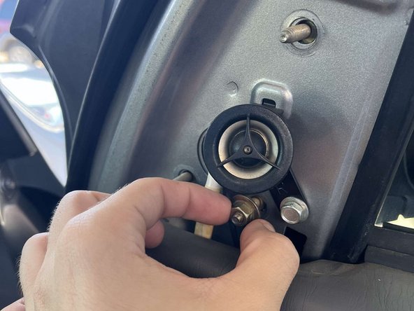

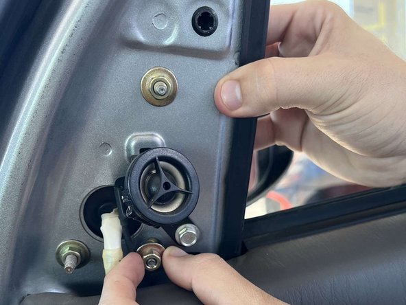

    • Remove the first bolt.
    • Use the 10mm wrench to loosen the three bolts.
    • Loosen the bolts to the end but do not take the bolts off completely.
  3. 2006 Toyota Tundra Side Mirror Replacement: crwdns2935265:03crwdnd2935265:01crwdnd2935265:03crwdne2935265:0 2006 Toyota Tundra Side Mirror Replacement: crwdns2935265:03crwdnd2935265:02crwdnd2935265:03crwdne2935265:0 2006 Toyota Tundra Side Mirror Replacement: crwdns2935265:03crwdnd2935265:03crwdnd2935265:03crwdne2935265:0
    • Remove the bolts by hand.
    • Place all the bolts in a secure location such as your pocket.

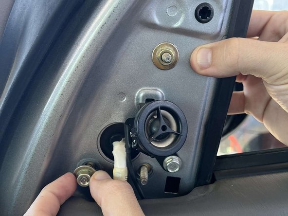

  4. 2006 Toyota Tundra Side Mirror Replacement: crwdns2935265:04crwdnd2935265:01crwdnd2935265:02crwdne2935265:0 2006 Toyota Tundra Side Mirror Replacement: crwdns2935265:04crwdnd2935265:02crwdnd2935265:02crwdne2935265:0

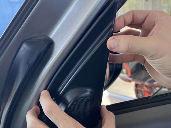

    • Once all the bolts are off, approach the other plastic mirror covering from the outside door.
    • Slowly pop off the plastic covering using your hands.
    • This process should be almost effortless to remove the piece.

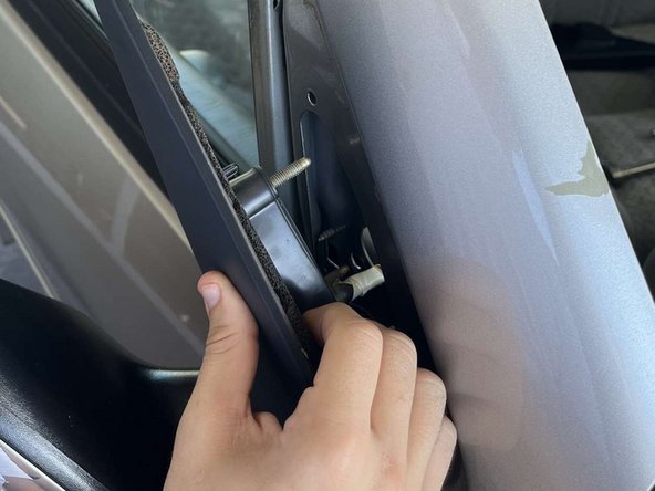

    • Once the mirror is off, push the plastic covering back on.
    • Pinch the plastic covering from both sides with one hand to make sure it is in place.
    • Make sure to keep your window rolled down for this step.

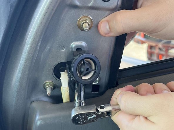

  6. 2006 Toyota Tundra Side Mirror Replacement: crwdns2935265:06crwdnd2935265:01crwdnd2935265:03crwdne2935265:0 2006 Toyota Tundra Side Mirror Replacement: crwdns2935265:06crwdnd2935265:02crwdnd2935265:03crwdne2935265:0 2006 Toyota Tundra Side Mirror Replacement: crwdns2935265:06crwdnd2935265:03crwdnd2935265:03crwdne2935265:0
    • Grab the bolts that were taken off on the second step and with your hands tighten the bolts as much as possible.
    • Repeat this step for all three bolts.

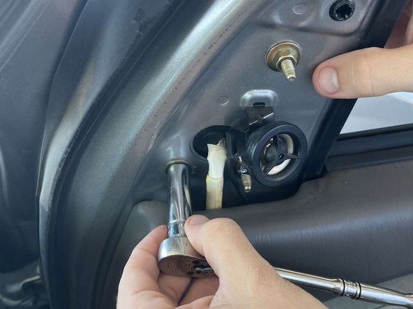

  7. 2006 Toyota Tundra Side Mirror Replacement: crwdns2935265:07crwdnd2935265:01crwdnd2935265:03crwdne2935265:0 2006 Toyota Tundra Side Mirror Replacement: crwdns2935265:07crwdnd2935265:02crwdnd2935265:03crwdne2935265:0 2006 Toyota Tundra Side Mirror Replacement: crwdns2935265:07crwdnd2935265:03crwdnd2935265:03crwdne2935265:0
    • Grab the 10mm wrench and tighten the bolts till they cannot anymore.

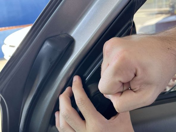

    • From the first step, grab the first plastic covering that was taken off.
    • Align the piece with all three bolts (it should fit just like a puzzle piece).
    • Snap your plastic piece back in and give it a nice hit to make sure it is locked in till you hear a snap.
