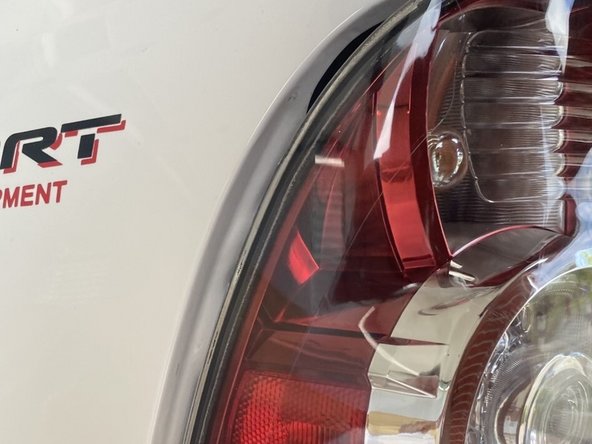

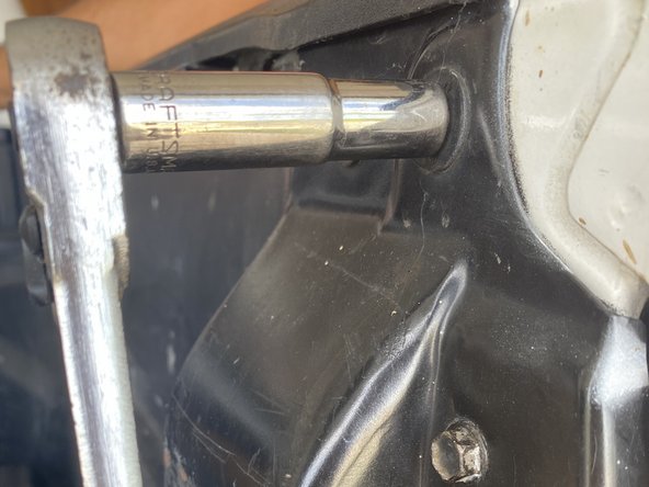

  4. 2006 Toyota Tacoma Signal Lights Replacement: crwdns2935265:04crwdnd2935265:01crwdnd2935265:01crwdne2935265:0
    • Prepare to remove the old turn signal.
    • Open the hood of the lens.
  5. 2006 Toyota Tacoma Signal Lights Replacement: crwdns2935265:05crwdnd2935265:01crwdnd2935265:02crwdne2935265:0 2006 Toyota Tacoma Signal Lights Replacement: crwdns2935265:05crwdnd2935265:02crwdnd2935265:02crwdne2935265:0
    • If needed, use a screwdriver to remove hood.

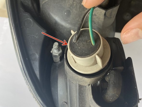

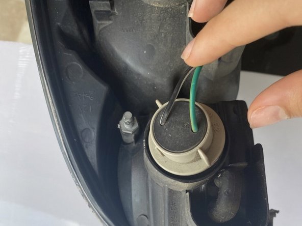

  6. 2006 Toyota Tacoma Signal Lights Replacement: crwdns2935265:06crwdnd2935265:01crwdnd2935265:03crwdne2935265:0 2006 Toyota Tacoma Signal Lights Replacement: crwdns2935265:06crwdnd2935265:02crwdnd2935265:03crwdne2935265:0 2006 Toyota Tacoma Signal Lights Replacement: crwdns2935265:06crwdnd2935265:03crwdnd2935265:03crwdne2935265:0

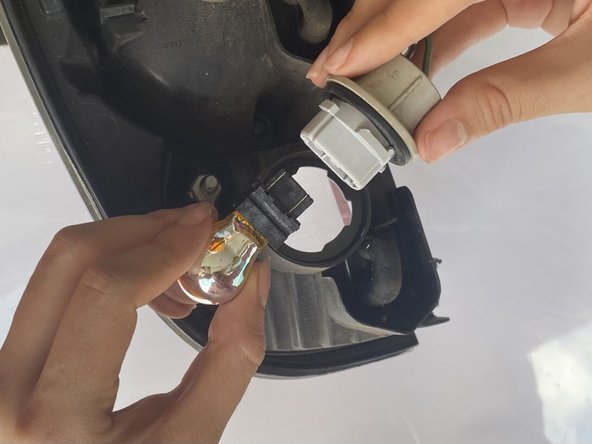

    • Remove the light bulb casing.
  7. 2006 Toyota Tacoma Signal Lights Replacement: crwdns2935265:07crwdnd2935265:01crwdnd2935265:03crwdne2935265:0 2006 Toyota Tacoma Signal Lights Replacement: crwdns2935265:07crwdnd2935265:02crwdnd2935265:03crwdne2935265:0 2006 Toyota Tacoma Signal Lights Replacement: crwdns2935265:07crwdnd2935265:03crwdnd2935265:03crwdne2935265:0
    • If needed, replace the electric connector with a new one, aligning and screwing the replacement in the same place.
    • Push the locking and turn it counterclockwise to unscrew the bulb.

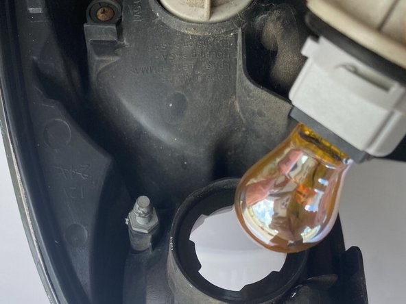

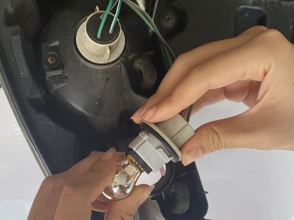

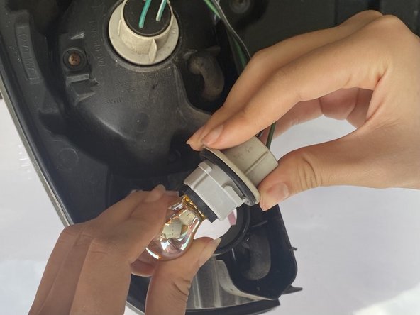

  8. 2006 Toyota Tacoma Signal Lights Replacement: crwdns2935265:08crwdnd2935265:01crwdnd2935265:02crwdne2935265:0 2006 Toyota Tacoma Signal Lights Replacement: crwdns2935265:08crwdnd2935265:02crwdnd2935265:02crwdne2935265:0
    • Replace the bulb with the new one.
    • Insert the new bulb. Align the pins on the bulb with the ones inside of the car.
  9. 2006 Toyota Tacoma Signal Lights Replacement: crwdns2935265:09crwdnd2935265:01crwdnd2935265:03crwdne2935265:0 2006 Toyota Tacoma Signal Lights Replacement: crwdns2935265:09crwdnd2935265:02crwdnd2935265:03crwdne2935265:0 2006 Toyota Tacoma Signal Lights Replacement: crwdns2935265:09crwdnd2935265:03crwdnd2935265:03crwdne2935265:0
    • Place the new bulb back on the designated place.
    • Replace the hood/lens back on the car.
    • Turn the ignition switch on and engage the blinker lever (first step) to ensure proper instalment.
