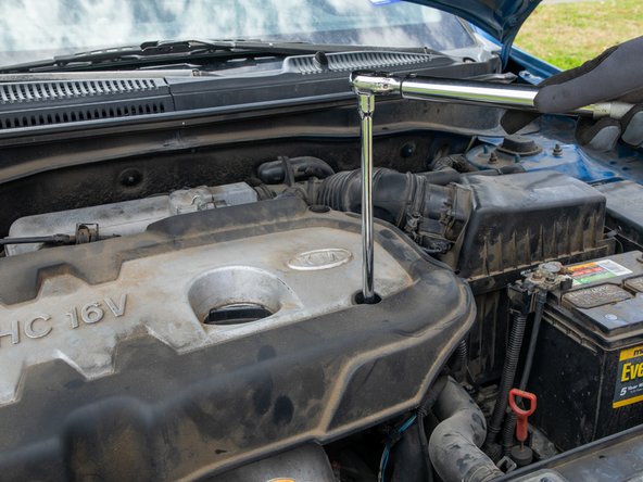

    • Open the car's hood using the latch under the steering wheel, next to the door.
  2. 2006 Kia Rio Engine Valve Cover Gasket Replacement: crwdns2935265:02crwdnd2935265:01crwdnd2935265:03crwdne2935265:0 2006 Kia Rio Engine Valve Cover Gasket Replacement: crwdns2935265:02crwdnd2935265:02crwdnd2935265:03crwdne2935265:0 2006 Kia Rio Engine Valve Cover Gasket Replacement: crwdns2935265:02crwdnd2935265:03crwdnd2935265:03crwdne2935265:0

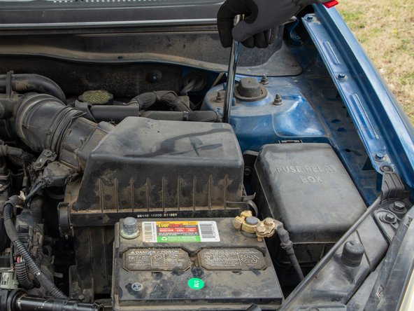

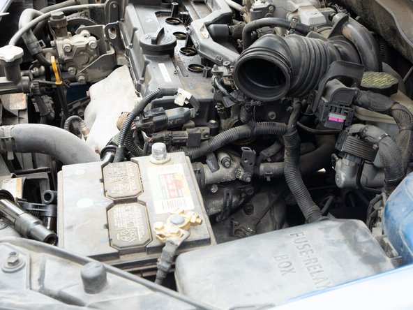

    • Remove the battery connection.
    • Loosen the tension bolt on the negative (-) terminal.
    • The stock terminal uses a 10mm bolt.
    • Pull the terminal off the battery and tuck it away.
  3. 2006 Kia Rio Engine Valve Cover Gasket Replacement: crwdns2935265:03crwdnd2935265:01crwdnd2935265:03crwdne2935265:0 2006 Kia Rio Engine Valve Cover Gasket Replacement: crwdns2935265:03crwdnd2935265:02crwdnd2935265:03crwdne2935265:0 2006 Kia Rio Engine Valve Cover Gasket Replacement: crwdns2935265:03crwdnd2935265:03crwdnd2935265:03crwdne2935265:0

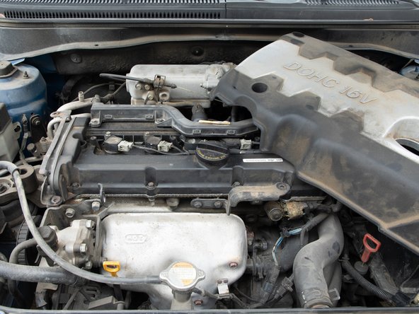

    • Remove the four bolts with a 10 mm socket.
    • Take off the dust cover.

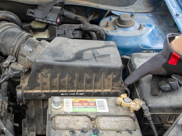

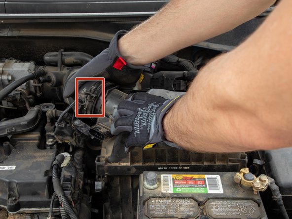

    • Remove the air filter housing.
    • Disconnect the electronics and air intake hoses.
    • Loosen the tension screw on the air intake hose with a 10 mm socket.
    • Undo all latches and pull away the housing cap.

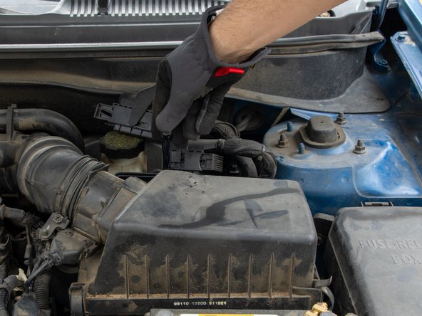

    • Disconnect the computer terminals.
    • Release the tension clamps on the two terminals.
    • Tuck both terminals out of the way.

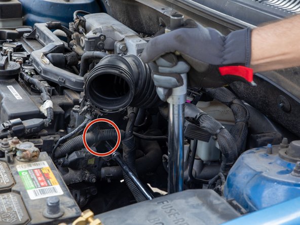

    • Unbolt the air filter housing.
    • Loosen the three 10 mm bolts holding the housing in place.
    • Each photo shows one of the three bolts.

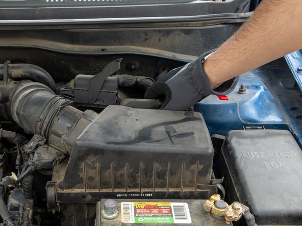

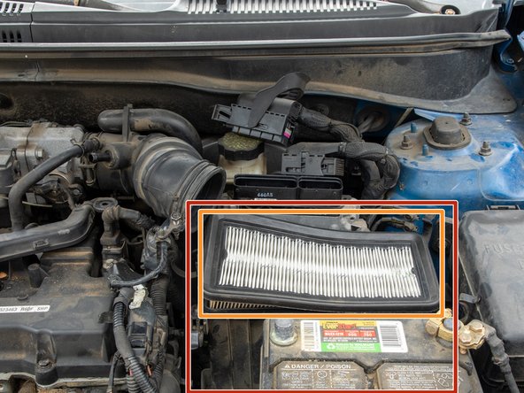

    • Remove the air intake assembly.
    • Remove both the air filter cap and the housing.
    • Avoid getting the air filter dirty.

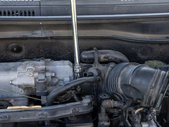

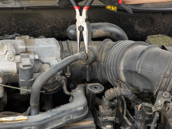

    • There are two hoses connected to the valve cover.
    • Use any set of pliers to loosen the tension clamps on each hose.
    • Disconnect the hoses by pulling them off their contact points.
  10. 2006 Kia Rio Engine Valve Cover Gasket Replacement: crwdns2935265:010crwdnd2935265:01crwdnd2935265:03crwdne2935265:0 2006 Kia Rio Engine Valve Cover Gasket Replacement: crwdns2935265:010crwdnd2935265:02crwdnd2935265:03crwdne2935265:0 2006 Kia Rio Engine Valve Cover Gasket Replacement: crwdns2935265:010crwdnd2935265:03crwdnd2935265:03crwdne2935265:0

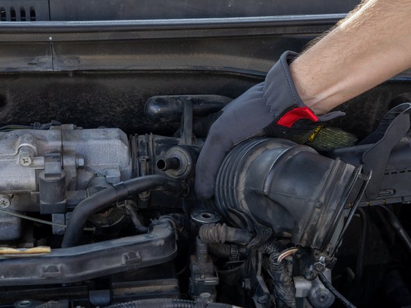

    • Remove the air intake pipe.
    • Loosen the 10 mm tension screw to release the clamp on this end of the hose.
    • Pull the hose free from the rear intake assembly.

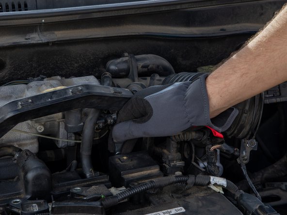

  11. 2006 Kia Rio Engine Valve Cover Gasket Replacement: crwdns2935265:011crwdnd2935265:01crwdnd2935265:01crwdne2935265:0
    • Loosen the three 10 mm bolts holding the wire guide in place.
    • Move the guide out of the way.

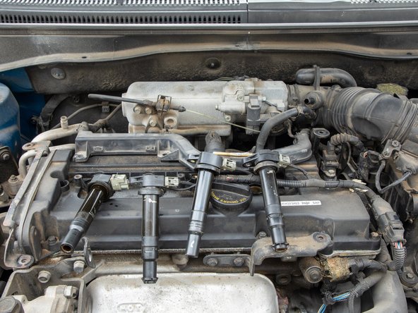

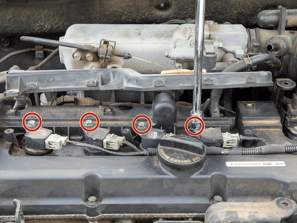

    • Disconnect and remove the ignition coils.
    • Remove the four 10 mm bolts holding the four ignition coils in place.
    • Try to keep the coils connected and in order.

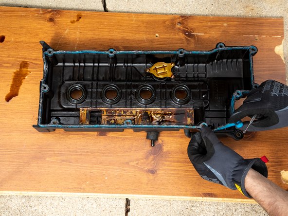

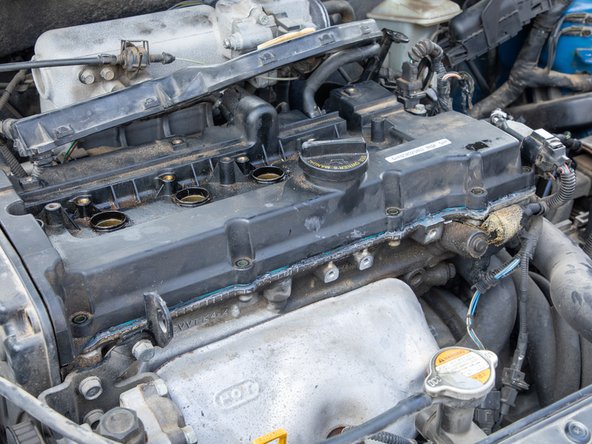

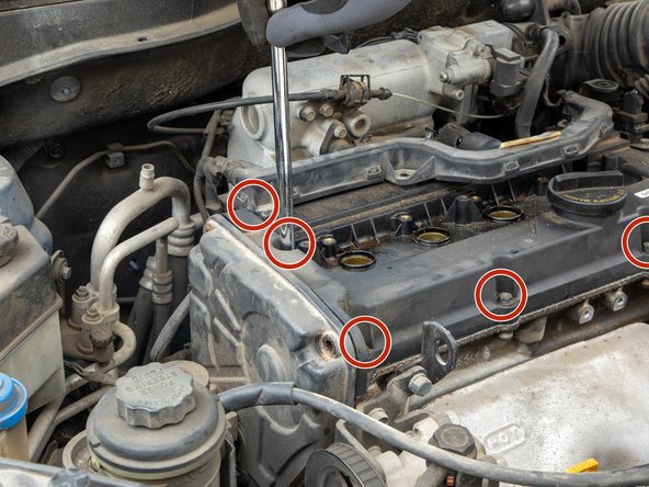

    • Remove twelve 10 mm bolts from the valve cover on the engine head.
    • Move parts around until each bolt is reachable.

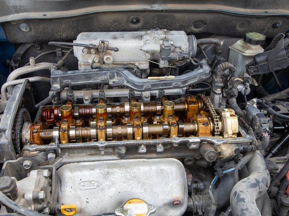

  15. 2006 Kia Rio Engine Valve Cover Gasket Replacement: crwdns2935265:015crwdnd2935265:01crwdnd2935265:02crwdne2935265:0 2006 Kia Rio Engine Valve Cover Gasket Replacement: crwdns2935265:015crwdnd2935265:02crwdnd2935265:02crwdne2935265:0
    • Remove the engine head.
    • Make sure the engine is kept clean. Avoid getting dust or other contaminants into the uncovered assembly.

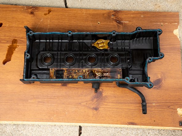

  16. 2006 Kia Rio Engine Valve Cover Gasket Replacement: crwdns2935265:016crwdnd2935265:01crwdnd2935265:03crwdne2935265:0 2006 Kia Rio Engine Valve Cover Gasket Replacement: crwdns2935265:016crwdnd2935265:02crwdnd2935265:03crwdne2935265:0 2006 Kia Rio Engine Valve Cover Gasket Replacement: crwdns2935265:016crwdnd2935265:03crwdnd2935265:03crwdne2935265:0

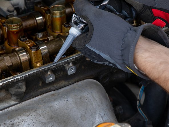

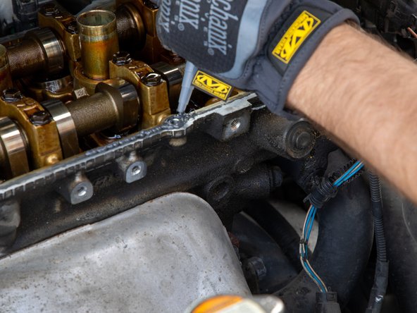

    • Clean the residue off of the engine block.
    • Keep the rim as clean and level as possible.
    • Apply a steady line of gasket maker with a 1/4" thickness around the engine block.
    • Surround each bolt hole on the block with gasket maker.
