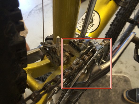

  4. 2006 Iron Horse Warrior Chain Replacement: crwdns2935265:04crwdnd2935265:01crwdnd2935265:02crwdne2935265:0 2006 Iron Horse Warrior Chain Replacement: crwdns2935265:04crwdnd2935265:02crwdnd2935265:02crwdne2935265:0
    • Set the chain, with the loose end on top, on the chain ring.
    • Make sure the chain goes thru the guide at the top of the chain ring.
