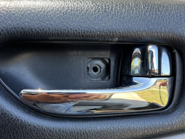

  1. 2006 Infiniti G35 Coupe Passenger Side Door Checker Replacement, Passenger Side Door Checker: crwdns2935265:01crwdnd2935265:01crwdnd2935265:02crwdne2935265:0 2006 Infiniti G35 Coupe Passenger Side Door Checker Replacement, Passenger Side Door Checker: crwdns2935265:01crwdnd2935265:02crwdnd2935265:02crwdne2935265:0

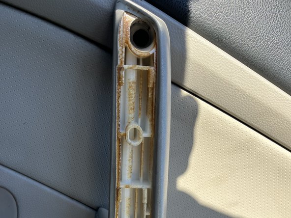

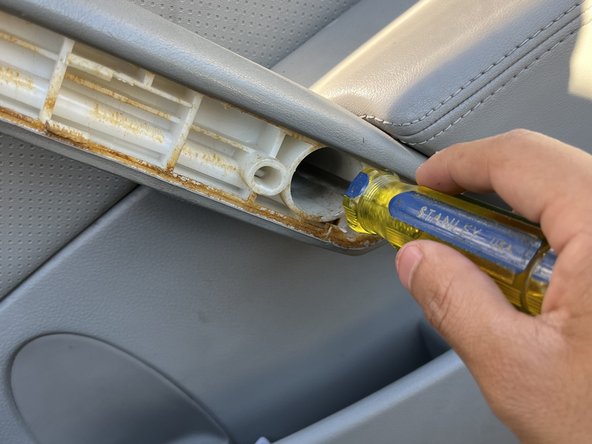

    • Use a Phillips screwdriver to remove the screw from the interior door handle.
    • Caution: Avoid applying excessive force to prevent stripping the screw head.

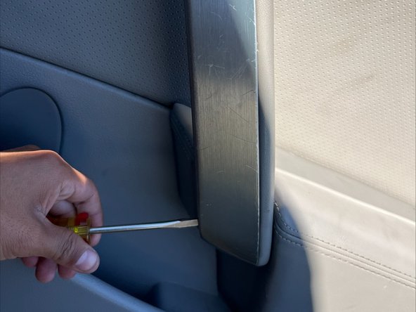

  2. 2006 Infiniti G35 Coupe Passenger Side Door Checker Replacement: crwdns2935265:02crwdnd2935265:01crwdnd2935265:03crwdne2935265:0 2006 Infiniti G35 Coupe Passenger Side Door Checker Replacement: crwdns2935265:02crwdnd2935265:02crwdnd2935265:03crwdne2935265:0 2006 Infiniti G35 Coupe Passenger Side Door Checker Replacement: crwdns2935265:02crwdnd2935265:03crwdnd2935265:03crwdne2935265:0
    • Use a trim removal tool to pry off the trim piece on the armrest.
    • Caution: Insert the tool carefully to avoid damaging anything
    • Work slowly along the edges to release each clip evenly.

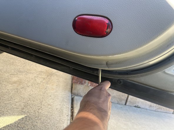

  3. 2006 Infiniti G35 Coupe Passenger Side Door Checker Replacement: crwdns2935265:03crwdnd2935265:01crwdnd2935265:02crwdne2935265:0 2006 Infiniti G35 Coupe Passenger Side Door Checker Replacement: crwdns2935265:03crwdnd2935265:02crwdnd2935265:02crwdne2935265:0

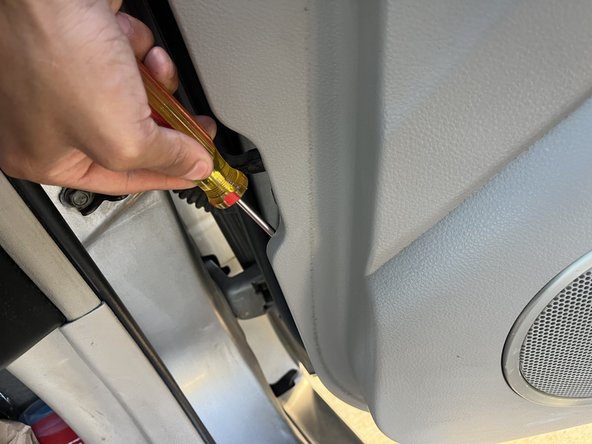

    • Use a Phillips screwdriver to remove the screws hidden under the armrest trim and at the bottom edge of the door panel.
    • Take note of the screw lengths to ensure proper placement during reassembly.
  4. 2006 Infiniti G35 Coupe Passenger Side Door Checker Replacement: crwdns2935265:04crwdnd2935265:01crwdnd2935265:03crwdne2935265:0 2006 Infiniti G35 Coupe Passenger Side Door Checker Replacement: crwdns2935265:04crwdnd2935265:02crwdnd2935265:03crwdne2935265:0 2006 Infiniti G35 Coupe Passenger Side Door Checker Replacement: crwdns2935265:04crwdnd2935265:03crwdnd2935265:03crwdne2935265:0
    • Carefully pull the door panel away from the door frame to release the clips. Start from the bottom and work your way around the edges.
    • Caution: Do not pull too hard to avoid breaking the plastic clips.
    • Listen for the sound of clips releasing to ensure all are detached.

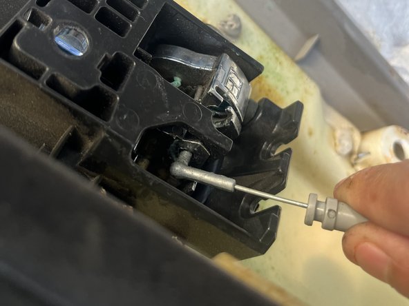

  5. 2006 Infiniti G35 Coupe Passenger Side Door Checker Replacement: crwdns2935265:05crwdnd2935265:01crwdnd2935265:02crwdne2935265:0 2006 Infiniti G35 Coupe Passenger Side Door Checker Replacement: crwdns2935265:05crwdnd2935265:02crwdnd2935265:02crwdne2935265:0
    • Carefully disconnect the door from the interior mechanism.
    • Label the connectors if necessary to avoid confusion during reassembly.
  6. 2006 Infiniti G35 Coupe Passenger Side Door Checker Replacement: crwdns2935265:06crwdnd2935265:01crwdnd2935265:03crwdne2935265:0 2006 Infiniti G35 Coupe Passenger Side Door Checker Replacement: crwdns2935265:06crwdnd2935265:02crwdnd2935265:03crwdne2935265:0 2006 Infiniti G35 Coupe Passenger Side Door Checker Replacement: crwdns2935265:06crwdnd2935265:03crwdnd2935265:03crwdne2935265:0

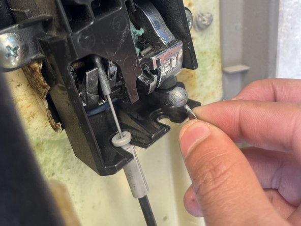

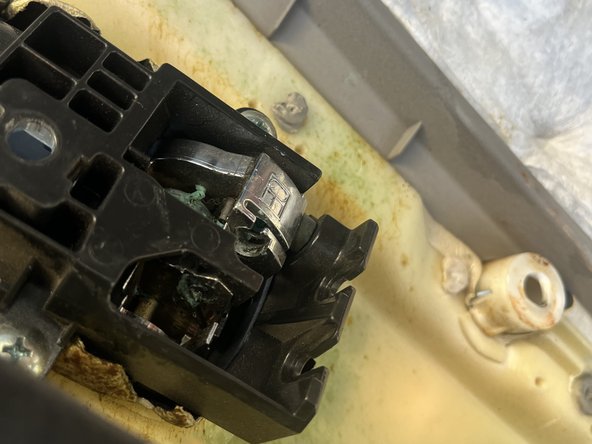

    • Disconnect the lock cable carefully from the interior mechanism.

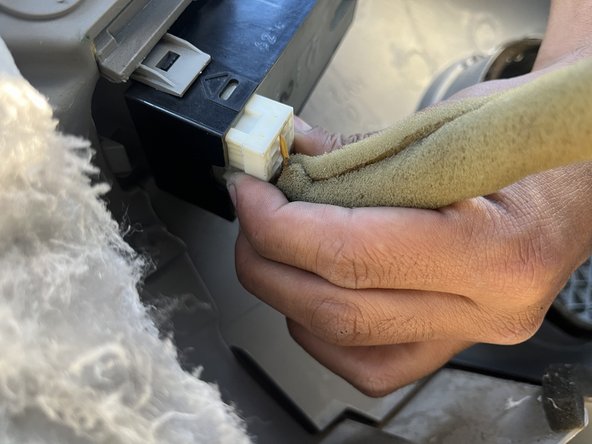

  7. 2006 Infiniti G35 Coupe Passenger Side Door Checker Replacement: crwdns2935265:07crwdnd2935265:01crwdnd2935265:03crwdne2935265:0 2006 Infiniti G35 Coupe Passenger Side Door Checker Replacement: crwdns2935265:07crwdnd2935265:02crwdnd2935265:03crwdne2935265:0 2006 Infiniti G35 Coupe Passenger Side Door Checker Replacement: crwdns2935265:07crwdnd2935265:03crwdnd2935265:03crwdne2935265:0
    • Gently unplug all electrical connectors, including those for the window and locking controls
    • Caution: Avoid pulling on the wires directly; press the release tabs on the connectors.

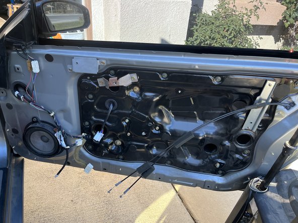

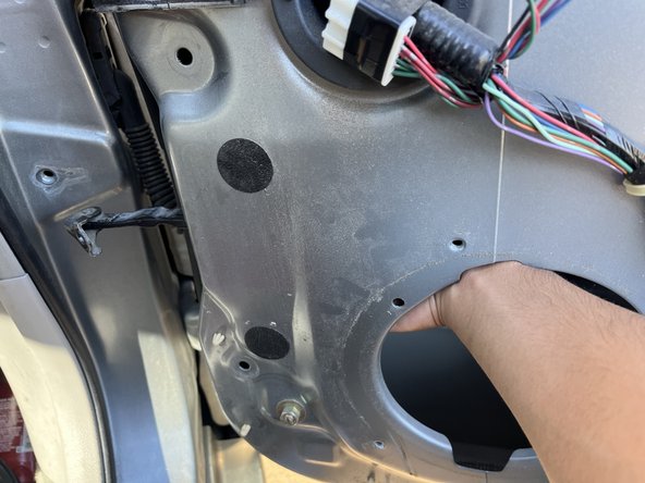

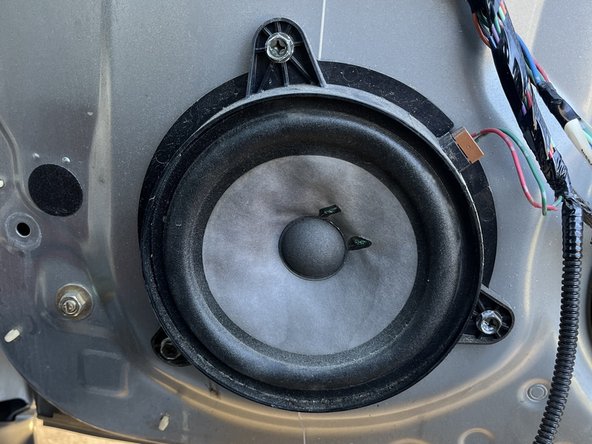

    • Use a ratchet to remove the screws securing the speaker to the door frame and carefully disconnect the speaker and set it aside.
    • Handle the speaker gently to avoid damaging its delicate components.
    • There is no need to disconnect the speaker; it can be placed carefully to the side.

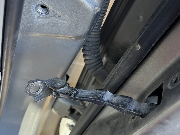

  9. 2006 Infiniti G35 Coupe Passenger Side Door Checker Replacement: crwdns2935265:09crwdnd2935265:01crwdnd2935265:03crwdne2935265:0 2006 Infiniti G35 Coupe Passenger Side Door Checker Replacement: crwdns2935265:09crwdnd2935265:02crwdnd2935265:03crwdne2935265:0 2006 Infiniti G35 Coupe Passenger Side Door Checker Replacement: crwdns2935265:09crwdnd2935265:03crwdnd2935265:03crwdne2935265:0

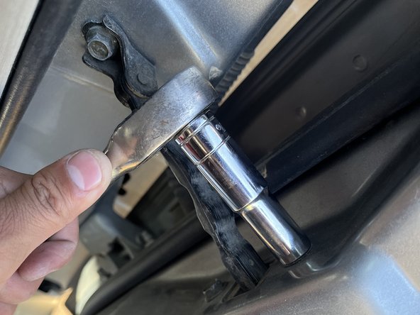

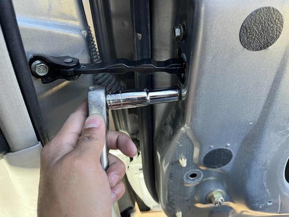

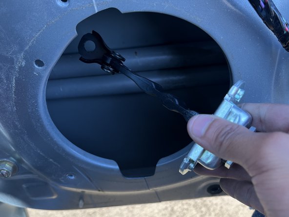

    • Use a 10mm socket wrench to unbolt the door checker from the car door frame.
    • Support the door while unbolting to prevent it from shifting or sagging.
    • Keep the bolts with the old door checker for reference during installation.
  10. 2006 Infiniti G35 Coupe Passenger Side Door Checker Replacement: crwdns2935265:010crwdnd2935265:01crwdnd2935265:03crwdne2935265:0 2006 Infiniti G35 Coupe Passenger Side Door Checker Replacement: crwdns2935265:010crwdnd2935265:02crwdnd2935265:03crwdne2935265:0 2006 Infiniti G35 Coupe Passenger Side Door Checker Replacement: crwdns2935265:010crwdnd2935265:03crwdnd2935265:03crwdne2935265:0

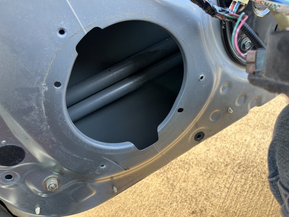

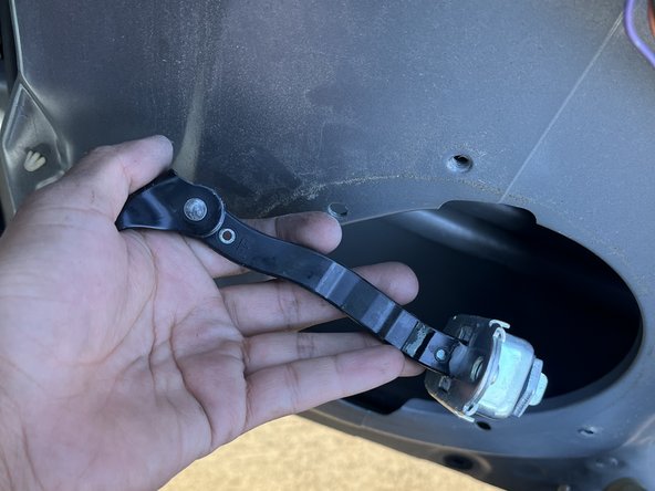

    • Reach into the access hole in the door panel to grip the door checker. Carefully slide it out through the hole.
    • Caution: Be mindful of sharp edges inside the door panel to avoid injury.
  11. 2006 Infiniti G35 Coupe Passenger Side Door Checker Replacement: crwdns2935265:011crwdnd2935265:01crwdnd2935265:03crwdne2935265:0 2006 Infiniti G35 Coupe Passenger Side Door Checker Replacement: crwdns2935265:011crwdnd2935265:02crwdnd2935265:03crwdne2935265:0 2006 Infiniti G35 Coupe Passenger Side Door Checker Replacement: crwdns2935265:011crwdnd2935265:03crwdnd2935265:03crwdne2935265:0

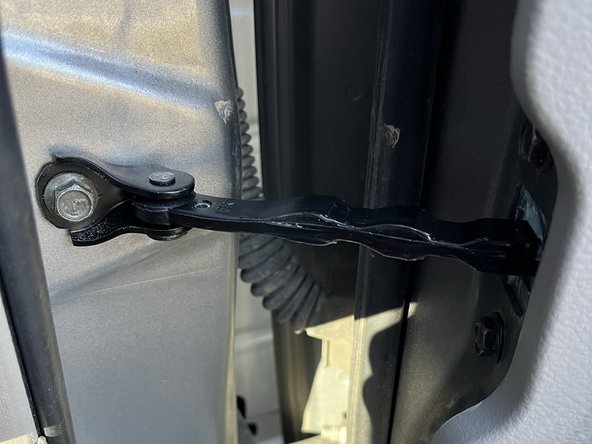

    • Align the new door checker with the mounting holes inside the door frame. Carefully insert it through the access hole and ensure proper positioning.
    • Double-check the alignment of the door checker before bolting it in place.
  12. 2006 Infiniti G35 Coupe Passenger Side Door Checker Replacement: crwdns2935265:012crwdnd2935265:01crwdnd2935265:03crwdne2935265:0 2006 Infiniti G35 Coupe Passenger Side Door Checker Replacement: crwdns2935265:012crwdnd2935265:02crwdnd2935265:03crwdne2935265:0 2006 Infiniti G35 Coupe Passenger Side Door Checker Replacement: crwdns2935265:012crwdnd2935265:03crwdnd2935265:03crwdne2935265:0
    • Align the bolts in the holes, then use the 10mm socket wrench to bolt the new door checker securely to the frame.
    • Caution: Do not overtighten the bolts to avoid damaging the door checker or its mounting points.
    • Test the door at different angles to verify it holds open properly without popping noises.
