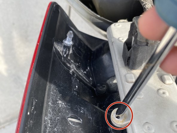

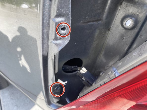

    • Remove the two screws securing the light to the truck using an Allen wrench.

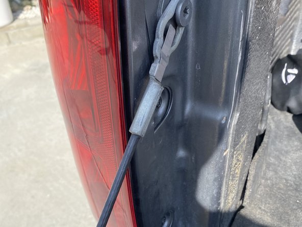

    • Pull the light casing out of the socket.
    • The wires exposed at the back of the light case are dangerous to touch as they are exposed electrical wires. Do not interact with them.

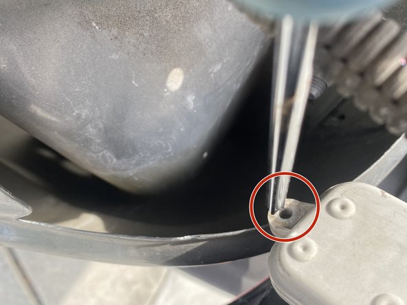

    • Remove the four screws from the light case.

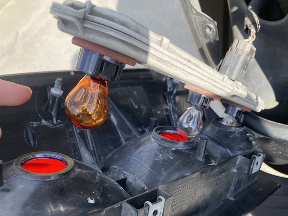

    • Remove the light case from the light bulb holders.

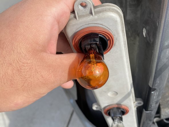

    • Replace the light bulb by gently pulling the original light bulb out.
    • Replace the lightbulb with a new one.

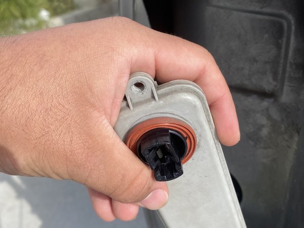

    • Reattach the lightbulbs to the light casing and put the 4 screws back in.

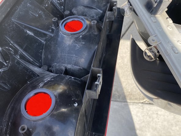

    • Pop the light casing back into place by making sure the two pointed ends go into the holes.
    • Replace the two screws that secure the light to the truck using an Allen wrench.
