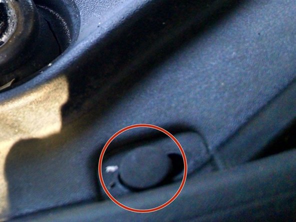

  1. 2006-2008 Isuzu i-Series Wiper Motor Replacement, Removing Nut Caps: crwdns2935265:01crwdnd2935265:01crwdnd2935265:01crwdne2935265:0
    • Use a plastic prying tool or spudger to gently remove nut cap from wiper base.

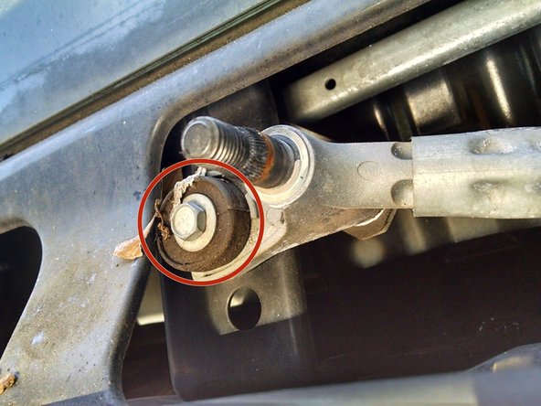

  2. 2006-2008 Isuzu i-Series Wiper Motor Replacement, Removing Nuts: crwdns2935265:02crwdnd2935265:01crwdnd2935265:03crwdne2935265:0 2006-2008 Isuzu i-Series Wiper Motor Replacement, Removing Nuts: crwdns2935265:02crwdnd2935265:02crwdnd2935265:03crwdne2935265:0 2006-2008 Isuzu i-Series Wiper Motor Replacement, Removing Nuts: crwdns2935265:02crwdnd2935265:03crwdnd2935265:03crwdne2935265:0
    • Use a 5/8 wrench or socket to remove the necessary nut holding the wiper in place.

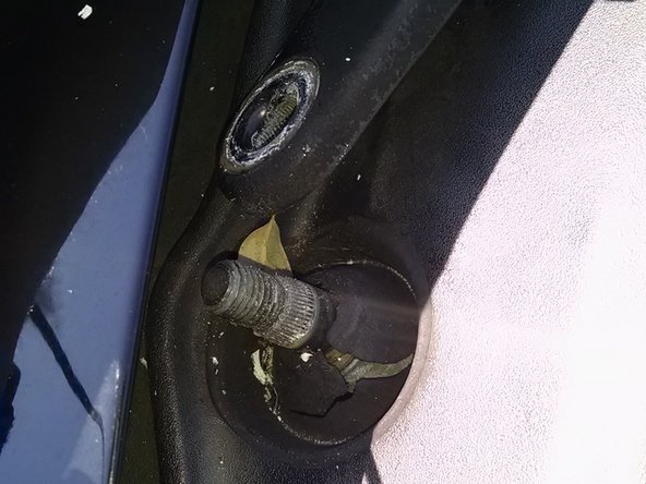

  3. 2006-2008 Isuzu i-Series Wiper Motor Replacement, Removing Wiper Arms: crwdns2935265:03crwdnd2935265:01crwdnd2935265:02crwdne2935265:0 2006-2008 Isuzu i-Series Wiper Motor Replacement, Removing Wiper Arms: crwdns2935265:03crwdnd2935265:02crwdnd2935265:02crwdne2935265:0
    • Once the necessary nuts are removed, the wiper blade itself can be removed.
    • This can be done easiest by first flexing the wiper to the upright position, then gently pulling the wiper off of the screw.

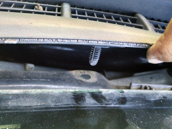

  4. 2006-2008 Isuzu i-Series Wiper Motor Replacement, Removing Retainer Clips: crwdns2935265:04crwdnd2935265:01crwdnd2935265:02crwdne2935265:0 2006-2008 Isuzu i-Series Wiper Motor Replacement, Removing Retainer Clips: crwdns2935265:04crwdnd2935265:02crwdnd2935265:02crwdne2935265:0
    • Open the hood of the truck for easier access to the wiper cowl.
    • Using pliers, locate the six retainer clips on the plastic cowl and remove them by pulling straight up.

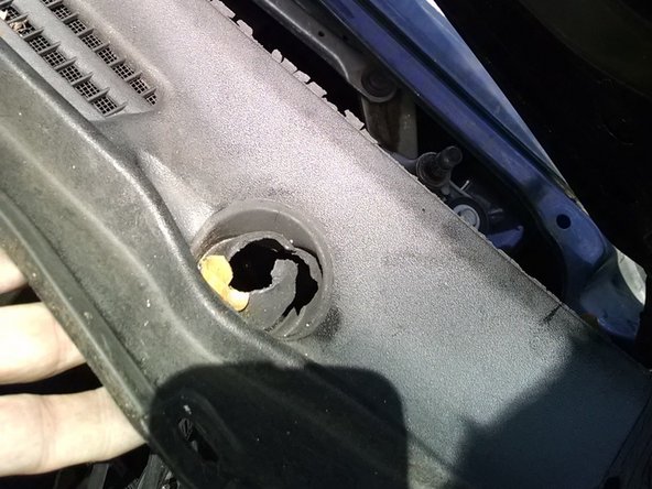

  5. 2006-2008 Isuzu i-Series Wiper Motor Replacement, Removing Wiper Cowl: crwdns2935265:05crwdnd2935265:01crwdnd2935265:03crwdne2935265:0 2006-2008 Isuzu i-Series Wiper Motor Replacement, Removing Wiper Cowl: crwdns2935265:05crwdnd2935265:02crwdnd2935265:03crwdne2935265:0 2006-2008 Isuzu i-Series Wiper Motor Replacement, Removing Wiper Cowl: crwdns2935265:05crwdnd2935265:03crwdnd2935265:03crwdne2935265:0
    • Position your hands underneath the wiper cowl and start to gently loosen the plastic from the windshield.
    • Pull straight towards the front of the truck to slide the wiper cowl over the screws that held the wiper blades, exposing the wiper components underneath.
    • The wiper cowl is flexible and can therefore be removed a little bit at a time. Take your time.

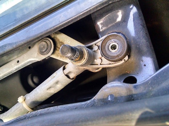

  6. 2006-2008 Isuzu i-Series Wiper Motor Replacement: crwdns2935265:06crwdnd2935265:01crwdnd2935265:03crwdne2935265:0 2006-2008 Isuzu i-Series Wiper Motor Replacement: crwdns2935265:06crwdnd2935265:02crwdnd2935265:03crwdne2935265:0 2006-2008 Isuzu i-Series Wiper Motor Replacement: crwdns2935265:06crwdnd2935265:03crwdnd2935265:03crwdne2935265:0
    • Locate the two screws on each side of the wiper assembly.
    • Use a 10mm socket or wrench and remove each screw.

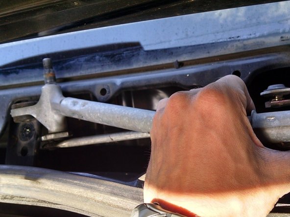

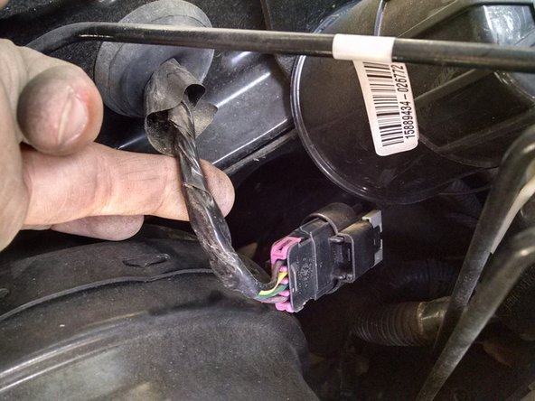

  7. 2006-2008 Isuzu i-Series Wiper Motor Replacement, Removing wiper assembly: crwdns2935265:07crwdnd2935265:01crwdnd2935265:03crwdne2935265:0 2006-2008 Isuzu i-Series Wiper Motor Replacement, Removing wiper assembly: crwdns2935265:07crwdnd2935265:02crwdnd2935265:03crwdne2935265:0 2006-2008 Isuzu i-Series Wiper Motor Replacement, Removing wiper assembly: crwdns2935265:07crwdnd2935265:03crwdnd2935265:03crwdne2935265:0
    • Rotate assembly towards the windshield while starting to remove it from the truck.
    • Unplug the wiring harness located towards the driver's side of the truck.
    • The wire can then be fed through to remove the assembly the rest of the way.

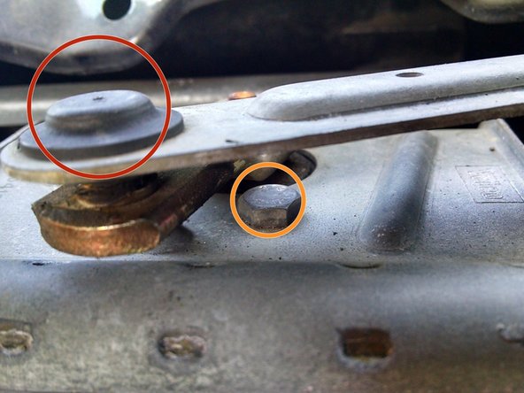

  8. 2006-2008 Isuzu i-Series Wiper Motor Replacement, Accessing the Assembly: crwdns2935265:08crwdnd2935265:01crwdnd2935265:02crwdne2935265:0 2006-2008 Isuzu i-Series Wiper Motor Replacement, Accessing the Assembly: crwdns2935265:08crwdnd2935265:02crwdnd2935265:02crwdne2935265:0
    • Remove the connecting arm socket with a 1/2 inch wrench or socket (red circle).
    • Remove the three motor bolts with a 10mm wrench or socket (orange circles).
    • The wiper motor is now able to be replaced.
