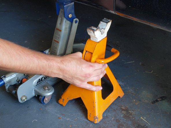

    • Place a jack stand immediately behind the jack on the pinch weld.
    • Slowly lower the car onto the jack stand and remove the jack.
    • Many hydraulic jacks are lowered by placing the open end of the handle over a knob and turning it counterclockwise. Consult the owner's manual for your jack if you don't know how to lower it.
    • Never work underneath a car that is only supported by a jack. The jack may slip or fail, resulting in serious injury or death.

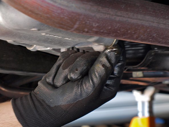

    • Locate the 17 mm hex oil drain plug at the back of the oil pan, facing the rear of the car.
    • Honda made everyone's life a little easier, and stamped the words "Engine Oil" on the oil pan with an arrow pointing to the drain plug.

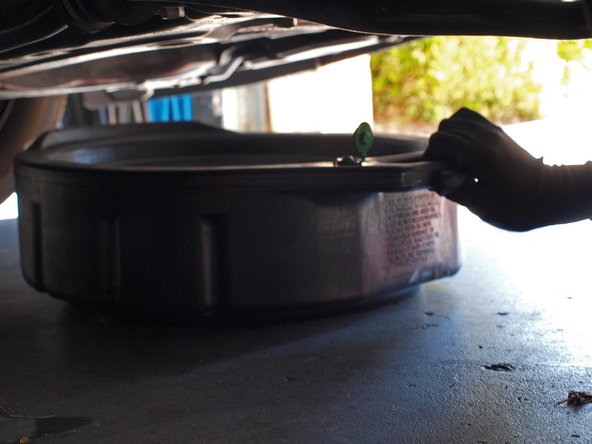

    • Position an oil drain pan under the oil pan so that it will collect the draining oil.

    • Use a 17 mm box end wrench to loosen the drain plug 3/4 of a turn.
    • Loosen the drain plug by hand until it comes free and oil begins to drain out of the oil pan.
    • Watch the draining oil for shiny specks. Metal flakes in the oil are a part of normal engine wear—but, an excessive amount of metal flakes could indicate a serious problem. Consider saving your oil and sending a sample to a lab for analysis.

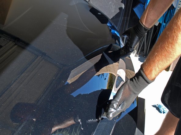

    • To pop the hood, pull on the hood release lever inside the driver side door.
    • Locate the hood release latch under the hood. Use one hand to press up on the latch while lifting the hood.
    • Prop the hood up by inserting the hood prop rod into the hole labeled with an arrow.

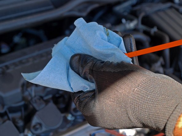

    • Remove the orange dipstick from under your hood.
    • Wipe the dipstick down with a rag or towel to ensure that you get a true reading.
    • Reinsert the dipstick all the way into its hole, then remove it.
    • The amount of oil on your dipstick determines the oil level. The top of the crosshatched area is the maximum amount of oil you should have, while the bottom of the crosshatching is the minimum.
    • Our oil level appears to be a little high. However, oil has not yet had time to seep into the nooks and crannies of the engine. Start the engine and let it idle for a minute. Turn the engine off and look underneath for leaks. Check the oil again. Now the filter is full of oil, the level should be close to the full mark on the dipstick.

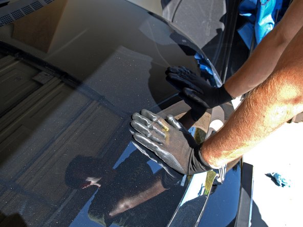

    • Lift the hood enough to allow you to lower the hood prop rod back down into its resting location.
    • Gently lower the hood until it clicks into the secondary latch.
    • Press firmly on the edge of the hood until you hear the primary latch engage.
