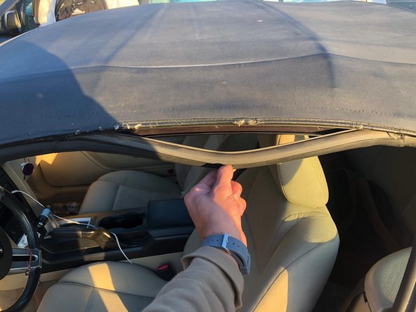

    • Pull down the weather stripping from the middle.
  4. 2006 (convertible) Ford Mustang Weatherproofing Car Window Replacement: crwdns2935265:04crwdnd2935265:01crwdnd2935265:02crwdne2935265:0 2006 (convertible) Ford Mustang Weatherproofing Car Window Replacement: crwdns2935265:04crwdnd2935265:02crwdnd2935265:02crwdne2935265:0

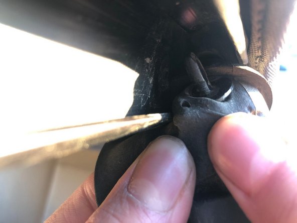

    • In each side of the weather stripping, you will find one plastic nail.
    • Take off these two plastic nails with your hand.

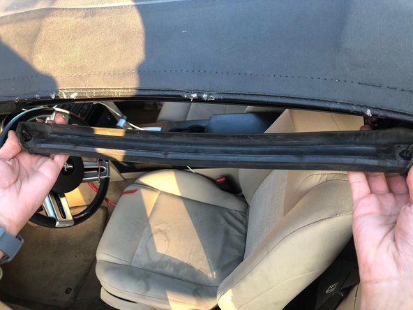

  5. 2006 (convertible) Ford Mustang Weatherproofing Car Window Replacement: crwdns2935265:05crwdnd2935265:01crwdnd2935265:02crwdne2935265:0 2006 (convertible) Ford Mustang Weatherproofing Car Window Replacement: crwdns2935265:05crwdnd2935265:02crwdnd2935265:02crwdne2935265:0
    • Remove the old weather stripping.

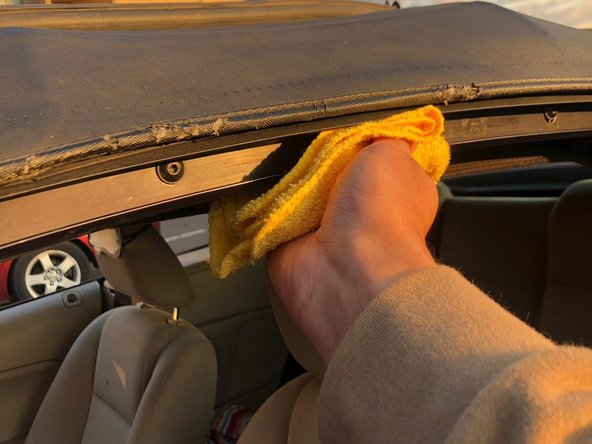

  6. 2006 (convertible) Ford Mustang Weatherproofing Car Window Replacement: crwdns2935265:06crwdnd2935265:01crwdnd2935265:02crwdne2935265:0 2006 (convertible) Ford Mustang Weatherproofing Car Window Replacement: crwdns2935265:06crwdnd2935265:02crwdnd2935265:02crwdne2935265:0
    • Clean any dust from where you took out the old weather stripping.
