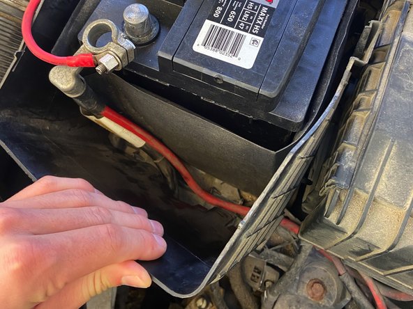

    • Pull the black lever to the left of the brake pedal and then lift the latch on the very front end of the hood to open the engine bay.
    • Locate your car battery.
    • In this model, the battery will be underneath this cover in the upper right corner of the engine bay.

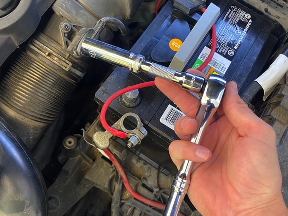

  2. 2005 Volkswagen Jetta Battery Replacement: crwdns2935265:02crwdnd2935265:01crwdnd2935265:01crwdne2935265:0
    • Using a socket wrench, loosen the 10mm nut on the positive (red) side of the battery.
    • You will be able to pull the cable off of the terminal when the nut is loose enough.

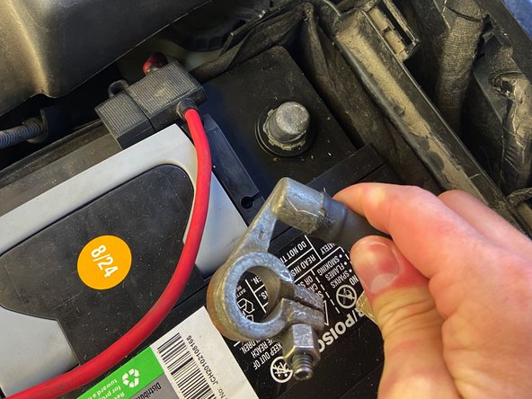

  3. 2005 Volkswagen Jetta Battery Replacement: crwdns2935265:03crwdnd2935265:01crwdnd2935265:01crwdne2935265:0
    • Pull up on the positive (red) battery cable from the terminal to remove it.
    • Let the cable rest on the side.

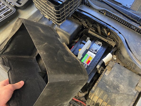

    • Remove the hard outer casing around the battery and set it aside.
    • If you're having trouble removing the outer casing, focus on releasing the clips along both sides and the bottom front side.

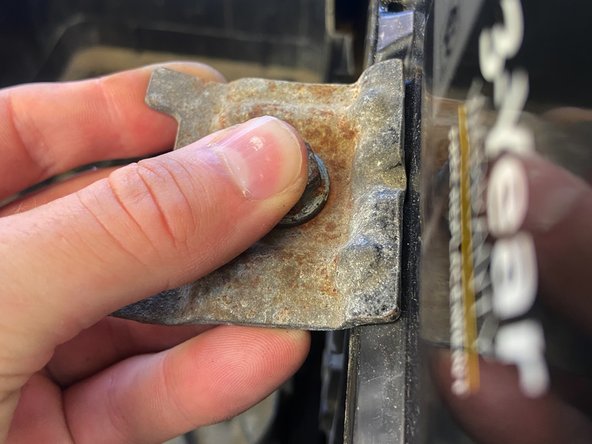

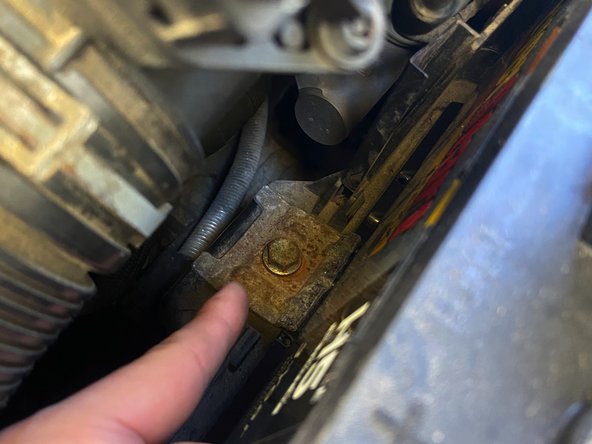

    • Locate the lower stability bracket on the lower left side.
    • It looks like a nut and is nestled on the left side of the battery.
  8. 2005 Volkswagen Jetta Battery Replacement: crwdns2935265:08crwdnd2935265:01crwdnd2935265:02crwdne2935265:0 2005 Volkswagen Jetta Battery Replacement: crwdns2935265:08crwdnd2935265:02crwdnd2935265:02crwdne2935265:0
    • Use a 13mm socket to remove the stability bracket.
    • For this removal, using a long socket and socket extender is helpful.

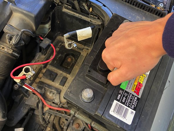

    • Lift the handle on the battery and pull to remove it.
  10. 2005 Volkswagen Jetta Battery Replacement: crwdns2935265:010crwdnd2935265:01crwdnd2935265:02crwdne2935265:0 2005 Volkswagen Jetta Battery Replacement: crwdns2935265:010crwdnd2935265:02crwdnd2935265:02crwdne2935265:0
    • When replacing the battery, make sure your stability bracket aligns with a groove on the bottom lip of your new battery.
    • The stability bracket will only fit into one of the grooves, so don't worry about choosing the wrong groove.
To reassemble your device, follow these instructions in reverse order. Your battery cables will go in between the soft inner casing and hard outer cover.
