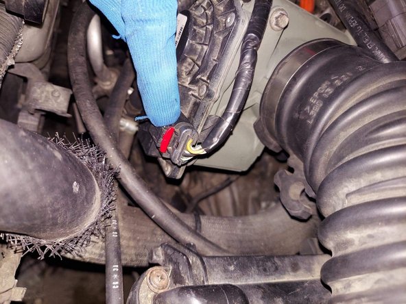

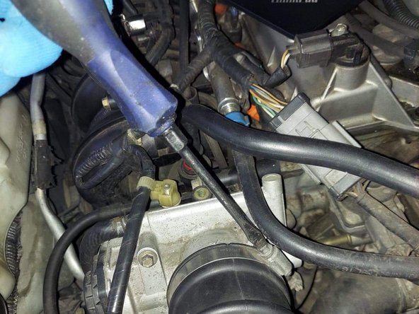

    • Open the hood and prop it open.
    • Locate the electronic throttle body.
  2. 2005 Mazda 6 Electronic Throttle Body Replacement: crwdns2935265:02crwdnd2935265:01crwdnd2935265:03crwdne2935265:0 2005 Mazda 6 Electronic Throttle Body Replacement: crwdns2935265:02crwdnd2935265:02crwdnd2935265:03crwdne2935265:0 2005 Mazda 6 Electronic Throttle Body Replacement: crwdns2935265:02crwdnd2935265:03crwdnd2935265:03crwdne2935265:0

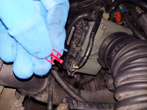

    • Detach the electric connection from the electronic throttle body.
    • Unplug the safety pin.
  3. 2005 Mazda 6 Electronic Throttle Body Replacement: crwdns2935265:03crwdnd2935265:01crwdnd2935265:02crwdne2935265:0 2005 Mazda 6 Electronic Throttle Body Replacement: crwdns2935265:03crwdnd2935265:02crwdnd2935265:02crwdne2935265:0

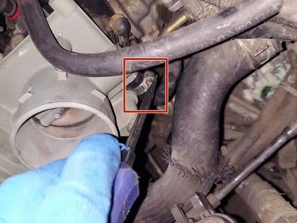

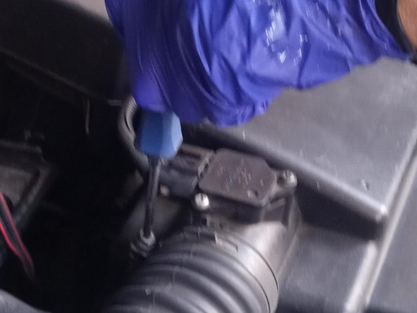

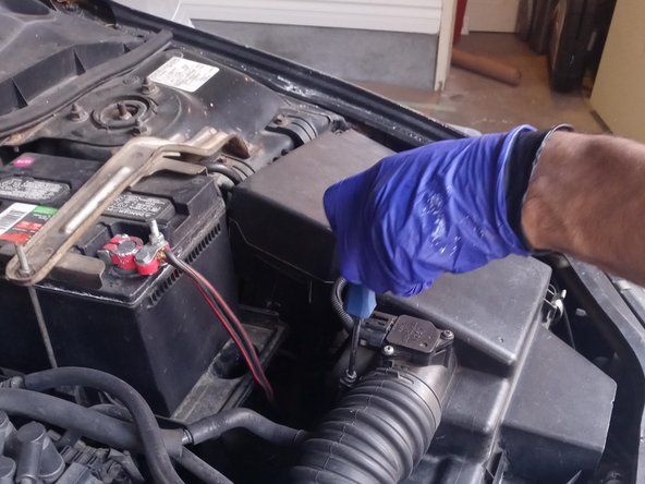

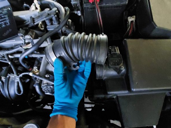

    • Unscrew the clamp that connects the intake hose to the air filter housing.
  4. 2005 Mazda 6 Electronic Throttle Body Replacement: crwdns2935265:04crwdnd2935265:01crwdnd2935265:02crwdne2935265:0 2005 Mazda 6 Electronic Throttle Body Replacement: crwdns2935265:04crwdnd2935265:02crwdnd2935265:02crwdne2935265:0

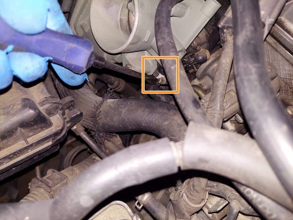

    • Unscrew the clamp that secures the intake hose with the electronic throttle body.
  5. 2005 Mazda 6 Electronic Throttle Body Replacement: crwdns2935265:05crwdnd2935265:01crwdnd2935265:03crwdne2935265:0 2005 Mazda 6 Electronic Throttle Body Replacement: crwdns2935265:05crwdnd2935265:02crwdnd2935265:03crwdne2935265:0 2005 Mazda 6 Electronic Throttle Body Replacement: crwdns2935265:05crwdnd2935265:03crwdnd2935265:03crwdne2935265:0

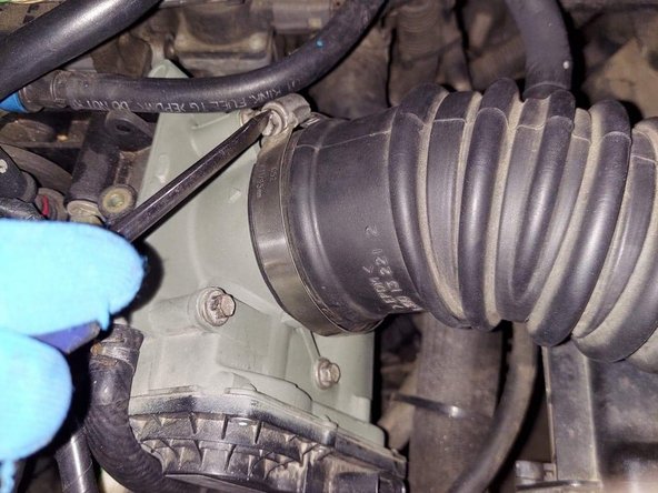

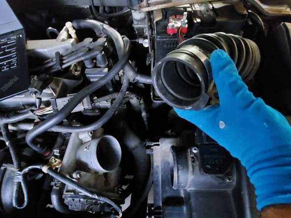

    • Disconnect the intake hose from both sides.

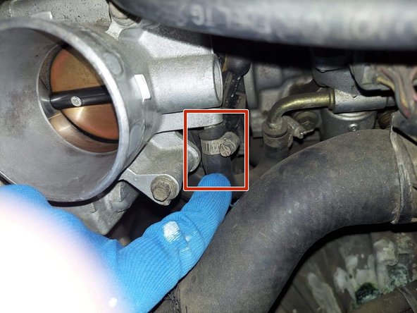

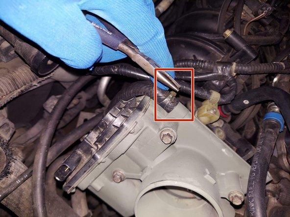

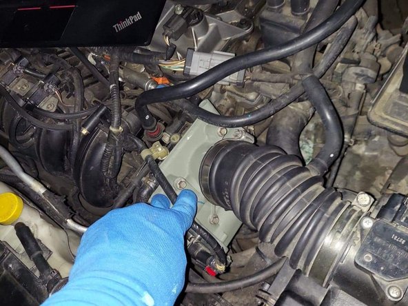

    • Disconnect the upper and lower vacuum hose on the electronic throttle body using a pair of pliers.

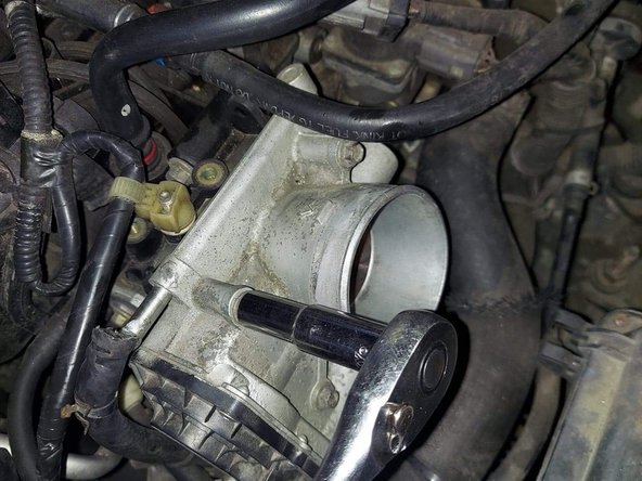

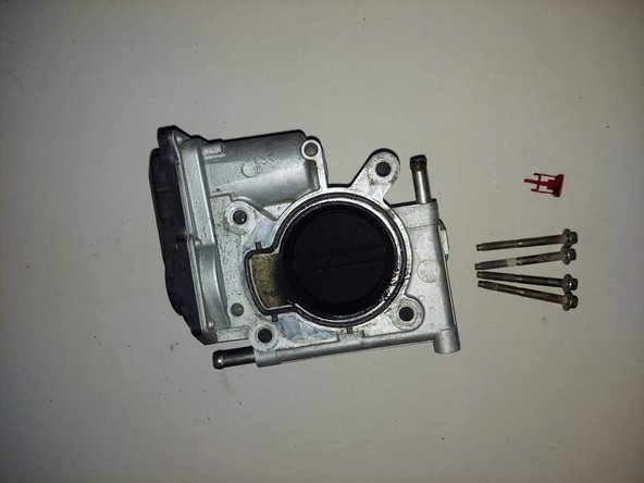

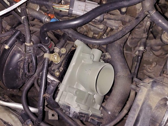

    • Remove the four screws connecting the electronic throttle body to the intake manifold.
  8. 2005 Mazda 6 Electronic Throttle Body Replacement: crwdns2935265:08crwdnd2935265:01crwdnd2935265:02crwdne2935265:0 2005 Mazda 6 Electronic Throttle Body Replacement: crwdns2935265:08crwdnd2935265:02crwdnd2935265:02crwdne2935265:0
    • Place the new electronic throttle body on the intake manifold.
  9. 2005 Mazda 6 Electronic Throttle Body Replacement: crwdns2935265:09crwdnd2935265:01crwdnd2935265:02crwdne2935265:0 2005 Mazda 6 Electronic Throttle Body Replacement: crwdns2935265:09crwdnd2935265:02crwdnd2935265:02crwdne2935265:0
    • Reattach the four screws securing the electronic throttle body with the intake manifold.
