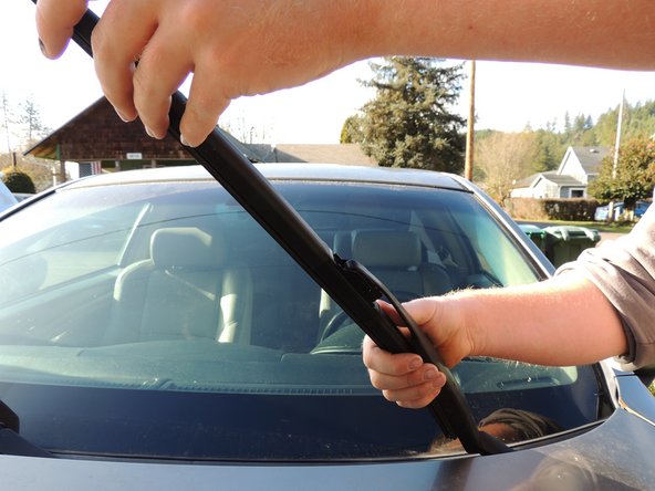

    • Lift up on the drivers side windshield wiper.
    • The wiper blade should stay in its upright position while you work.

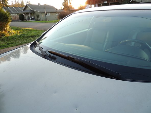

  2. 2005 Infiniti G35 Windshield Wiper Replacement: crwdns2935265:02crwdnd2935265:01crwdnd2935265:02crwdne2935265:0 2005 Infiniti G35 Windshield Wiper Replacement: crwdns2935265:02crwdnd2935265:02crwdnd2935265:02crwdne2935265:0
    • Rotate the wiper blade 180 degrees so that it is parallel with the windshield.

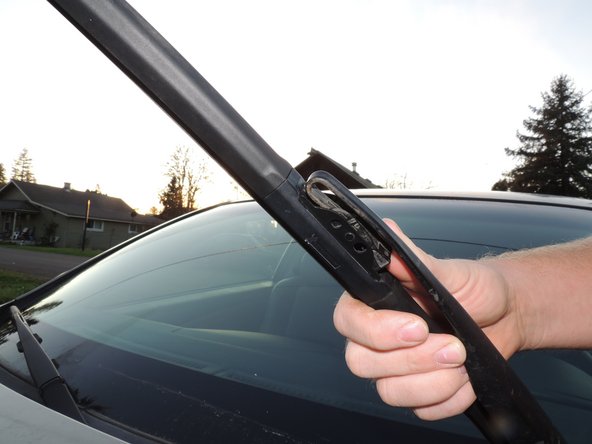

  3. 2005 Infiniti G35 Windshield Wiper Replacement: crwdns2935265:03crwdnd2935265:01crwdnd2935265:02crwdne2935265:0 2005 Infiniti G35 Windshield Wiper Replacement: crwdns2935265:03crwdnd2935265:02crwdnd2935265:02crwdne2935265:0
    • Push down on the middle of the wiper blade until you hear/feel a click.

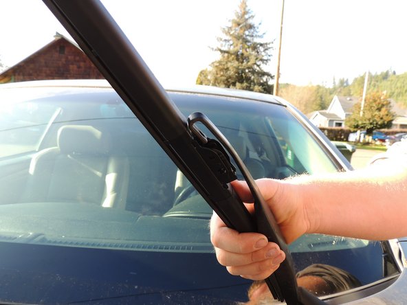

  4. 2005 Infiniti G35 Windshield Wiper Replacement: crwdns2935265:04crwdnd2935265:01crwdnd2935265:03crwdne2935265:0 2005 Infiniti G35 Windshield Wiper Replacement: crwdns2935265:04crwdnd2935265:02crwdnd2935265:03crwdne2935265:0 2005 Infiniti G35 Windshield Wiper Replacement: crwdns2935265:04crwdnd2935265:03crwdnd2935265:03crwdne2935265:0
    • Rotate the wiper blade back to its original position.
    • Pull down on the blade until it detaches from the wiper arm.

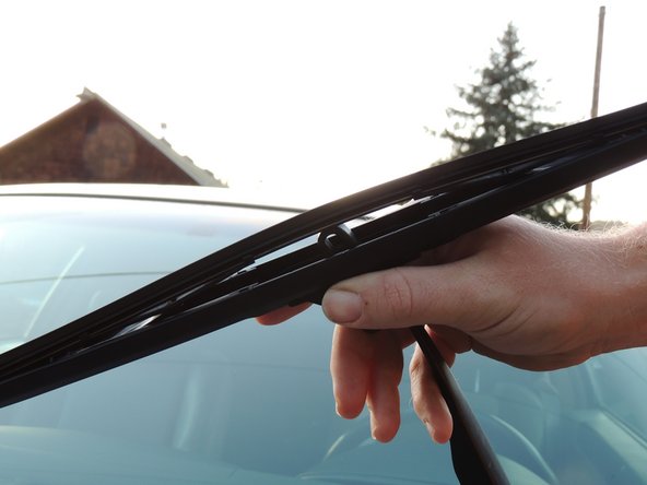

  5. 2005 Infiniti G35 Windshield Wiper Replacement: crwdns2935265:05crwdnd2935265:01crwdnd2935265:03crwdne2935265:0 2005 Infiniti G35 Windshield Wiper Replacement: crwdns2935265:05crwdnd2935265:02crwdnd2935265:03crwdne2935265:0 2005 Infiniti G35 Windshield Wiper Replacement: crwdns2935265:05crwdnd2935265:03crwdnd2935265:03crwdne2935265:0
    • Slide the new wiper blade onto the wiper arm in the same position that you removed the old blade.
    • Slide with moderate pressure until you hear a click.

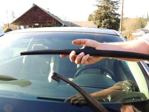

  6. 2005 Infiniti G35 Windshield Wiper Replacement: crwdns2935265:06crwdnd2935265:01crwdnd2935265:02crwdne2935265:0 2005 Infiniti G35 Windshield Wiper Replacement: crwdns2935265:06crwdnd2935265:02crwdnd2935265:02crwdne2935265:0
    • Hold the wiper blade against the arm to gently lay the arm down without damaging the new wiper blade.
  7. 2005 Infiniti G35 Windshield Wiper Replacement: crwdns2935265:07crwdnd2935265:01crwdnd2935265:01crwdne2935265:0
    • Repeat steps 1-6 for the passenger side windshield wiper.
