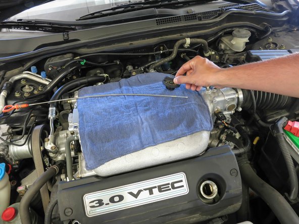

  5. 2005 Honda Accord Engine Oil Replacement, Engine Oil: crwdns2935265:05crwdnd2935265:01crwdnd2935265:02crwdne2935265:0 2005 Honda Accord Engine Oil Replacement, Engine Oil: crwdns2935265:05crwdnd2935265:02crwdnd2935265:02crwdne2935265:0
    • Pull out the dipstick
    • Unscrew the cap from the oil tank
    • Set both aside. lay a towel over the engine block and set dipstick and the cap on that to avoid traces of oil.
