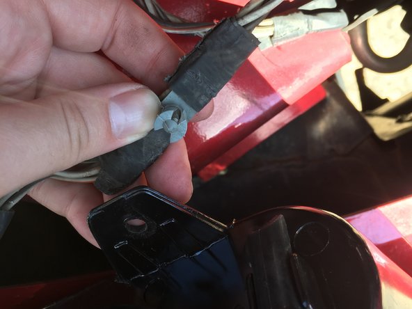

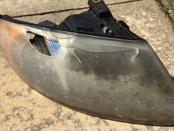

  3. 2005 Dodge Grand Caravan Passenger Side Headlight Replacement, Remove damaged headlight: crwdns2935265:03crwdnd2935265:01crwdnd2935265:03crwdne2935265:0 2005 Dodge Grand Caravan Passenger Side Headlight Replacement, Remove damaged headlight: crwdns2935265:03crwdnd2935265:02crwdnd2935265:03crwdne2935265:0 2005 Dodge Grand Caravan Passenger Side Headlight Replacement, Remove damaged headlight: crwdns2935265:03crwdnd2935265:03crwdnd2935265:03crwdne2935265:0
    • Push down on the gray insert that is holding the cables close to the headlight.
    • Be careful with the cable to not bend or damage it.
    • Now put the damaged headlight aside to properly dispose of.
