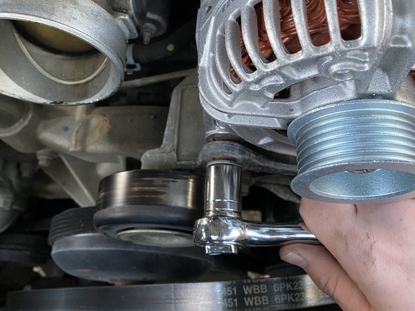

  4. 2005 Chevrolet Tahoe Alternator Replacement: crwdns2935265:04crwdnd2935265:01crwdnd2935265:03crwdne2935265:0 2005 Chevrolet Tahoe Alternator Replacement: crwdns2935265:04crwdnd2935265:02crwdnd2935265:03crwdne2935265:0 2005 Chevrolet Tahoe Alternator Replacement: crwdns2935265:04crwdnd2935265:03crwdnd2935265:03crwdne2935265:0

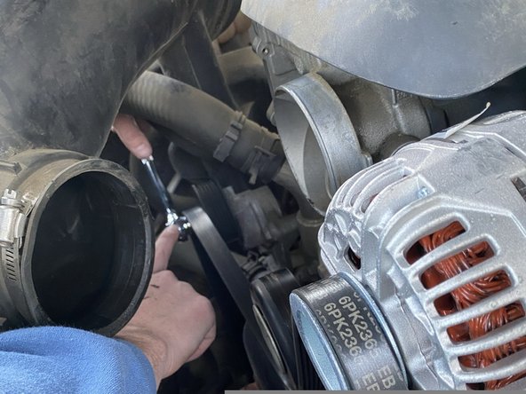

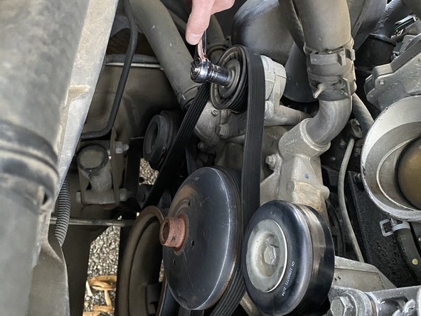

    • Use a 15 mm socket on the tensioner to remove the belt.

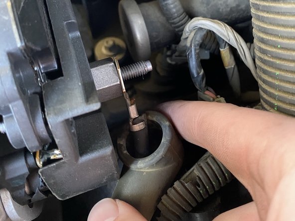

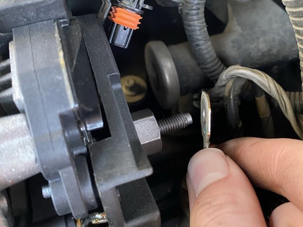

    • Remove the connector on the back of the alternator by pinching and pulling back.

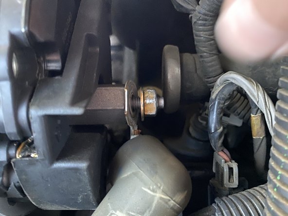

  6. 2005 Chevrolet Tahoe Alternator Replacement: crwdns2935265:06crwdnd2935265:01crwdnd2935265:03crwdne2935265:0 2005 Chevrolet Tahoe Alternator Replacement: crwdns2935265:06crwdnd2935265:02crwdnd2935265:03crwdne2935265:0 2005 Chevrolet Tahoe Alternator Replacement: crwdns2935265:06crwdnd2935265:03crwdnd2935265:03crwdne2935265:0

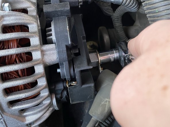

    • Remove the rubber covering on the nut and bolt assembly on the back of the alternator.
    • Remove the nut with a 10 mm socket.

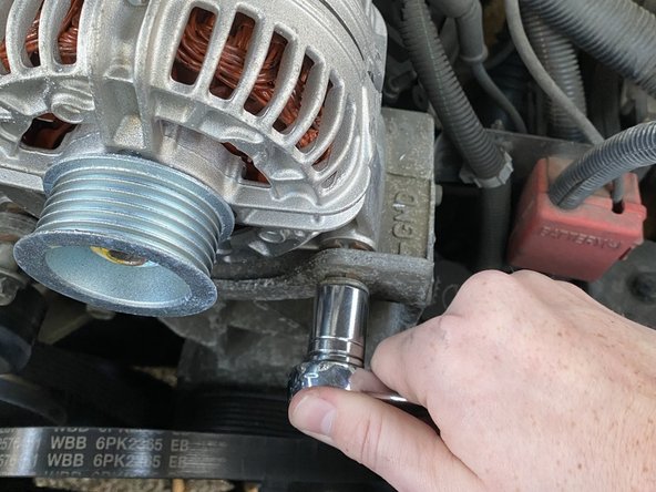

  7. 2005 Chevrolet Tahoe Alternator Replacement: crwdns2935265:07crwdnd2935265:01crwdnd2935265:03crwdne2935265:0 2005 Chevrolet Tahoe Alternator Replacement: crwdns2935265:07crwdnd2935265:02crwdnd2935265:03crwdne2935265:0 2005 Chevrolet Tahoe Alternator Replacement: crwdns2935265:07crwdnd2935265:03crwdnd2935265:03crwdne2935265:0

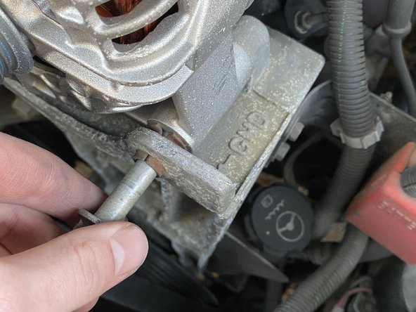

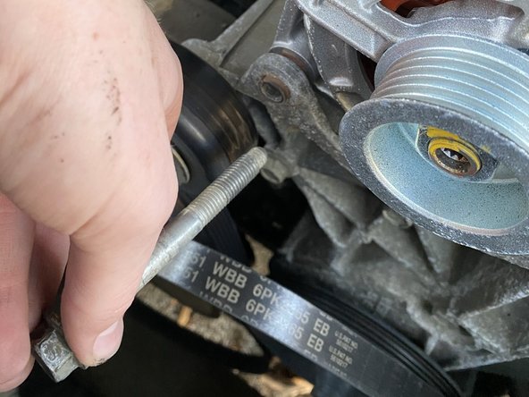

    • Remove the two bolts on the front of the alternator with a 15 mm socket.

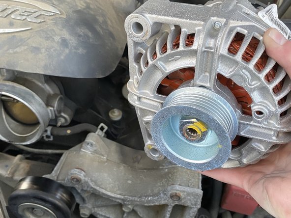

  8. 2005 Chevrolet Tahoe Alternator Replacement: crwdns2935265:08crwdnd2935265:01crwdnd2935265:03crwdne2935265:0 2005 Chevrolet Tahoe Alternator Replacement: crwdns2935265:08crwdnd2935265:02crwdnd2935265:03crwdne2935265:0 2005 Chevrolet Tahoe Alternator Replacement: crwdns2935265:08crwdnd2935265:03crwdnd2935265:03crwdne2935265:0
    • Once the two bolts in the front are removed, the alternator is ready to come out.
    • The alternator might need a little persuasion to come off the bracket, so use a hammer or a pry bar to aid you in this step.
    • When using a hammer, make sure that you are not coming into contact with anything on the backswing. The last thing you want to do is damage an entirely different part under your hood.

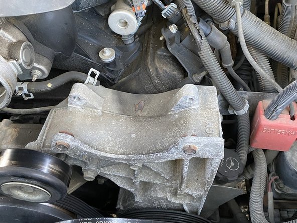

  9. 2005 Chevrolet Tahoe Alternator Replacement: crwdns2935265:09crwdnd2935265:01crwdnd2935265:02crwdne2935265:0 2005 Chevrolet Tahoe Alternator Replacement: crwdns2935265:09crwdnd2935265:02crwdnd2935265:02crwdne2935265:0
    • Now you are ready to install your new alternator.
    • To accomplish this you will need a hammer to tap your alternator into place.
    • The objective here is to line up the bolt holes on the bracket with those on your new alternator.

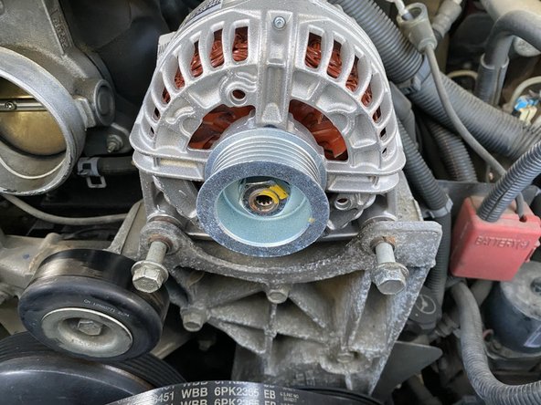

  10. 2005 Chevrolet Tahoe Alternator Replacement: crwdns2935265:010crwdnd2935265:01crwdnd2935265:03crwdne2935265:0 2005 Chevrolet Tahoe Alternator Replacement: crwdns2935265:010crwdnd2935265:02crwdnd2935265:03crwdne2935265:0 2005 Chevrolet Tahoe Alternator Replacement: crwdns2935265:010crwdnd2935265:03crwdnd2935265:03crwdne2935265:0
    • Once your new alternator is in place, feed the two bolts back through their corresponding holes on the front of the bracket.
    • Tighten the bolts down with a 15 mm socket.

  12. 2005 Chevrolet Tahoe Alternator Replacement: crwdns2935265:012crwdnd2935265:01crwdnd2935265:03crwdne2935265:0 2005 Chevrolet Tahoe Alternator Replacement: crwdns2935265:012crwdnd2935265:02crwdnd2935265:03crwdne2935265:0 2005 Chevrolet Tahoe Alternator Replacement: crwdns2935265:012crwdnd2935265:03crwdnd2935265:03crwdne2935265:0
    • Place the wiring connector back onto the bolt on the backside of the alternator.
    • Put the nut on and tighten it down using a 10 mm socket.
  13. 2005 Chevrolet Tahoe Alternator Replacement: crwdns2935265:013crwdnd2935265:01crwdnd2935265:01crwdne2935265:0
    • Place the rubber cover back over the nut.
  14. 2005 Chevrolet Tahoe Alternator Replacement: crwdns2935265:014crwdnd2935265:01crwdnd2935265:03crwdne2935265:0 2005 Chevrolet Tahoe Alternator Replacement: crwdns2935265:014crwdnd2935265:02crwdnd2935265:03crwdne2935265:0 2005 Chevrolet Tahoe Alternator Replacement: crwdns2935265:014crwdnd2935265:03crwdnd2935265:03crwdne2935265:0

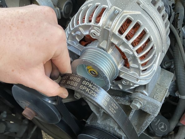

    • Realign the belt into its proper position.
    • Place the belt in between your 15 mm socket and the tensioner.
    • Turn the tensioner to the right to relieve the tension and place the belt back on.
    • Once you have done this, release the pressure you are applying to the tensioner and make sure that the belt is properly aligned.
    • Use caution when placing the belt back on. Do not release the tensioner until you have aligned the belt or you could pinch your finger.
