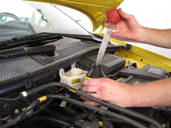

  7. 2005-2007 Ford Focus Front Brake Pad Replacement: crwdns2935265:07crwdnd2935265:01crwdnd2935265:01crwdne2935265:0
    • Use a turkey baster to remove 2-3 ounces of brake fluid from the reservoir.
    • Never let the fluid level drop below the minimum mark. This will let air into your lines, which will require bleeding to remove.
    • Properly dispose of old brake fluid. Do not reuse it.

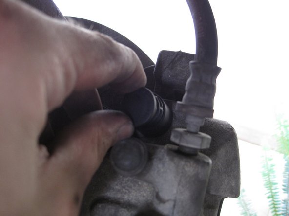

  9. 2005-2007 Ford Focus Front Brake Pad Replacement: crwdns2935265:09crwdnd2935265:01crwdnd2935265:01crwdne2935265:0
    • Use a flat head screwdriver to remove the black plastic guide bolt dust caps.
  10. 2005-2007 Ford Focus Front Brake Pad Replacement: crwdns2935265:010crwdnd2935265:01crwdnd2935265:01crwdne2935265:0
    • Use a 7 mm Allen wrench to remove the two caliper guide bolts.
    • On the driver's side, turn towards the rear of the car. On the passenger side, turn towards the front

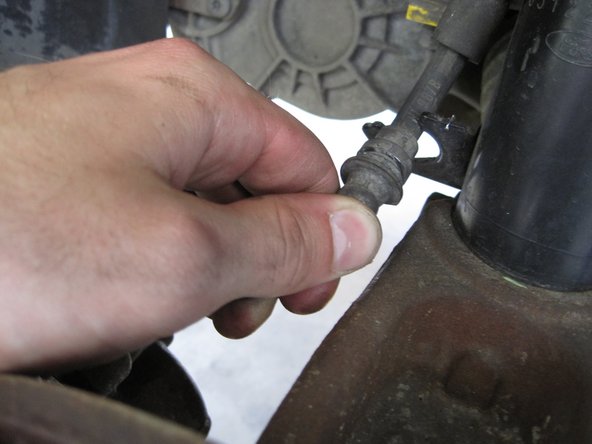

    • Remove the clip that holds the brake line to the strut with a pair of vise grips.
    • Pull the brake line towards you and out of the bracket.

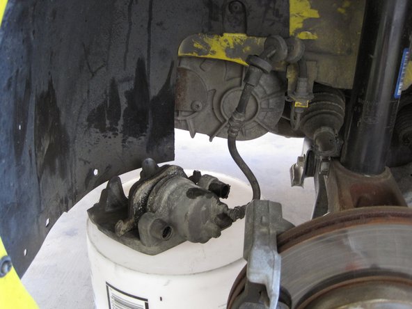

  12. 2005-2007 Ford Focus Front Brake Pad Replacement: crwdns2935265:012crwdnd2935265:01crwdnd2935265:02crwdne2935265:0 2005-2007 Ford Focus Front Brake Pad Replacement: crwdns2935265:012crwdnd2935265:02crwdnd2935265:02crwdne2935265:0
    • Pull the caliper off of the rotor.
    • Place the caliper on top of a box or bucket so the brake line doesn't stretch or kink.

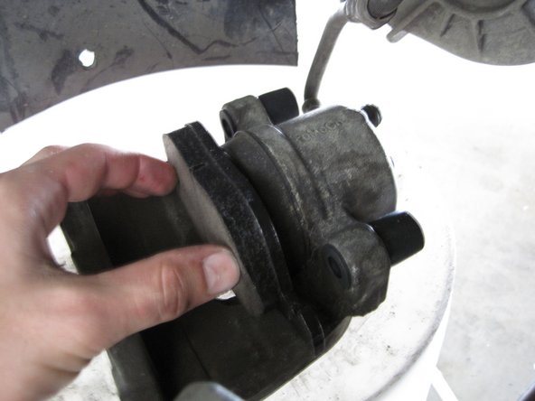

    • Pull the outer brake pad from the mounting bracket.

    • Remove the inner brake pad from the caliper.
    • The pad is held in place by three metal clips. It may take some force and wiggling to free the pad.

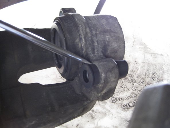

  15. 2005-2007 Ford Focus Front Brake Pad Replacement: crwdns2935265:015crwdnd2935265:01crwdnd2935265:02crwdne2935265:0 2005-2007 Ford Focus Front Brake Pad Replacement: crwdns2935265:015crwdnd2935265:02crwdnd2935265:02crwdne2935265:0
    • This step is only necessary if you are replacing the guide bolt bushings.
    • Use a flat head screwdriver to push the bushing through its hole in the caliper.
    • Remove the bushing from the caliper.

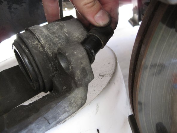

  19. 2005-2007 Ford Focus Front Brake Pad Replacement: crwdns2935265:019crwdnd2935265:01crwdnd2935265:02crwdne2935265:0 2005-2007 Ford Focus Front Brake Pad Replacement: crwdns2935265:019crwdnd2935265:02crwdnd2935265:02crwdne2935265:0
    • This step is only necessary if the guide bolt bushings were removed.
    • Insert the new bushing from the inside of the caliper.
    • Use a flat head screwdriver to help feed the bushing through its hole.

When removing the guide pins they seem very hard to remove with an Allen/Hex key .. any tips?
khalz - crwdns2934203:0crwdne2934203:0
Excellent guide --- many thanks ! Also applicable with virtually no modifications to my 2012 Ford Ikon, except that on my car the guide pins needed a size 45 Torx bit to unscrew. I had to replace the rotors as well, and discovered Ford had used threadlocking compound on the mounting bolts for the bracket, making them the devil to remove without pneumatic wrench. Threadlocking compound should be outlawed !!
