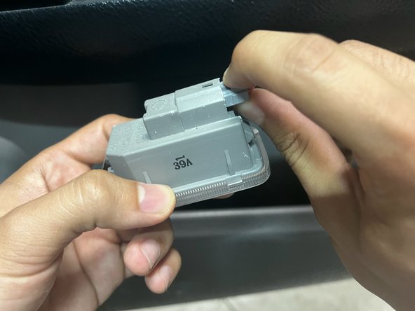

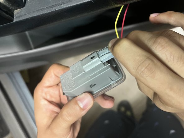

    • Remove the light using an upholstery remover.
    • Disconnect the lights by applying pressure on the clip and pulling outwards.

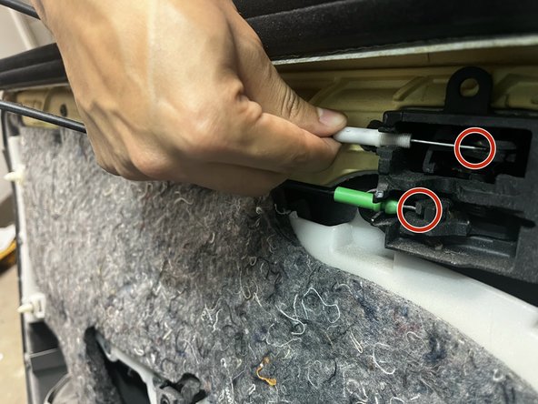

  4. 2004 Toyota 4Runner Passenger Side Window Replacement: crwdns2935265:04crwdnd2935265:01crwdnd2935265:03crwdne2935265:0 2004 Toyota 4Runner Passenger Side Window Replacement: crwdns2935265:04crwdnd2935265:02crwdnd2935265:03crwdne2935265:0 2004 Toyota 4Runner Passenger Side Window Replacement: crwdns2935265:04crwdnd2935265:03crwdnd2935265:03crwdne2935265:0

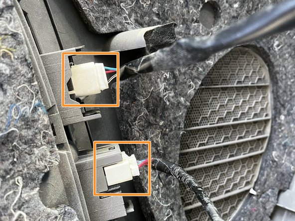

    • Lift the door panel carefully off of the door.
    • Use caution as there are still wires attached to it.
    • Disconnect the green and white wires by pulling outward with your fingers.
    • Disconnect the wires by applying pressure to the sides of the white clip and pulling with your fingers.

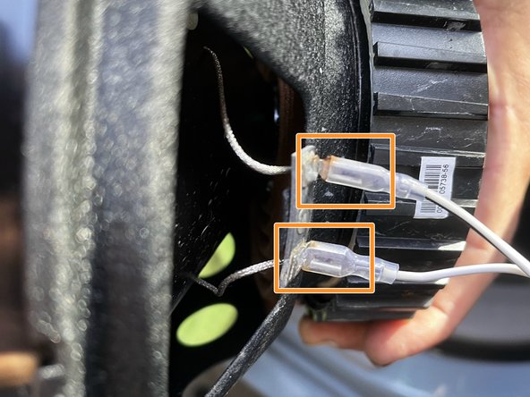

    • Remove the four screws using a Phillips #0 screwdriver.
    • Disconnect the speaker by pulling out the white wires.

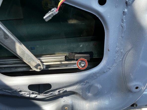

    • Remove the two bolts using the drive ratchet.
    • The steps are the same for replacing a faulty glass and installing a new glass because the last one shattered. If the previous glass shattered just make sure to clean up all the glass shards in the door with a vaccum.

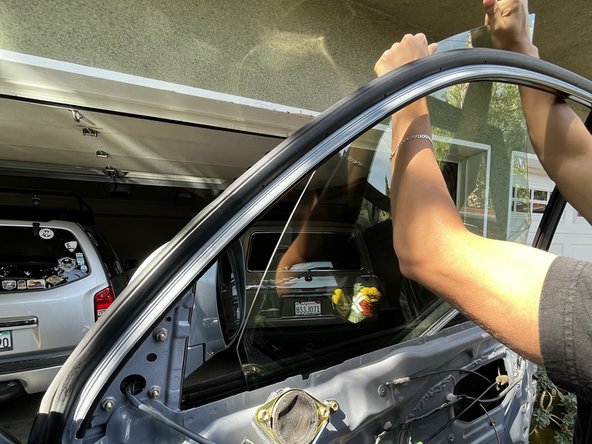

    • Remove the glass carefully by lifting it up with both hands.
  8. 2004 Toyota 4Runner Passenger Side Window Replacement: crwdns2935265:08crwdnd2935265:01crwdnd2935265:01crwdne2935265:0
    • When installing the new glass, make sure it aligns perfectly in the black molding shown in the picture.
