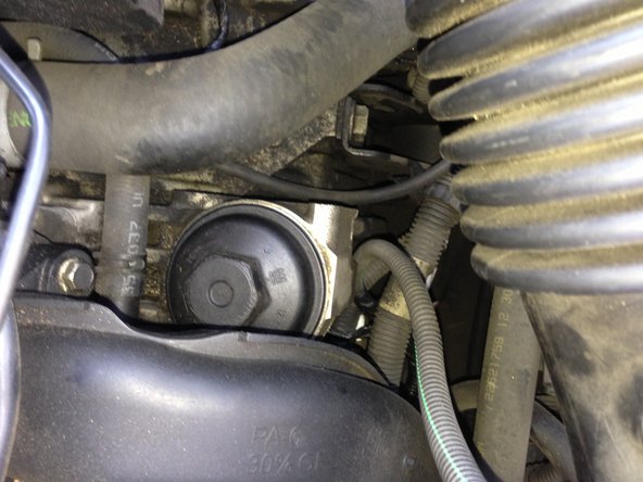

  3. 2004 Pontiac Grand AM Oil Change: crwdns2935265:03crwdnd2935265:01crwdnd2935265:02crwdne2935265:0 2004 Pontiac Grand AM Oil Change: crwdns2935265:03crwdnd2935265:02crwdnd2935265:02crwdne2935265:0
    • Locate the oil filter (as shown in picture) and place oil drip pan underneath.
    • Using oil filter wrench, loosen oil filter. Remove rest of the way by hand. Be careful as filter is full of oil.
    • Allow oil to drip into pan for 5-10 minutes.
    • Lightly coat rubber seal on new filter with fresh oil.
    • Screw on new filter until hand tight.
