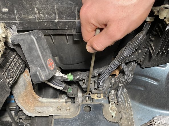

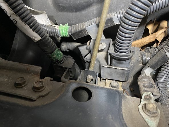

  3. 2004 Lexus 330 RX Battery Replacement: crwdns2935265:03crwdnd2935265:01crwdnd2935265:03crwdne2935265:0 2004 Lexus 330 RX Battery Replacement: crwdns2935265:03crwdnd2935265:02crwdnd2935265:03crwdne2935265:0 2004 Lexus 330 RX Battery Replacement: crwdns2935265:03crwdnd2935265:03crwdnd2935265:03crwdne2935265:0
    • Remove the metal rod on top of the battery.
    • The second and third pictures were taken without the battery for a better view of the rod.

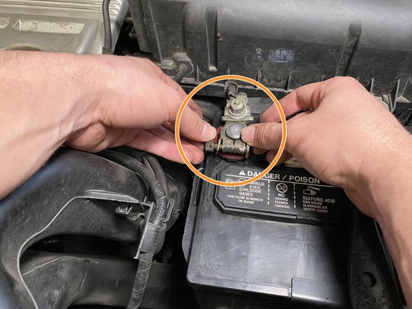

  4. 2004 Lexus 330 RX Battery Replacement: crwdns2935265:04crwdnd2935265:01crwdnd2935265:03crwdne2935265:0 2004 Lexus 330 RX Battery Replacement: crwdns2935265:04crwdnd2935265:02crwdnd2935265:03crwdne2935265:0 2004 Lexus 330 RX Battery Replacement: crwdns2935265:04crwdnd2935265:03crwdnd2935265:03crwdne2935265:0
    • Remove the bolts on the clamps with a 10 mm socket.
    • Repeat the process on the second terminal of the battery.
  5. 2004 Lexus 330 RX Battery Replacement: crwdns2935265:05crwdnd2935265:01crwdnd2935265:03crwdne2935265:0 2004 Lexus 330 RX Battery Replacement: crwdns2935265:05crwdnd2935265:02crwdnd2935265:03crwdne2935265:0 2004 Lexus 330 RX Battery Replacement: crwdns2935265:05crwdnd2935265:03crwdnd2935265:03crwdne2935265:0
    • Carefully remove the clamps from the terminal.
    • Sometimes clamps are stuck in place due to corrosion or battery leak. Use caution while removing it.
