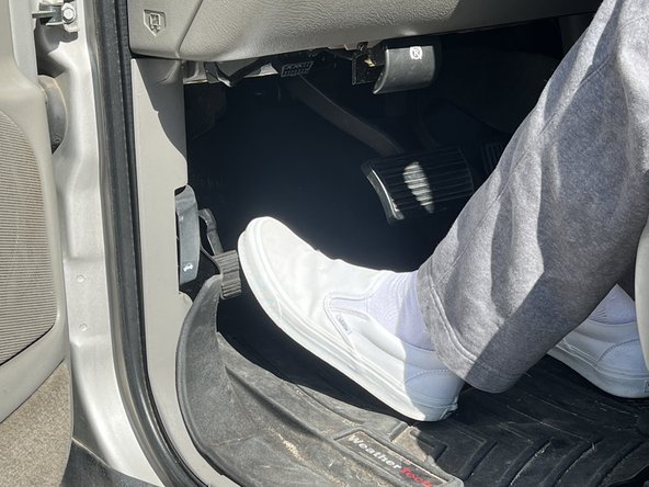

    • Park the vehicle on a flat surface and set the parking brake by fully depressing the parking brake lever with your foot.
    • You can verify the parking brake is properly set by checking that the parking brake indication light is lit up on the instrument cluster.

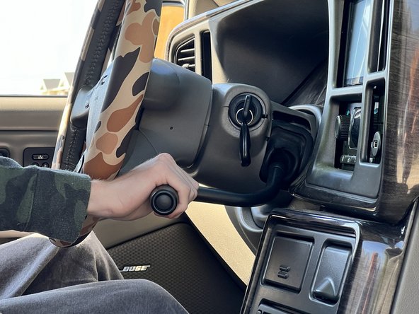

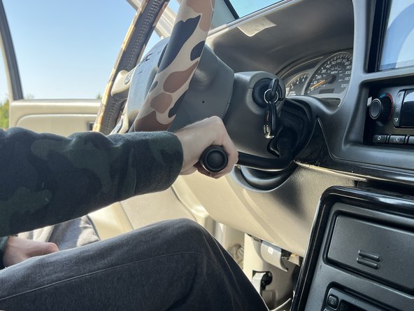

  3. 2004 GMC Yukon Instrument Cluster Replacement: crwdns2935265:03crwdnd2935265:01crwdnd2935265:02crwdne2935265:0 2004 GMC Yukon Instrument Cluster Replacement: crwdns2935265:03crwdnd2935265:02crwdnd2935265:02crwdne2935265:0

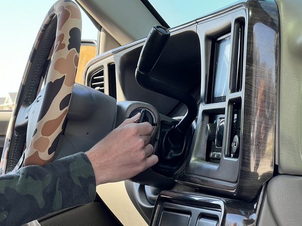

    • Pull the gear selector down to the lowest gear (1st gear).
    • Before shifting to the lowest gear, double-check to verify your parking brake is properly set. This step requires shifting the transmission out of park so the vehicle may roll slightly if it is on an uneven surface.

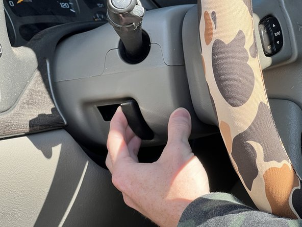

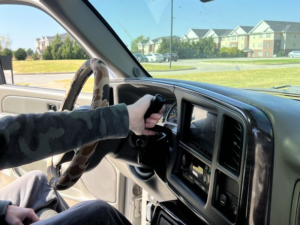

  4. 2004 GMC Yukon Instrument Cluster Replacement: crwdns2935265:04crwdnd2935265:01crwdnd2935265:02crwdne2935265:0 2004 GMC Yukon Instrument Cluster Replacement: crwdns2935265:04crwdnd2935265:02crwdnd2935265:02crwdne2935265:0
    • Pull the tilt adjustment lever on the side of the steering wheel towards you to adjust the steering wheel height to the lowest position.

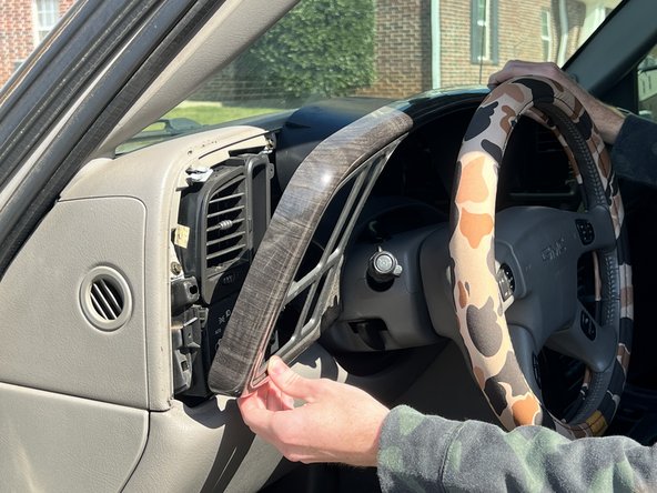

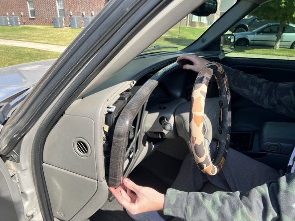

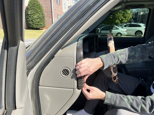

  5. 2004 GMC Yukon Instrument Cluster Replacement: crwdns2935265:05crwdnd2935265:01crwdnd2935265:02crwdne2935265:0 2004 GMC Yukon Instrument Cluster Replacement: crwdns2935265:05crwdnd2935265:02crwdnd2935265:02crwdne2935265:0

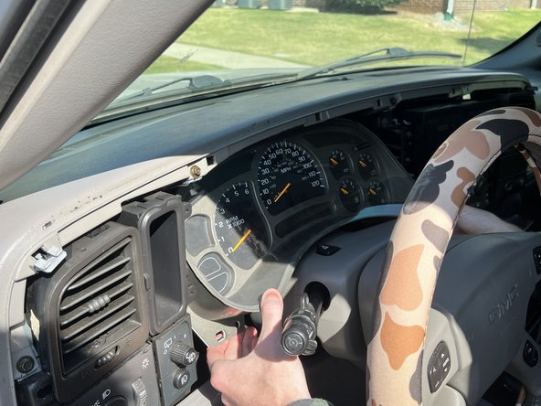

    • Carefully use the flathead screwdriver to gently pry between the trim panel and the dash, disconnecting the plastic tabs that secure the panel in place.
    • Once the trim panel is disconnected from the dash, remove the trim panel and store it in a safe place.
    • Be careful with this step as using a flathead screwdriver could potentially lead to injuries if used incorrectly.
    • The plastic tabs attaching the trim panel to the dash are very fragile and may easily break if you apply too much force.

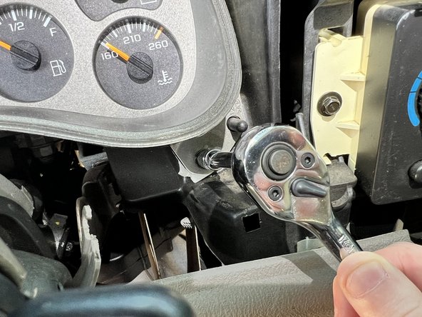

    • Locate the four 7mm screws near the corners of the instrument cluster.
    • Turn the 7mm socket wrench counterclockwise to remove each screw.
    • Crank the socket wrench before attempting to loosen the screws as this is a tight space which makes it hard to get a full range of motion.

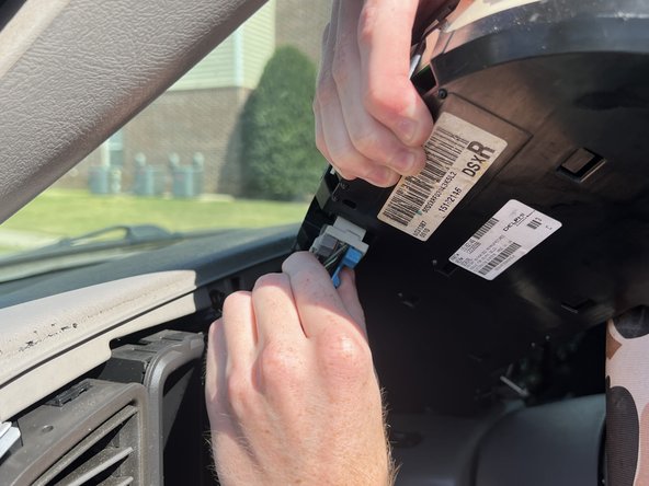

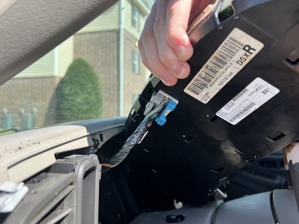

  7. 2004 GMC Yukon Instrument Cluster Replacement: crwdns2935265:07crwdnd2935265:01crwdnd2935265:03crwdne2935265:0 2004 GMC Yukon Instrument Cluster Replacement: crwdns2935265:07crwdnd2935265:02crwdnd2935265:03crwdne2935265:0 2004 GMC Yukon Instrument Cluster Replacement: crwdns2935265:07crwdnd2935265:03crwdnd2935265:03crwdne2935265:0

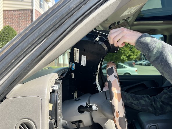

    • Grab the instrument cluster and pull it away from the dash.

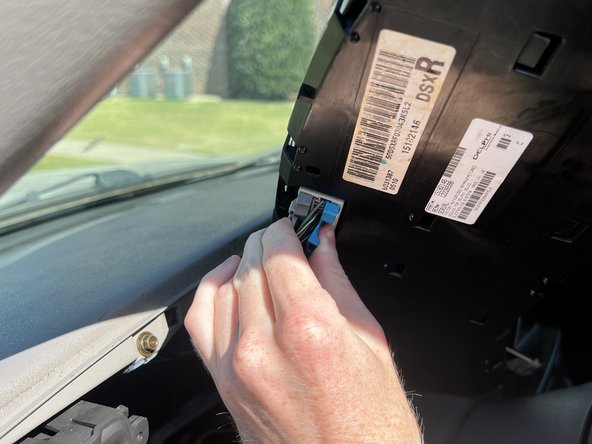

    • To disconnect the instrument cluster wiring harness, squeeze the grey and blue plastic tabs on the back of the instrument cluster together and gently pull the connector free.
    • Use caution when removing the instrument cluster from the dash—pulling too hard or too far can damage or disconnect the wires attached to the back.
    • You may need to wiggle the connector back and forth to loosen the wiring harness from the instrument cluster.

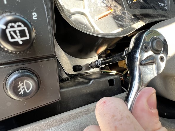

    • Grab the four 7mm screws that were removed in Step 6.
    • Use the 7mm socket wrench to tighten the screws into the four screw-holes located at each corner of the instrument cluster.
    • Turn the socket wrench clockwise to tighten the screws.

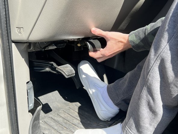

  12. 2004 GMC Yukon Instrument Cluster Replacement: crwdns2935265:012crwdnd2935265:01crwdnd2935265:02crwdne2935265:0 2004 GMC Yukon Instrument Cluster Replacement: crwdns2935265:012crwdnd2935265:02crwdnd2935265:02crwdne2935265:0
    • Carefully release the parking brake using the handle at the very bottom of your dash.
    • Drive safely.
    • The car may roll if it is on an uneven surface so make sure to keep your foot on the brake as you release the parking brake.
