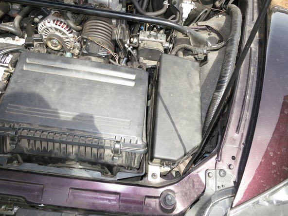

    • Locate the fuse box holder near the driver's side headlight.
    • Remove the cover by lifting the black tabs on the sides.

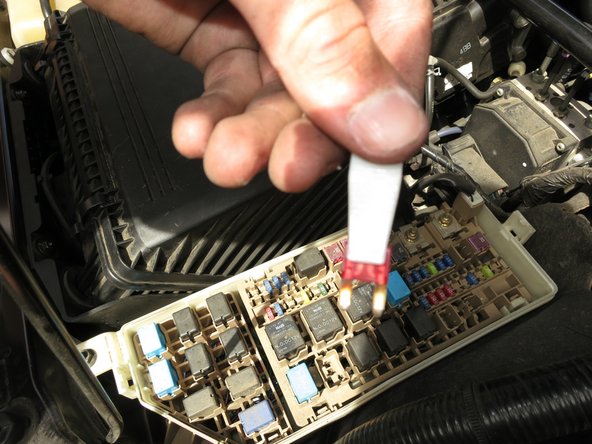

  3. 2004-2008 Mazda RX-8 Fuse Replacement: crwdns2935265:03crwdnd2935265:01crwdnd2935265:03crwdne2935265:0 2004-2008 Mazda RX-8 Fuse Replacement: crwdns2935265:03crwdnd2935265:02crwdnd2935265:03crwdne2935265:0 2004-2008 Mazda RX-8 Fuse Replacement: crwdns2935265:03crwdnd2935265:03crwdnd2935265:03crwdne2935265:0
    • Use the tool that is inside the fuse box to remove the necessary fuse.
    • Use the fuse guide on the inside of the fuse cover, along with the nature of the electrical problem to help quickly find the faulty fuse
