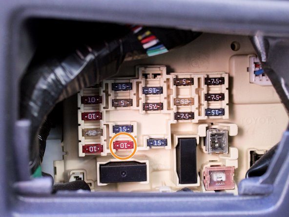

  2. 2003 Toyota Solara Tail Light Replacement: crwdns2935265:02crwdnd2935265:01crwdnd2935265:03crwdne2935265:0 2003 Toyota Solara Tail Light Replacement: crwdns2935265:02crwdnd2935265:02crwdnd2935265:03crwdne2935265:0 2003 Toyota Solara Tail Light Replacement: crwdns2935265:02crwdnd2935265:03crwdnd2935265:03crwdne2935265:0
    • Reach underneath the steering wheel. Then, place your hand to the left to remove the fuse box cover.
  3. 2003 Toyota Solara Tail Light Replacement: crwdns2935265:03crwdnd2935265:01crwdnd2935265:02crwdne2935265:0 2003 Toyota Solara Tail Light Replacement: crwdns2935265:03crwdnd2935265:02crwdnd2935265:02crwdne2935265:0
    • Reference the fuse box guide on the back of the cover.
    • Locate the fuse number that corresponds to the tail light (2nd column, last row).
    • Replace the tail lamp if the fuse is still functional.

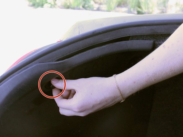

  4. 2003 Toyota Solara Tail Light Replacement: crwdns2935265:04crwdnd2935265:01crwdnd2935265:02crwdne2935265:0 2003 Toyota Solara Tail Light Replacement: crwdns2935265:04crwdnd2935265:02crwdnd2935265:02crwdne2935265:0
    • Open the vehicle's trunk.
    • Unscrew the plastic fastenings located inside the trunk.
    • Detach the panel covering the tail light.

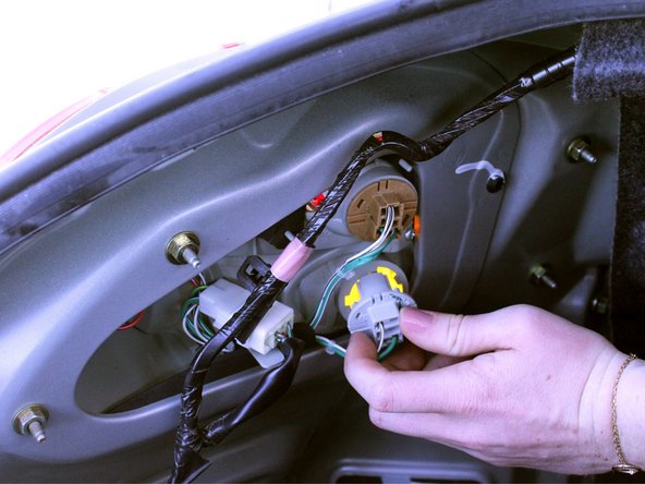

  5. 2003 Toyota Solara Tail Light Replacement: crwdns2935265:05crwdnd2935265:01crwdnd2935265:03crwdne2935265:0 2003 Toyota Solara Tail Light Replacement: crwdns2935265:05crwdnd2935265:02crwdnd2935265:03crwdne2935265:0 2003 Toyota Solara Tail Light Replacement: crwdns2935265:05crwdnd2935265:03crwdnd2935265:03crwdne2935265:0
    • Untwist the wired socket to expose the lamp bulb.
    • Check the bulb for discoloration (if it is clouded, replace the bulb).

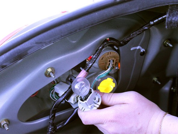

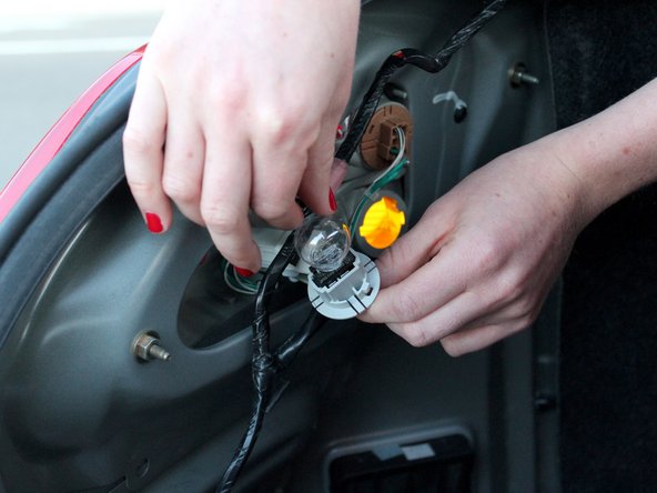

  6. 2003 Toyota Solara Tail Light Replacement: crwdns2935265:06crwdnd2935265:01crwdnd2935265:02crwdne2935265:0 2003 Toyota Solara Tail Light Replacement: crwdns2935265:06crwdnd2935265:02crwdnd2935265:02crwdne2935265:0
    • Insert the new bulb into the socket.
    • Push until there is an audible "click".
To reassemble the tail lamp, follow these instructions in reverse order.
