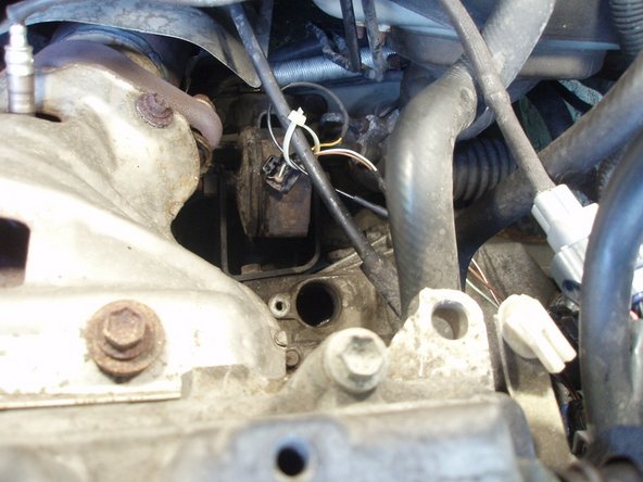

  1. 2003 Toyota Matrix transmission speed sensor Replacement, location of sensor: crwdns2935265:01crwdnd2935265:01crwdnd2935265:02crwdne2935265:0 2003 Toyota Matrix transmission speed sensor Replacement, location of sensor: crwdns2935265:01crwdnd2935265:02crwdnd2935265:02crwdne2935265:0
    • Transaxle is behind and below engine. You will have a hard time seeing it if your height is less than 170 cm. If you are two metres tall or taller, then it will be easy to see.
    • Some guides instruct to remove air filter, though I find that needless and not beneficial.
  2. 2003 Toyota Matrix transmission speed sensor Replacement, unplug sensor: crwdns2935265:02crwdnd2935265:01crwdnd2935265:02crwdne2935265:0 2003 Toyota Matrix transmission speed sensor Replacement, unplug sensor: crwdns2935265:02crwdnd2935265:02crwdnd2935265:02crwdne2935265:0
    • Disconnect sensor now, or disconnect it later. You might find it easier to unplug sensor after removing it from transaxle, when it is less far away from you, then easier to reach.
    • Press on ridged tab to release clip/latch. Grip connector, not wires, and pull it off of sensor.

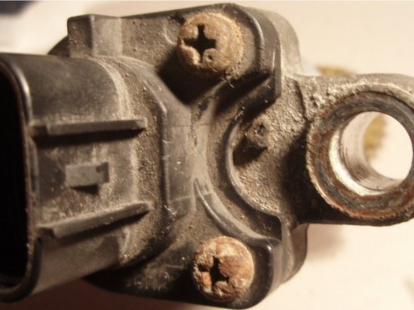

  3. 2003 Toyota Matrix transmission speed sensor Replacement, remove sensor: crwdns2935265:03crwdnd2935265:01crwdnd2935265:03crwdne2935265:0 2003 Toyota Matrix transmission speed sensor Replacement, remove sensor: crwdns2935265:03crwdnd2935265:02crwdnd2935265:03crwdne2935265:0 2003 Toyota Matrix transmission speed sensor Replacement, remove sensor: crwdns2935265:03crwdnd2935265:03crwdnd2935265:03crwdne2935265:0
    • Transaxle speed sensor is fastened down with one screw, 12mm hexagon head. Use a socket on a long shaft to reach. Just sixteen inches is long enough, also one half yard or half metre works.
    • Observe the dimple in original screws which hold sensor together: these are JIS size 1 cruciform drive. This observation is only meant to be interesting or informative, not relevant to guide.

Wire assignments in piece pictured: yellow is +12 volt, brown is 0 volt, green+white wire is output signal.
