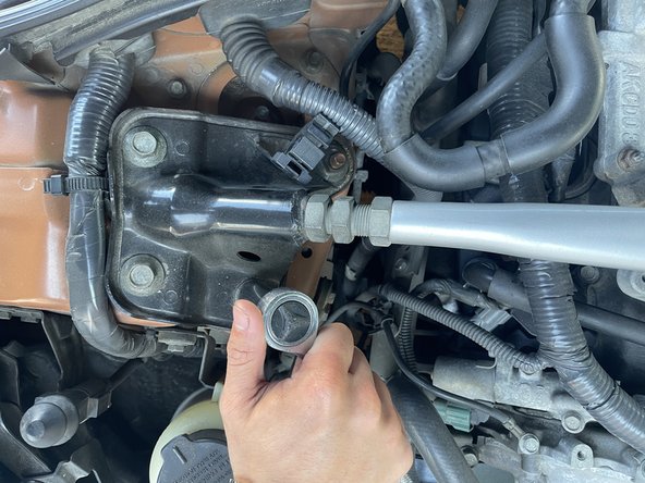

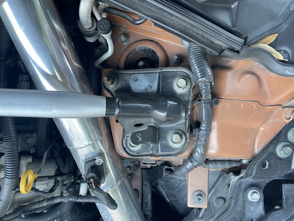

  4. 2003 Nissan 350z Spark Plug and Coil Pack Replacement: crwdns2935265:04crwdnd2935265:01crwdnd2935265:03crwdne2935265:0 2003 Nissan 350z Spark Plug and Coil Pack Replacement: crwdns2935265:04crwdnd2935265:02crwdnd2935265:03crwdne2935265:0 2003 Nissan 350z Spark Plug and Coil Pack Replacement: crwdns2935265:04crwdnd2935265:03crwdnd2935265:03crwdne2935265:0
    • Use a ratcheting wrench and a 15 mm socket to remove the six 44.5 mm long bolts and two nuts on the strut tower brace.
