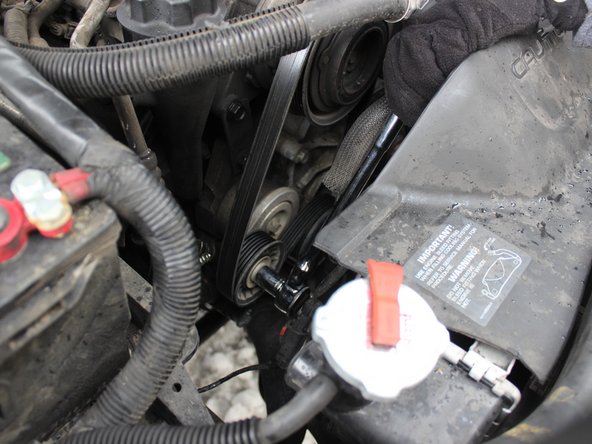

    • Take a look at the belt routing diagram under the hood. If you didn't find it you can find a picture on the internet or draw one before beginning.

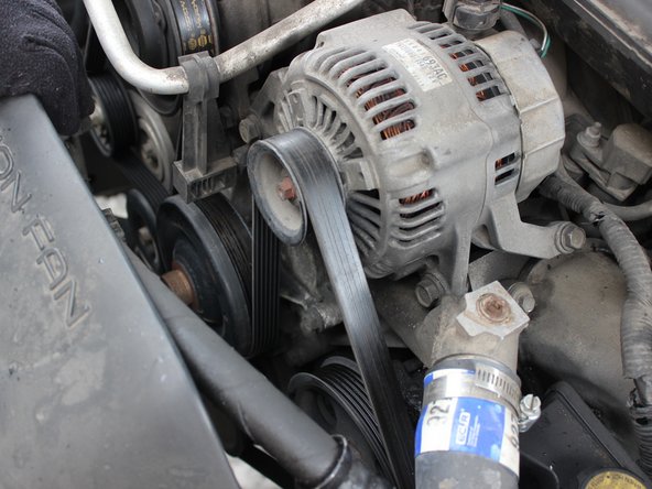

  2. 2003 Jeep Grand Cherokee Serpentine Belt  Replacement: crwdns2935265:02crwdnd2935265:01crwdnd2935265:03crwdne2935265:0 2003 Jeep Grand Cherokee Serpentine Belt  Replacement: crwdns2935265:02crwdnd2935265:02crwdnd2935265:03crwdne2935265:0 2003 Jeep Grand Cherokee Serpentine Belt  Replacement: crwdns2935265:02crwdnd2935265:03crwdnd2935265:03crwdne2935265:0
    • look carefully at how the old belt wraps around the pulleys, so you can replace the new one by practicing and matching the routing.
    • A/C Pulley
    • Tensioner
    • Idler Pulley
    • Crankshaft Pulley
    • Power Steering Pump Pulley
    • Generator Pulley
    • Water Pump Pulley

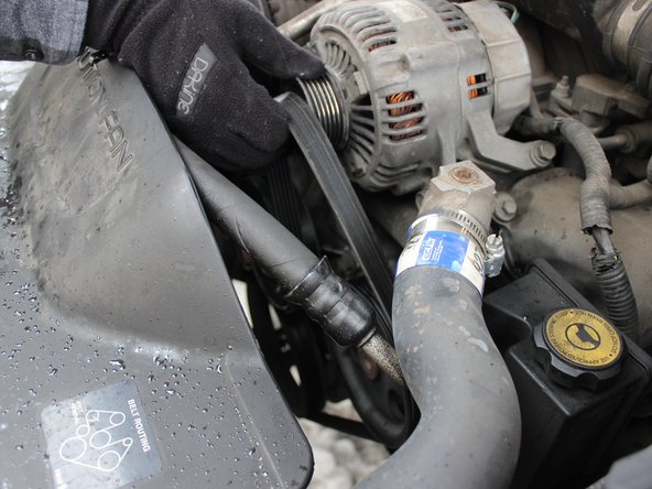

  3. 2003 Jeep Grand Cherokee Serpentine Belt  Replacement: crwdns2935265:03crwdnd2935265:01crwdnd2935265:03crwdne2935265:0 2003 Jeep Grand Cherokee Serpentine Belt  Replacement: crwdns2935265:03crwdnd2935265:02crwdnd2935265:03crwdne2935265:0 2003 Jeep Grand Cherokee Serpentine Belt  Replacement: crwdns2935265:03crwdnd2935265:03crwdnd2935265:03crwdne2935265:0
    • Now, use your 16 mm wrench to reduce the belt tension and get it off.
    • Put the socket wrench on the tensioner (Right your belt tensioner, the little square or cave).
    • Move the wrench clockwise to relieve tension from your belt tensioner.

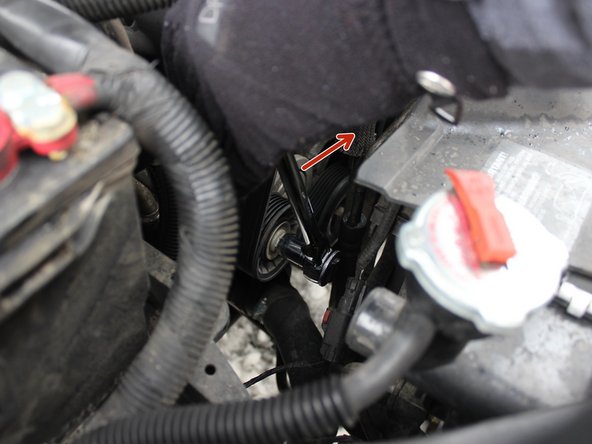

  4. 2003 Jeep Grand Cherokee Serpentine Belt  Replacement: crwdns2935265:04crwdnd2935265:01crwdnd2935265:03crwdne2935265:0 2003 Jeep Grand Cherokee Serpentine Belt  Replacement: crwdns2935265:04crwdnd2935265:02crwdnd2935265:03crwdne2935265:0 2003 Jeep Grand Cherokee Serpentine Belt  Replacement: crwdns2935265:04crwdnd2935265:03crwdnd2935265:03crwdne2935265:0
    • Remove the old belt and make sure to put the new belt that doesn't have any cracks and looks smooth.
    • Before installing the new belt check the tensioner pulley for wear by using your hand to spin it.

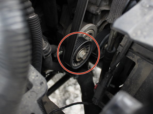

  5. 2003 Jeep Grand Cherokee Serpentine Belt  Replacement: crwdns2935265:05crwdnd2935265:01crwdnd2935265:03crwdne2935265:0 2003 Jeep Grand Cherokee Serpentine Belt  Replacement: crwdns2935265:05crwdnd2935265:02crwdnd2935265:03crwdne2935265:0 2003 Jeep Grand Cherokee Serpentine Belt  Replacement: crwdns2935265:05crwdnd2935265:03crwdnd2935265:03crwdne2935265:0
    • Install the new belt by lining up all belt ribs in the pulley grooves and wrap it around.
    • Start with the A/C Pulley and then wrap it around the tensioner and move on until you end up with the water pump pulley.
    • When you ready to put the belt back on the alternator, reduce the tension on the belt by using the socket wrench and then slip the belt right over the top.
