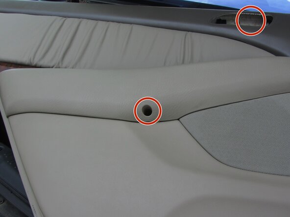

    • Use a Phillips #00 screwdriver to remove the screw covers and screws behind the door handle and on the center doorframe.
    • Set them aside for reassembly.
    • If you're working on reassembling specifically the front driver's side door, you may have to remove the handle by shifting it right, then detaching it by unplugging the memory board located on the back. Other passenger doors won't have this additional step.

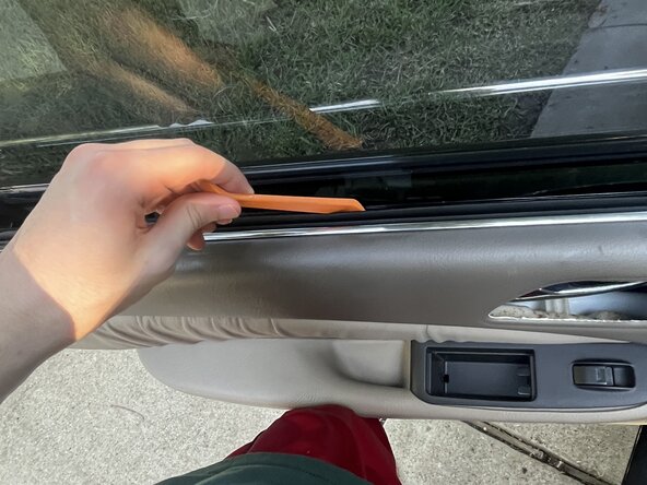

    • Using a trim removal tool, begin separating the door cover from the door. While separating, carefully undo the clips attaching the door to its frame.
    • The clips are very fragile. Ensure the clips don't get damaged during separation.
