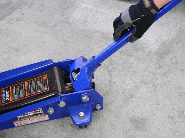

    • Grab your floor jack and make sure the pressure relief valve is closed. (Usually, you close the valve by twisting the jack lever clockwise.)
    • Don't use your vehicle's emergency jack for routine repairs. The emergency jack is for emergencies, such as when you need to change a flat tire. A hydraulic floor jack of the sort pictured here is sturdier, more durable, and better suited to general maintenance and repair.
    • If your jack leaks fluid or shows other signs of disrepair, stop working and repair or replace your jack before you proceed.

    • Pump the jack handle down and back up repeatedly to begin raising your vehicle.
    • It's best to watch the jack where it makes contact with the vehicle to make sure it stays seated properly as you raise it.
    • If this isn't practical, pause after raising the vehicle an inch or two and take a quick look to verify that the jack has made good contact with the jack point.
    • If necessary, lower the jack back down by slightly opening the release valve. Then close the release valve, and reposition the jack so that it makes better contact with the jack point.
    • Continue raising your vehicle until it reaches the desired height—high enough to allow you to put your jack stand(s) in place.

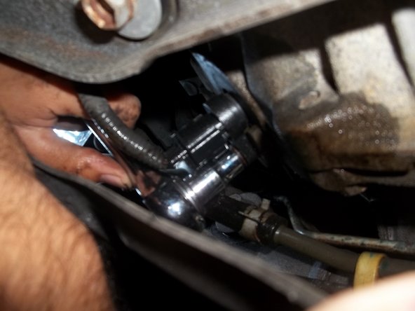

  12. 2003-2004 Infiniti G35 Sedan Crankshaft Position Sensor Replacement, Remove Bolt on Crankshaft Position Sensor: crwdns2935265:012crwdnd2935265:01crwdnd2935265:03crwdne2935265:0 2003-2004 Infiniti G35 Sedan Crankshaft Position Sensor Replacement, Remove Bolt on Crankshaft Position Sensor: crwdns2935265:012crwdnd2935265:02crwdnd2935265:03crwdne2935265:0 2003-2004 Infiniti G35 Sedan Crankshaft Position Sensor Replacement, Remove Bolt on Crankshaft Position Sensor: crwdns2935265:012crwdnd2935265:03crwdnd2935265:03crwdne2935265:0
    • Make sure the car has not been used in a couple hours. If it has been used recently its parts will still be hot.
    • Lay under the car and locate the crank shaft position sensor. The sensor is located between the engine and the transmission near the front driver's side wheel. It is directly behind the rack and pinion.
    • Use the 10mm wrench or socket wrench to loosen the 10mm Hex Head bolt attaching the crankshaft position sensor to the car. If the bolt is rusted use a penetrating lubricant to remove the rust.

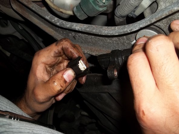

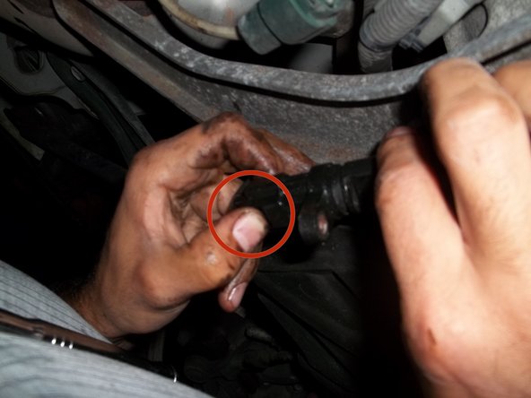

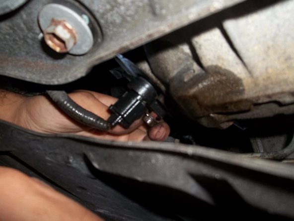

  13. 2003-2004 Infiniti G35 Sedan Crankshaft Position Sensor Replacement, Remove Crankshaft Position Sensor: crwdns2935265:013crwdnd2935265:01crwdnd2935265:03crwdne2935265:0 2003-2004 Infiniti G35 Sedan Crankshaft Position Sensor Replacement, Remove Crankshaft Position Sensor: crwdns2935265:013crwdnd2935265:02crwdnd2935265:03crwdne2935265:0 2003-2004 Infiniti G35 Sedan Crankshaft Position Sensor Replacement, Remove Crankshaft Position Sensor: crwdns2935265:013crwdnd2935265:03crwdnd2935265:03crwdne2935265:0
    • Note the correct position of the sensor so you will be able to insert the new sensor later on.
    • After you have removed the 10mm Hex Head bolt on the sensor, pull the sensor out of place with some force. (The sensor should pop right out)
    • Unplug the sensor from the wiring harness by squeezing the release clip and pulling firmly on the sensor.
