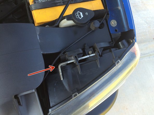

    • Turn your vehicle off, and let the engine bay cool before starting the following steps.
    • First, open the driver side door, and reach under the steering wheel and release the latch to open up the hood of your truck.
    • Next, walk over to either of the headlights and remove the pin above the headlight to release the housing unit.
    • Make sure to put the pin in a safe location so you can lock in the housing once you finish replacing the light bulbs.

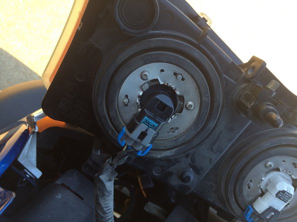

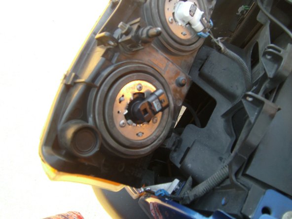

  2. 2003-2006 Chevrolet Silverado Headlight Bulb Replacement, Removing the old lights: crwdns2935265:02crwdnd2935265:01crwdnd2935265:03crwdne2935265:0 2003-2006 Chevrolet Silverado Headlight Bulb Replacement, Removing the old lights: crwdns2935265:02crwdnd2935265:02crwdnd2935265:03crwdne2935265:0 2003-2006 Chevrolet Silverado Headlight Bulb Replacement, Removing the old lights: crwdns2935265:02crwdnd2935265:03crwdnd2935265:03crwdne2935265:0
    • Pinch the blue clips and remove them from the back of the wiring harness.
    • After removing the pin, you should now be able to tilt the headlight downward to gain access to all of the wires.
    • Twist the light bulb counter clockwise and gently remove the harness and the light bulb.
  3. 2003-2006 Chevrolet Silverado Headlight Bulb Replacement, Inserting the new lightbulb: crwdns2935265:03crwdnd2935265:01crwdnd2935265:03crwdne2935265:0 2003-2006 Chevrolet Silverado Headlight Bulb Replacement, Inserting the new lightbulb: crwdns2935265:03crwdnd2935265:02crwdnd2935265:03crwdne2935265:0 2003-2006 Chevrolet Silverado Headlight Bulb Replacement, Inserting the new lightbulb: crwdns2935265:03crwdnd2935265:03crwdnd2935265:03crwdne2935265:0
    • Unbox your new low beam light, and insert it into the same hole you took the old one out of.
    • Be sure to twist the bulb clockwise until it locks into place with the harness pointing down.
    • Plug the blue wiring harness back in until you hear a click, and it should now be locked back into place.
