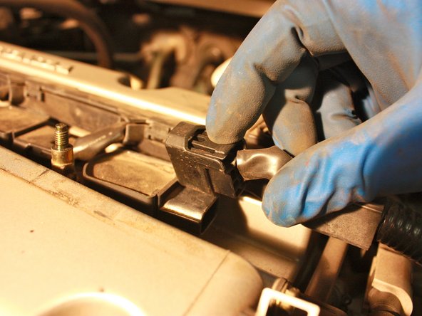

  5. 2003-2007 Honda Accord Spark Plugs Replacement: crwdns2935265:05crwdnd2935265:01crwdnd2935265:03crwdne2935265:0 2003-2007 Honda Accord Spark Plugs Replacement: crwdns2935265:05crwdnd2935265:02crwdnd2935265:03crwdne2935265:0 2003-2007 Honda Accord Spark Plugs Replacement: crwdns2935265:05crwdnd2935265:03crwdnd2935265:03crwdne2935265:0
    • Remove the spark plug wire by pinching the locking tabs on either side of it and pulling it out.

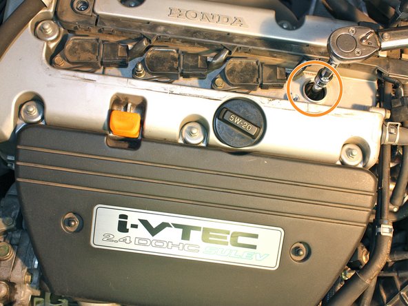

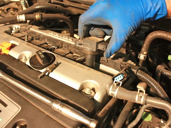

    • Use a 10 mm hex driver or socket to remove the four spark plug boot screws.
  7. 2003-2007 Honda Accord Spark Plugs Replacement: crwdns2935265:07crwdnd2935265:01crwdnd2935265:03crwdne2935265:0 2003-2007 Honda Accord Spark Plugs Replacement: crwdns2935265:07crwdnd2935265:02crwdnd2935265:03crwdne2935265:0 2003-2007 Honda Accord Spark Plugs Replacement: crwdns2935265:07crwdnd2935265:03crwdnd2935265:03crwdne2935265:0
    • Lift the boot screws out of the spark plug bores.
  8. 2003-2007 Honda Accord Spark Plugs Replacement: crwdns2935265:08crwdnd2935265:01crwdnd2935265:02crwdne2935265:0 2003-2007 Honda Accord Spark Plugs Replacement: crwdns2935265:08crwdnd2935265:02crwdnd2935265:02crwdne2935265:0
    • Locate the spark plug at the bottom of the bore.
    • Use a ratchet, extension, and 5/8 inch socket to remove the plug by turning counterclockwise until it's free.
  9. 2003-2007 Honda Accord Spark Plugs Replacement: crwdns2935265:09crwdnd2935265:01crwdnd2935265:03crwdne2935265:0 2003-2007 Honda Accord Spark Plugs Replacement: crwdns2935265:09crwdnd2935265:02crwdnd2935265:03crwdne2935265:0 2003-2007 Honda Accord Spark Plugs Replacement: crwdns2935265:09crwdnd2935265:03crwdnd2935265:03crwdne2935265:0

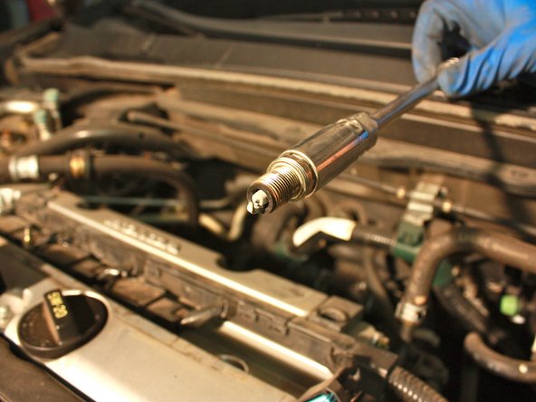

    • Pull the plug out of the bore.
  10. 2003-2007 Honda Accord Spark Plugs Replacement: crwdns2935265:010crwdnd2935265:01crwdnd2935265:01crwdne2935265:0
    • Determine if the spark plug needs to be replaced by examining the gap for the problems listed below:
    • The gap is bridged by corrosion.
    • The gap is too large.
    • The area around the gap is black and dark.
