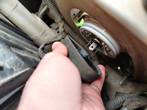

2002 Toyota Tacoma Headlight Bulb Replacement
  1. 2002 Toyota Tacoma Headlight Bulb Replacement, Headlight Bulb: crwdns2935265:01crwdnd2935265:01crwdnd2935265:01crwdne2935265:0
    • Pull the lever under the steering wheel.
  2. 2002 Toyota Tacoma Headlight Bulb Replacement: crwdns2935265:02crwdnd2935265:01crwdnd2935265:02crwdne2935265:0 2002 Toyota Tacoma Headlight Bulb Replacement: crwdns2935265:02crwdnd2935265:02crwdnd2935265:02crwdne2935265:0
    • Pull up on the lever under the hood.
    • At the same time, lift the hood of the car.
  3. 2002 Toyota Tacoma Headlight Bulb Replacement: crwdns2935265:03crwdnd2935265:01crwdnd2935265:02crwdne2935265:0 2002 Toyota Tacoma Headlight Bulb Replacement: crwdns2935265:03crwdnd2935265:02crwdnd2935265:02crwdne2935265:0
    • Remove the metal rod.
    • Insert the metal rod to hold the hood in place.
  4. 2002 Toyota Tacoma Headlight Bulb Replacement: crwdns2935265:04crwdnd2935265:01crwdnd2935265:02crwdne2935265:0 2002 Toyota Tacoma Headlight Bulb Replacement: crwdns2935265:04crwdnd2935265:02crwdnd2935265:02crwdne2935265:0
    • Pinch the rubber cover and disconnect the headlight bulb.
  5. 2002 Toyota Tacoma Headlight Bulb Replacement: crwdns2935265:05crwdnd2935265:01crwdnd2935265:01crwdne2935265:0
    • Push down on the metal lever to release it. After you have released the lever you can remove the bulb.
  6. 2002 Toyota Tacoma Headlight Bulb Replacement: crwdns2935265:06crwdnd2935265:01crwdnd2935265:01crwdne2935265:0
    • Remove the headlight bulb cover when you are ready to install it.
    • Do not touch the bulb or let it touch anything to prevent it from getting damaged.
To reassemble your device, follow steps 3-5 in reverse order. At the end of step 3 make sure to push down on the hood to lock it back into place.
