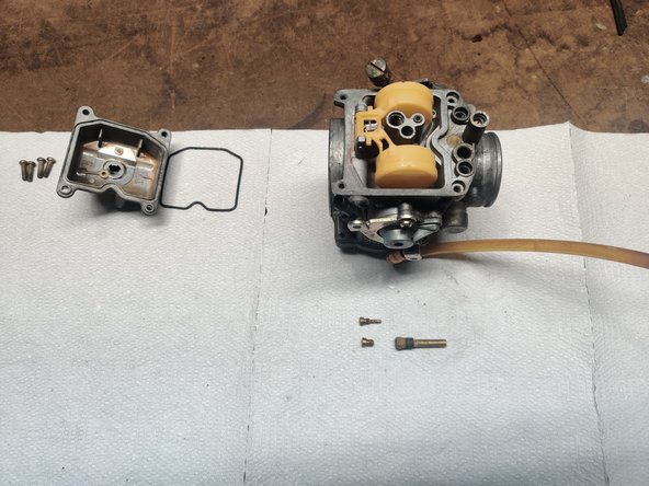

  2. 2002 Kawasaki KLR650 Carburetor Rebuild: crwdns2935265:02crwdnd2935265:01crwdnd2935265:02crwdne2935265:0 2002 Kawasaki KLR650 Carburetor Rebuild: crwdns2935265:02crwdnd2935265:02crwdnd2935265:02crwdne2935265:0
    • Use a Phillips #1 screwdriver to remove the four screws on the outside of the bowl.
    • Remove the bowl from the carburetor and take out the gasket from the bowl.
  3. 2002 Kawasaki KLR650 Carburetor Rebuild: crwdns2935265:03crwdnd2935265:01crwdnd2935265:03crwdne2935265:0 2002 Kawasaki KLR650 Carburetor Rebuild: crwdns2935265:03crwdnd2935265:02crwdnd2935265:03crwdne2935265:0 2002 Kawasaki KLR650 Carburetor Rebuild: crwdns2935265:03crwdnd2935265:03crwdnd2935265:03crwdne2935265:0
    • Remove the pilot jet using a flat head screwdriver.
  4. 2002 Kawasaki KLR650 Carburetor Rebuild: crwdns2935265:04crwdnd2935265:01crwdnd2935265:02crwdne2935265:0 2002 Kawasaki KLR650 Carburetor Rebuild: crwdns2935265:04crwdnd2935265:02crwdnd2935265:02crwdne2935265:0

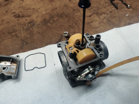

    • Remove the main jet using a flat head screwdriver.
  5. 2002 Kawasaki KLR650 Carburetor Rebuild: crwdns2935265:05crwdnd2935265:01crwdnd2935265:02crwdne2935265:0 2002 Kawasaki KLR650 Carburetor Rebuild: crwdns2935265:05crwdnd2935265:02crwdnd2935265:02crwdne2935265:0
    • Remove the main jet sleeve using an 8 mm combination wrench.
  6. 2002 Kawasaki KLR650 Carburetor Rebuild: crwdns2935265:06crwdnd2935265:01crwdnd2935265:03crwdne2935265:0 2002 Kawasaki KLR650 Carburetor Rebuild: crwdns2935265:06crwdnd2935265:02crwdnd2935265:03crwdne2935265:0 2002 Kawasaki KLR650 Carburetor Rebuild: crwdns2935265:06crwdnd2935265:03crwdnd2935265:03crwdne2935265:0

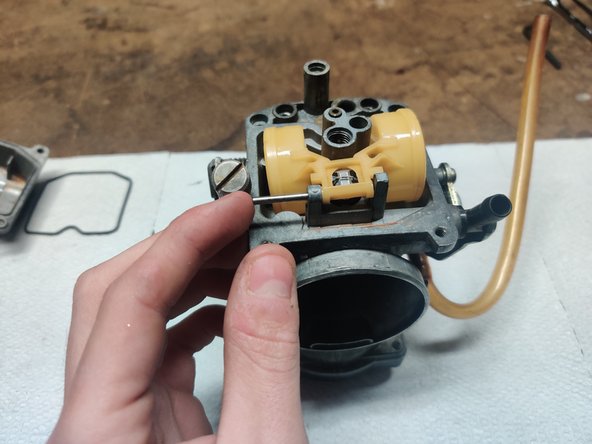

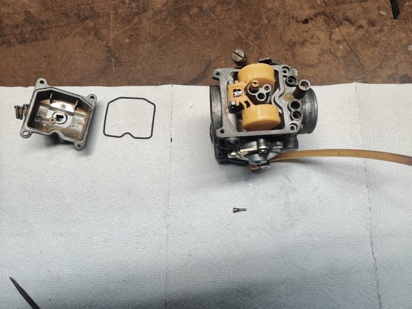

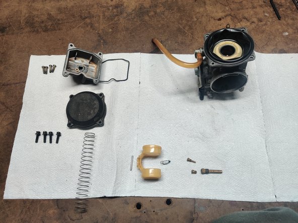

    • Push out the retaining pin holding in the float and float seat.
    • Remove this assembly from the carburetor.

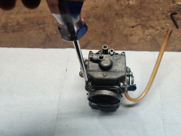

  7. 2002 Kawasaki KLR650 Carburetor Rebuild: crwdns2935265:07crwdnd2935265:01crwdnd2935265:03crwdne2935265:0 2002 Kawasaki KLR650 Carburetor Rebuild: crwdns2935265:07crwdnd2935265:02crwdnd2935265:03crwdne2935265:0 2002 Kawasaki KLR650 Carburetor Rebuild: crwdns2935265:07crwdnd2935265:03crwdnd2935265:03crwdne2935265:0
    • Flip the carburetor around and remove the four screws securing the top housing using a Phillips #1 screwdriver.
    • Note that this is spring loaded.

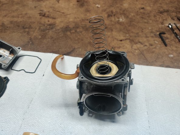

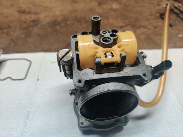

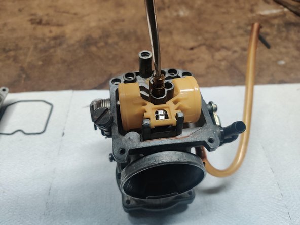

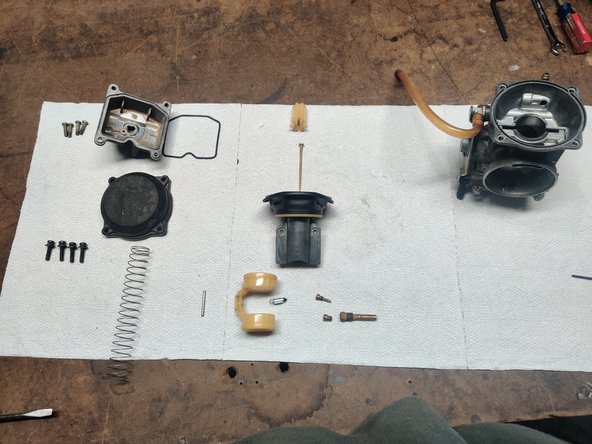

  8. 2002 Kawasaki KLR650 Carburetor Rebuild: crwdns2935265:08crwdnd2935265:01crwdnd2935265:03crwdne2935265:0 2002 Kawasaki KLR650 Carburetor Rebuild: crwdns2935265:08crwdnd2935265:02crwdnd2935265:03crwdne2935265:0 2002 Kawasaki KLR650 Carburetor Rebuild: crwdns2935265:08crwdnd2935265:03crwdnd2935265:03crwdne2935265:0
    • Pull up on the diaphragm carefully to remove the diaphragm and slide.
    • Take out the needle and plastic needle retainer.
  9. 2002 Kawasaki KLR650 Carburetor Rebuild: crwdns2935265:09crwdnd2935265:01crwdnd2935265:03crwdne2935265:0 2002 Kawasaki KLR650 Carburetor Rebuild: crwdns2935265:09crwdnd2935265:02crwdnd2935265:03crwdne2935265:0 2002 Kawasaki KLR650 Carburetor Rebuild: crwdns2935265:09crwdnd2935265:03crwdnd2935265:03crwdne2935265:0
    • Replace the needle and reassemble the slide.
    • Insert the slide assembly back into the carburetor.
    • The needle needs to be lined up with the hole in the carburetor. Make sure that the diaphragm makes a good seal in the carburetor gasket groove.
    • Insert the spring into the slide assembly and put the plastic housing back on.
    • Maintain pressure while screwing the four Phillips screws in the housing since it is spring loaded.
    • Tighten the screws in a diagonal pattern to ensure that the plastic housing is sealed properly.

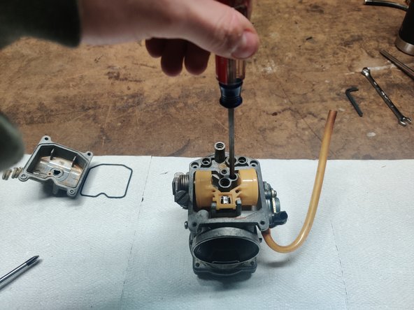

    • Insert the new pilot jet into the carburetor. Tighten it with a flathead screwdriver.
    • Do not over tighten the pilot jet as it is made of brass and may strip easily.
  12. 2002 Kawasaki KLR650 Carburetor Rebuild: crwdns2935265:012crwdnd2935265:01crwdnd2935265:02crwdne2935265:0 2002 Kawasaki KLR650 Carburetor Rebuild: crwdns2935265:012crwdnd2935265:02crwdnd2935265:02crwdne2935265:0
    • Reinsert the main sleeve and tighten with an 8 mm combination wrench.
    • Insert the new main jet into the main jet sleeve. Tighten using a flathead screwdriver.
    • Do not over tighten as this is made out of brass and may strip easily.
