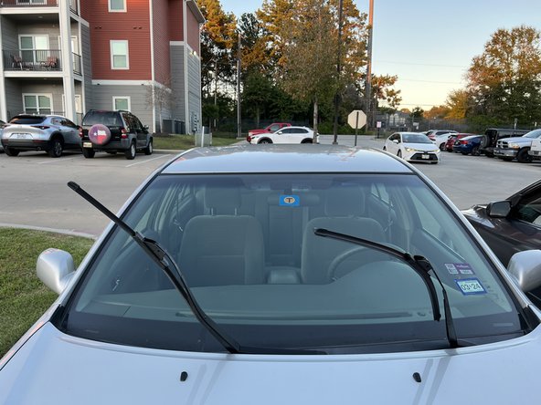

    • Lift windshield wiper arms off the windshield and into the air.

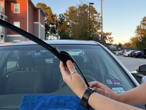

    • Place your thumb and index finger on each side of the small central mechanism.
    • Gently squeeze the small mechanism together with your thumb and index finger and push the mechanism up.
  3. 2002-2006 Toyota Camry Windshield Wiper Replacement: crwdns2935265:03crwdnd2935265:01crwdnd2935265:03crwdne2935265:0 2002-2006 Toyota Camry Windshield Wiper Replacement: crwdns2935265:03crwdnd2935265:02crwdnd2935265:03crwdne2935265:0 2002-2006 Toyota Camry Windshield Wiper Replacement: crwdns2935265:03crwdnd2935265:03crwdnd2935265:03crwdne2935265:0

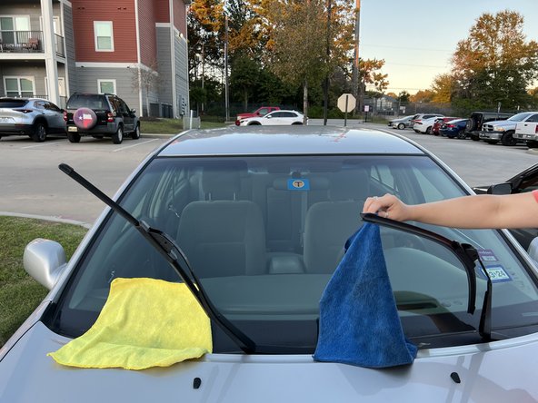

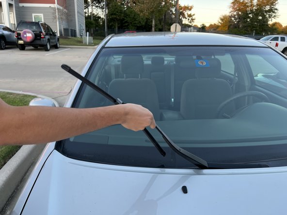

    • Carefully, but firmly, pull windshield wiper blades down towards the hood of the car to “unhook” the blade from the wiper arm.
    • Place your towel on the windshield to protect it in case the arm drops onto the windshield.

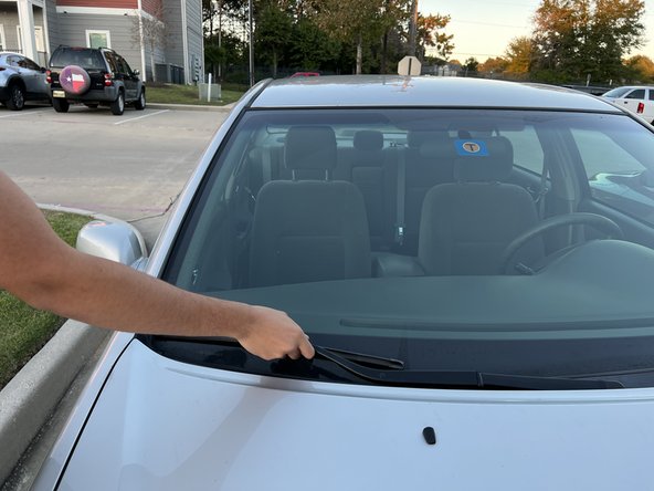

    • On the driver's side, push the 24" wiper blade up towards the sky and into the hooks on the windshield wiper arm. The new blade should firmly click into place.
    • Repeat on the passenger's side using the 19" wiper blade.
