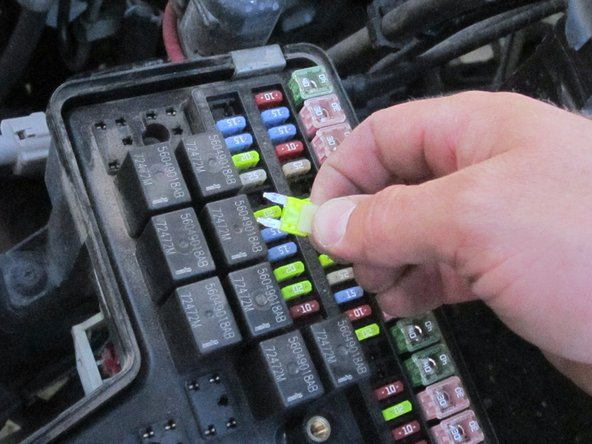

    • Open the hood by pulling the hood lever in the driver-side footwell.
    • Reach under the center of the grille and press the hood latch.
  2. 2002-2008 Dodge Ram 1500 Fuse Replacement: crwdns2935265:02crwdnd2935265:01crwdnd2935265:02crwdne2935265:0 2002-2008 Dodge Ram 1500 Fuse Replacement: crwdns2935265:02crwdnd2935265:02crwdnd2935265:02crwdne2935265:0
    • Locate the fusebox. The fusebox is the box that says "Fuse and Relay Center", near the left front fender of your Dodge.
    • Unscrew the plastic nut that holds the cover of the fusebox in place.
  3. 2002-2008 Dodge Ram 1500 Fuse Replacement: crwdns2935265:03crwdnd2935265:01crwdnd2935265:03crwdne2935265:0 2002-2008 Dodge Ram 1500 Fuse Replacement: crwdns2935265:03crwdnd2935265:02crwdnd2935265:03crwdne2935265:0 2002-2008 Dodge Ram 1500 Fuse Replacement: crwdns2935265:03crwdnd2935265:03crwdnd2935265:03crwdne2935265:0
    • Remove the nut and the cover of the fusebox. Use the inside of the fusebox cover to determine which fuses you need to check.
    • Locate the fuse grabber. The fuse grabber is located near the front of the fusebox.
    • Remove the fuse grabber from its holder.
  4. 2002-2008 Dodge Ram 1500 Fuse Replacement: crwdns2935265:04crwdnd2935265:01crwdnd2935265:02crwdne2935265:0 2002-2008 Dodge Ram 1500 Fuse Replacement: crwdns2935265:04crwdnd2935265:02crwdnd2935265:02crwdne2935265:0
    • Use the fuse grabber to carefully pinch the fuse.
    • Pull the desired fuse out.
    • Be sure to replace each blown fuse with a fuse of the correct current rating and size. Serious damage can occur if the wrong fuse is used.
To replace a fuse, follow these instructions in reverse order. Make sure you buy the correct fuse to replace a blown fuse. Serious damage can occur if you do not use the correct replacement fuses.
