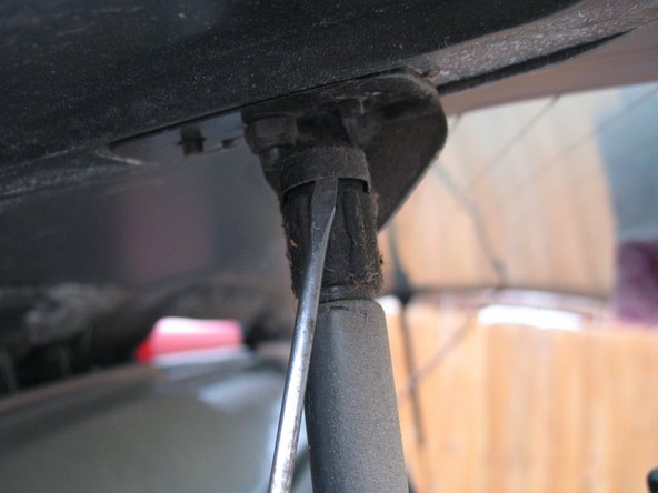

    • Position the small screwdriver on the indentation in the lower joint of the strut.
    • Gently wedge the screwdriver under the metal locking tab and pop it out.
    • You don't have to completely remove the tab—just make sure it doesn't pop back into place. Getting a screwdriver completely under it (as shown) is usually enough.
    • If needed, use the larger screwdriver to help loosen the tab.

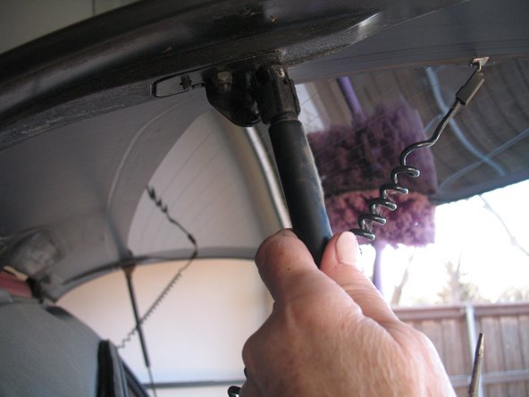

    • Position the screwdriver on the indentation in the upper joint.

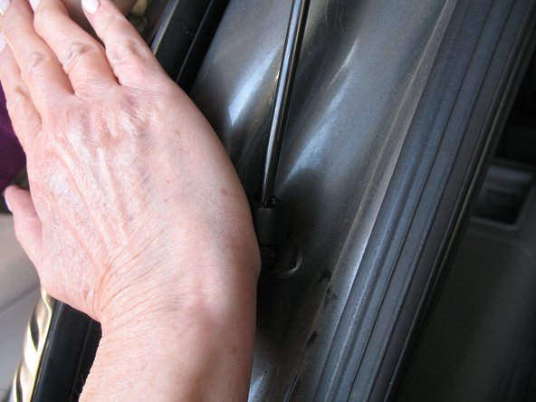

    • Stand at the back of the vehicle (behind the rear bumper) and face the lower joint of the strut.
    • Grab the lower joint.
    • Pull firmly, straight towards you and slightly upwards until the joint pops off.

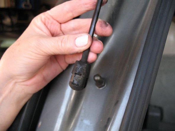

    • Stand at the side of the vehicle and face the upper joint of the strut.
    • Grab the upper joint.
    • Pull firmly, straight towards you until the joint pops off. Do not pull upwards or downwards.

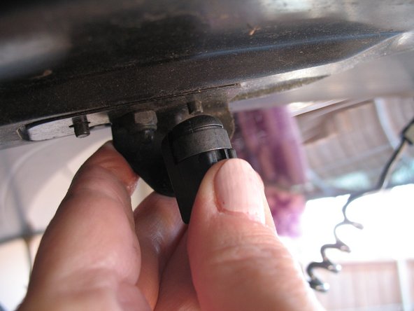

    • Firmly press the joint until it snaps on.
  7. 2001 Chevrolet Suburban Rear Window Struts Replacement: crwdns2935265:07crwdnd2935265:01crwdnd2935265:02crwdne2935265:0 2001 Chevrolet Suburban Rear Window Struts Replacement: crwdns2935265:07crwdnd2935265:02crwdnd2935265:02crwdne2935265:0
    • Align the socket of the bottom joint with the mounting stud.
    • The bottom joint is on the end with the bare metal rod.
