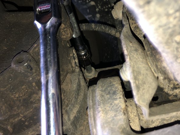

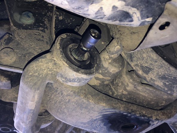

  3. 2001 Audi TT Rear Differential Replacement, Axles: crwdns2935265:03crwdnd2935265:01crwdnd2935265:01crwdne2935265:0
    • Dismount both axles from the rear differential.
