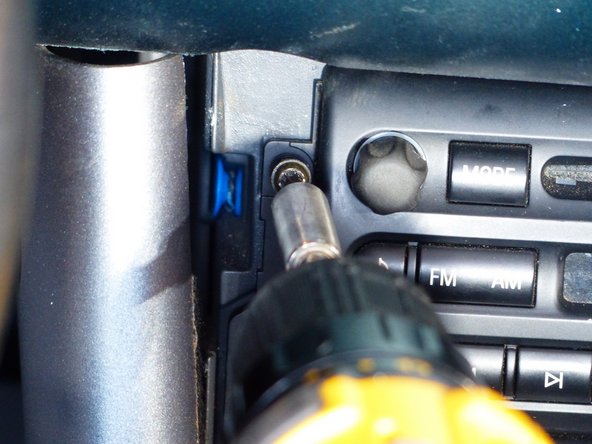

  5. 2001-2006 Mini Cooper Radio Replacement: crwdns2935265:05crwdnd2935265:01crwdnd2935265:03crwdne2935265:0 2001-2006 Mini Cooper Radio Replacement: crwdns2935265:05crwdnd2935265:02crwdnd2935265:03crwdne2935265:0 2001-2006 Mini Cooper Radio Replacement: crwdns2935265:05crwdnd2935265:03crwdnd2935265:03crwdne2935265:0
    • Using a screwdriver with a T20 bit, take out the four M3 x 2 x 20 screws holding the radio in place.
    • Some models have philips head screws instead of the regular torx head depending on age.

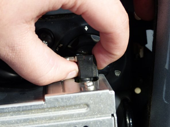

  7. 2001-2006 Mini Cooper Radio Replacement: crwdns2935265:07crwdnd2935265:01crwdnd2935265:03crwdne2935265:0 2001-2006 Mini Cooper Radio Replacement: crwdns2935265:07crwdnd2935265:02crwdnd2935265:03crwdne2935265:0 2001-2006 Mini Cooper Radio Replacement: crwdns2935265:07crwdnd2935265:03crwdnd2935265:03crwdne2935265:0
    • Pinch the antenna connector and pull it straight out.

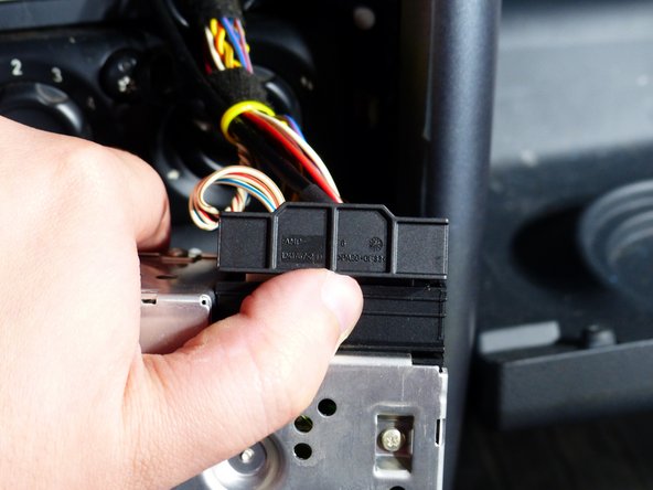

  8. 2001-2006 Mini Cooper Radio Replacement: crwdns2935265:08crwdnd2935265:01crwdnd2935265:02crwdne2935265:0 2001-2006 Mini Cooper Radio Replacement: crwdns2935265:08crwdnd2935265:02crwdnd2935265:02crwdne2935265:0
    • For the main connector, pinch the lever arm with the piece of plastic next to it.
    • Lift up on the arm and pull the connector out.
    • The radio can now be removed from the car.
