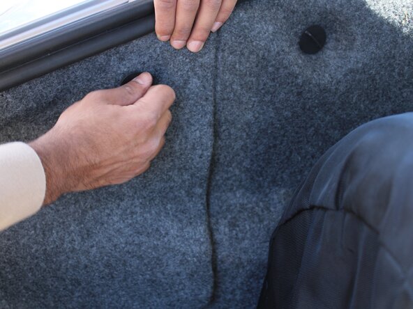

    • Open the front trunk (frunk) using the latch on the left side of the driver’s seat.
  2. 2000 Porsche Boxter Headlight Bulb Replacement: crwdns2935265:02crwdnd2935265:01crwdnd2935265:03crwdne2935265:0 2000 Porsche Boxter Headlight Bulb Replacement: crwdns2935265:02crwdnd2935265:02crwdnd2935265:03crwdne2935265:0 2000 Porsche Boxter Headlight Bulb Replacement: crwdns2935265:02crwdnd2935265:03crwdnd2935265:03crwdne2935265:0

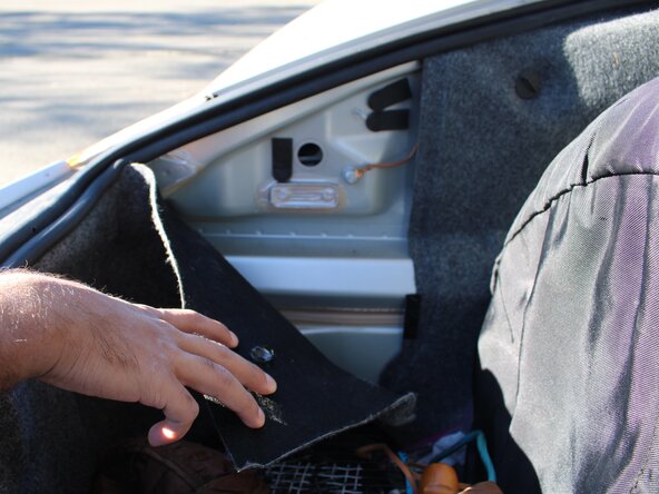

    • Look inside the frunk side panel on the side of the headlight you wish to replace.
    • Unscrew the black clip that holds the side panel to the car, and peel it back.

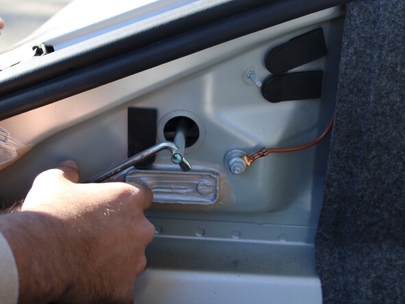

  3. 2000 Porsche Boxter Headlight Bulb Replacement: crwdns2935265:03crwdnd2935265:01crwdnd2935265:01crwdne2935265:0
    • Insert the 5 mm Allen wrench into the locking mechanism, and turn it counterclockwise until you hear a “pop” sound.

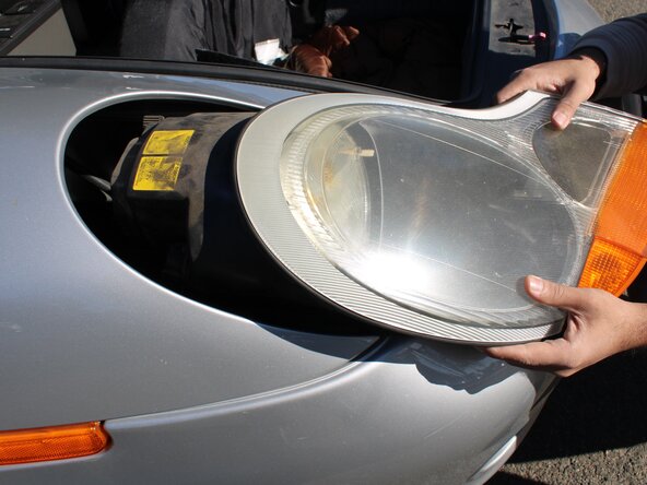

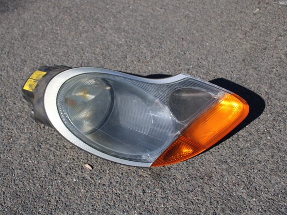

    • The headlight will be loose now.
    • Carefully slide the headlight forward out of the car.

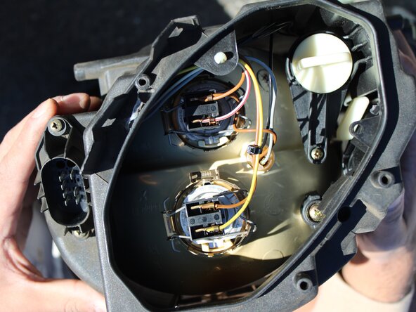

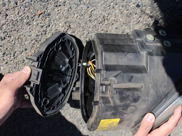

  5. 2000 Porsche Boxter Headlight Bulb Replacement: crwdns2935265:05crwdnd2935265:01crwdnd2935265:03crwdne2935265:0 2000 Porsche Boxter Headlight Bulb Replacement: crwdns2935265:05crwdnd2935265:02crwdnd2935265:03crwdne2935265:0 2000 Porsche Boxter Headlight Bulb Replacement: crwdns2935265:05crwdnd2935265:03crwdnd2935265:03crwdne2935265:0
    • Remove the plastic cover from the back of the headlight, by pressing the clip that reads PUSH.
    • Pull off and remove the cover, placing it aside.

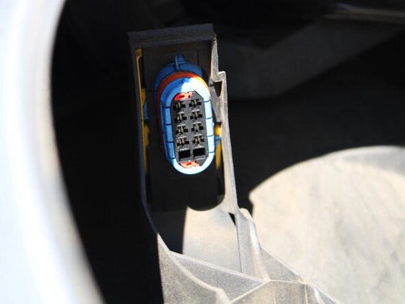

    • You will see two wire plugs after removing the cover.

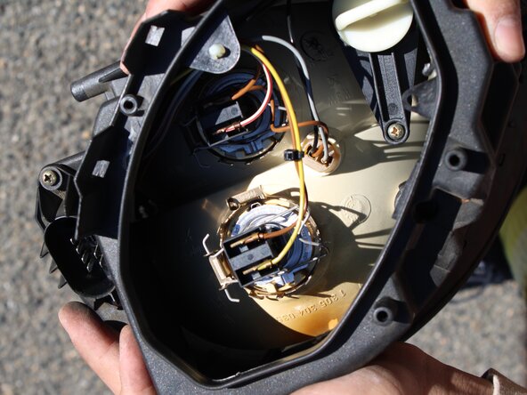

  6. 2000 Porsche Boxter Headlight Bulb Replacement: crwdns2935265:06crwdnd2935265:01crwdnd2935265:01crwdne2935265:0
    • Carefully disconnect the wire plug where you wish to replace the bulb.
    • If necessary, gently wiggle it side-to-side while pulling.

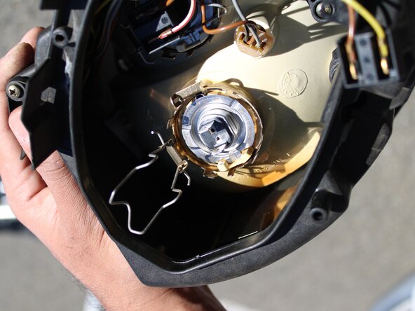

  7. 2000 Porsche Boxter Headlight Bulb Replacement: crwdns2935265:07crwdnd2935265:01crwdnd2935265:02crwdne2935265:0 2000 Porsche Boxter Headlight Bulb Replacement: crwdns2935265:07crwdnd2935265:02crwdnd2935265:02crwdne2935265:0

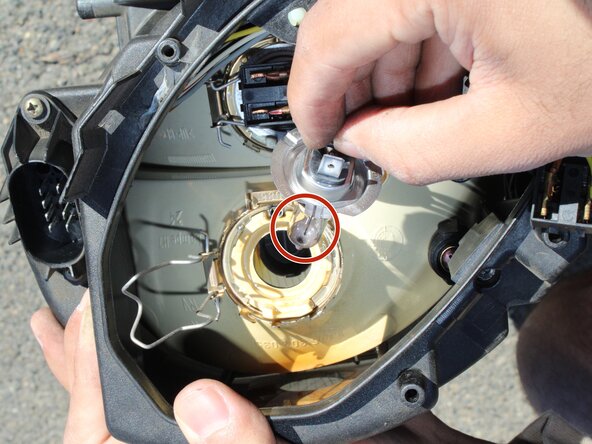

    • The old bulb is secured with a metal clip.
    • Carefully press the retaining spring clip and release it.
    • Once the clip is released, lift it up completely to fully open it, leaving the bulb loose.
  8. 2000 Porsche Boxter Headlight Bulb Replacement: crwdns2935265:08crwdnd2935265:01crwdnd2935265:02crwdne2935265:0 2000 Porsche Boxter Headlight Bulb Replacement: crwdns2935265:08crwdnd2935265:02crwdnd2935265:02crwdne2935265:0
    • Avoid touching the glass of the new bulb with bare fingers—oil from your skin can shorten its lifespan.
    • Gently pull the old bulb out, and insert the new H7 or H1 bulb, with the bulb side facing towards the entrypoint.

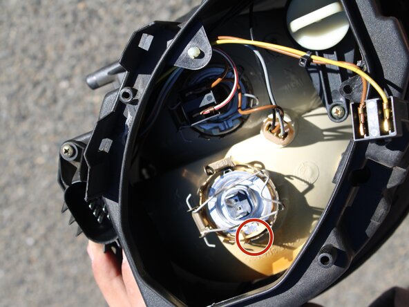

  9. 2000 Porsche Boxter Headlight Bulb Replacement: crwdns2935265:09crwdnd2935265:01crwdnd2935265:03crwdne2935265:0 2000 Porsche Boxter Headlight Bulb Replacement: crwdns2935265:09crwdnd2935265:02crwdnd2935265:03crwdne2935265:0 2000 Porsche Boxter Headlight Bulb Replacement: crwdns2935265:09crwdnd2935265:03crwdnd2935265:03crwdne2935265:0
    • Ensure the wiring is restored to its original layout; otherwise the bulb will not illuminate.
    • Make sure the metal notch of the bulb is aligned properly with the bulb housing.
    • Secure the retaining clip back in place.
    • Reconnect the wiring plug back in.
  10. 2000 Porsche Boxter Headlight Bulb Replacement: crwdns2935265:010crwdnd2935265:01crwdnd2935265:01crwdne2935265:0
    • Reattach the plastic cover back in place by alligning its attachment points, then gently press it into place.
    • Secure by pressing down the PUSH button to ensure it clicks, and preventing the cover from detaching.

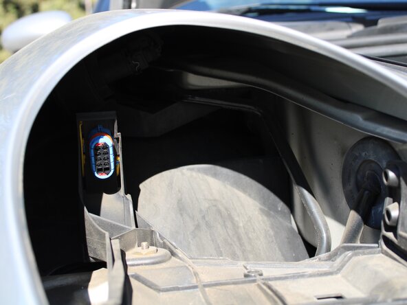

    • Line up the headlight connector and the car slot before sliding the headlight in.
  12. 2000 Porsche Boxter Headlight Bulb Replacement: crwdns2935265:012crwdnd2935265:01crwdnd2935265:02crwdne2935265:0 2000 Porsche Boxter Headlight Bulb Replacement: crwdns2935265:012crwdnd2935265:02crwdnd2935265:02crwdne2935265:0
    • If the headlight doesn’t align properly, remove and reset it before locking in place.
    • Carefully slide the headlight back into its slot.
    • Use the 5mm Allen wrench and turn the locking mechanism clockwise to lock the headlight back in place.
    • You should hear a “pop” once it is secured.
