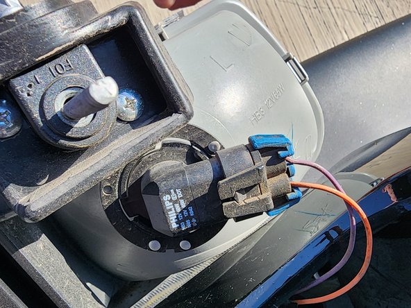

  5. 2000 Chevrolet Silverado Headlight Bulb Replacement: crwdns2935265:05crwdnd2935265:01crwdnd2935265:02crwdne2935265:0 2000 Chevrolet Silverado Headlight Bulb Replacement: crwdns2935265:05crwdnd2935265:02crwdnd2935265:02crwdne2935265:0
    • Rotate the headlight bulb counterclockwise to remove it from the headlight housing.
  6. 2000 Chevrolet Silverado Headlight Bulb Replacement: crwdns2935265:06crwdnd2935265:01crwdnd2935265:01crwdne2935265:0
    • Unplug the connector from the headlight bulb.

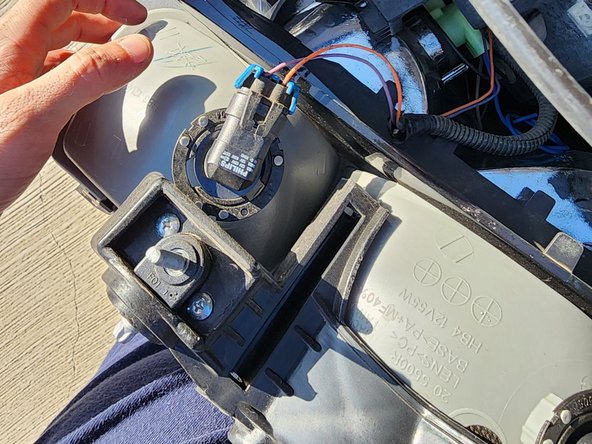

  9. 2000 Chevrolet Silverado Headlight Bulb Replacement: crwdns2935265:09crwdnd2935265:01crwdnd2935265:02crwdne2935265:0 2000 Chevrolet Silverado Headlight Bulb Replacement: crwdns2935265:09crwdnd2935265:02crwdnd2935265:02crwdne2935265:0
    • Insert the headlight back into the vehicle and secure with the retaining pins.
