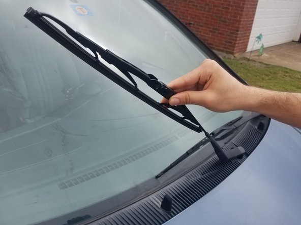

    • Lift the windshield wiper to a 90-degree angle above the windshield.
  2. 2000-2003 Toyota Sienna Windshield Wiper Replacement: crwdns2935265:02crwdnd2935265:01crwdnd2935265:03crwdne2935265:0 2000-2003 Toyota Sienna Windshield Wiper Replacement: crwdns2935265:02crwdnd2935265:02crwdnd2935265:03crwdne2935265:0 2000-2003 Toyota Sienna Windshield Wiper Replacement: crwdns2935265:02crwdnd2935265:03crwdnd2935265:03crwdne2935265:0

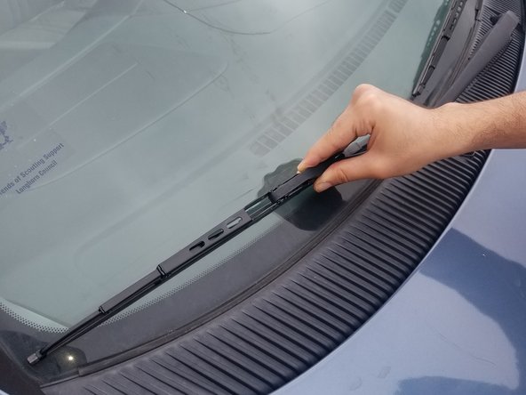

    • Tilt the wiper upwards.
    • Pull the wiper blade down to release it from the j-hook.
    • Different brands of wipers use different unlatching mechanisms; these vary from pinching and pulling to pushing a button.

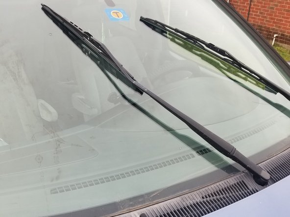

  3. 2000-2003 Toyota Sienna Windshield Wiper Replacement: crwdns2935265:03crwdnd2935265:01crwdnd2935265:01crwdne2935265:0
    • Lay the arm back down onto the windshield.
    • Place the arm gently back down to avoid any damage.
