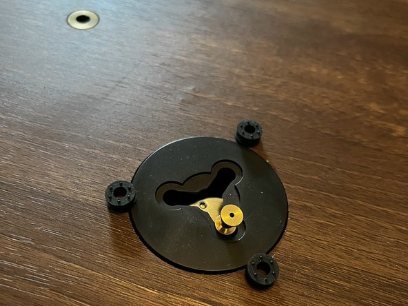

  3. 1byone H004 Hi-Fi Turntable Motor Replacement, Unset motor from turntable body: crwdns2935265:03crwdnd2935265:01crwdnd2935265:02crwdne2935265:0 1byone H004 Hi-Fi Turntable Motor Replacement, Unset motor from turntable body: crwdns2935265:03crwdnd2935265:02crwdnd2935265:02crwdne2935265:0
    • A #1 Phillips-head bit is recommended to remove these screws
    • Remove and set aside the rubber washers so they don't fall into the turntable body.

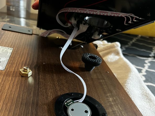

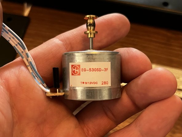

  5. 1byone H004 Hi-Fi Turntable Motor Replacement, Remove motor from circuit: crwdns2935265:05crwdnd2935265:01crwdnd2935265:03crwdne2935265:0 1byone H004 Hi-Fi Turntable Motor Replacement, Remove motor from circuit: crwdns2935265:05crwdnd2935265:02crwdnd2935265:03crwdne2935265:0 1byone H004 Hi-Fi Turntable Motor Replacement, Remove motor from circuit: crwdns2935265:05crwdnd2935265:03crwdnd2935265:03crwdne2935265:0
    • There are no latches on the PCB connector. Simply pull on the connector to remove from the main circuit board.
    • The motor has the serial number: EG-530SD-3F

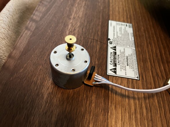

  6. 1byone H004 Hi-Fi Turntable Motor Replacement, Insert replacement motor: crwdns2935265:06crwdnd2935265:01crwdnd2935265:01crwdne2935265:0
    • If your replacement part does not include a connector or the necessary wires, you may need to remove and re-solder the new motor to the existing wires.

Great guide - I was able to swap the motor out successfully. Just to note: the EG-530SD-3F motor I ordered had a JST connector attached, which I had to remove (it won't fit inside the motor housing otherwise). I re-soldered the cable to the new motor as described.

Some additions:
a) Before swapping the motor, try to clean the pulley, sometimes it accumulates some gunk like on the pictures in the guide. That can affect traction.
b) There are replacement motors that have a slighly different pulley diameter. This means you will have to adjust the turntable speed after the replacement! That's what the trimming potentiometers in the holes under the rubber covers on the underside of the motor are meant for. The one labeled "H" is for 45 rpm adjustment, the one labeled "L" for 33 1/3 rpm.
There are smart phone apps that can be used to calibrate the speed, using the gyroscopes in modern smart phones to measure the actual rpm.
