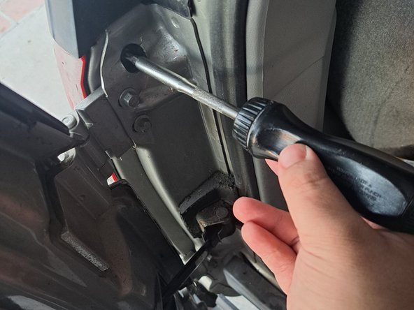

  2. 1999 GMC Suburban Brake Light Replacement: crwdns2935265:02crwdnd2935265:01crwdnd2935265:03crwdne2935265:0 1999 GMC Suburban Brake Light Replacement: crwdns2935265:02crwdnd2935265:02crwdnd2935265:03crwdne2935265:0 1999 GMC Suburban Brake Light Replacement: crwdns2935265:02crwdnd2935265:03crwdnd2935265:03crwdne2935265:0
    • These two holes have screws inside of them, so unscrew them to get the brake light out.
    • The screws that will be removed for this step are "Round washer head pozi-drive tapping screw tail lamp assembly M4.2-1.41 x 20mm".

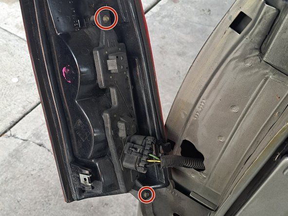

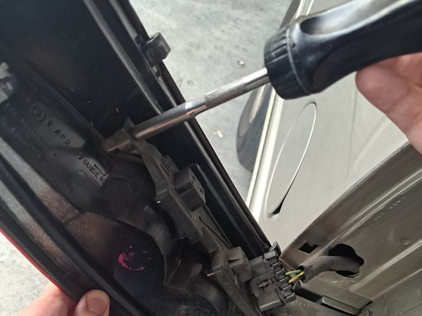

  3. 1999 GMC Suburban Brake Light Replacement: crwdns2935265:03crwdnd2935265:01crwdnd2935265:03crwdne2935265:0 1999 GMC Suburban Brake Light Replacement: crwdns2935265:03crwdnd2935265:02crwdnd2935265:03crwdne2935265:0 1999 GMC Suburban Brake Light Replacement: crwdns2935265:03crwdnd2935265:03crwdnd2935265:03crwdne2935265:0
    • When removing the tail light there are little hooks with holes that are used to hold them in place as shown in the first photo.
    • The tail should already be loose from the previous step so pull it out slowly by turning it on its side and then pulling forward.
    • Use the 7 mm socket to unscrew the two bolts securing the brake light housing to the tail light assembly.
    • The screws in this step are "Rexka 30pcs M4.2-1.41 x 20mm".

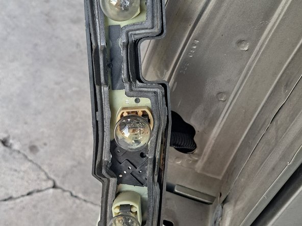

  4. 1999 GMC Suburban Brake Light Replacement: crwdns2935265:04crwdnd2935265:01crwdnd2935265:02crwdne2935265:0 1999 GMC Suburban Brake Light Replacement: crwdns2935265:04crwdnd2935265:02crwdnd2935265:02crwdne2935265:0
    • After taking off the screws, take the brake lights out and find which light isn't working by stepping on the brake.
  5. 1999 GMC Suburban Brake Light Replacement: crwdns2935265:05crwdnd2935265:01crwdnd2935265:01crwdne2935265:0
    • With the actual light, unplug them by pulling them out but not with too much force.
    • Plug the new light bulb(s) in place of the ones that don't work.
    • Please be careful with how you remove the bulbs because they are made of glass.
