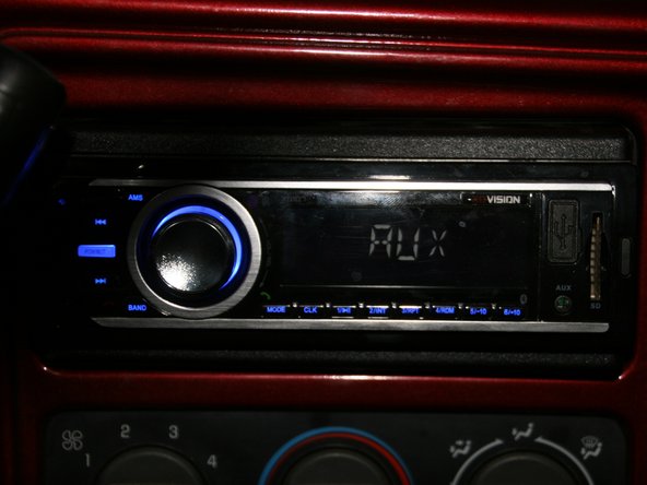

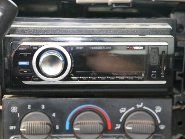

1999 GMC Sierra Radio Replacement Radio Replacement
  1. 1999 GMC Sierra Radio Replacement Radio Replacement, Radio: crwdns2935265:01crwdnd2935265:01crwdnd2935265:03crwdne2935265:0 1999 GMC Sierra Radio Replacement Radio Replacement, Radio: crwdns2935265:01crwdnd2935265:02crwdnd2935265:03crwdne2935265:0 1999 GMC Sierra Radio Replacement Radio Replacement, Radio: crwdns2935265:01crwdnd2935265:03crwdnd2935265:03crwdne2935265:0

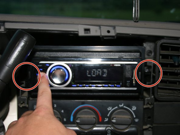

    • Use the gear shift to shift the truck from 'Park' to '1st Gear' so that the dash face is easily accessible.
    • Pop the dash face off, and place it to the side until the radio has been replaced

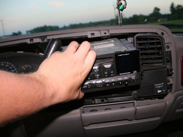

  2. 1999 GMC Sierra Radio Replacement Radio Replacement: crwdns2935265:02crwdnd2935265:01crwdnd2935265:03crwdne2935265:0 1999 GMC Sierra Radio Replacement Radio Replacement: crwdns2935265:02crwdnd2935265:02crwdnd2935265:03crwdne2935265:0 1999 GMC Sierra Radio Replacement Radio Replacement: crwdns2935265:02crwdnd2935265:03crwdnd2935265:03crwdne2935265:0

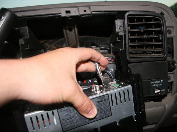

    • Remove the radio from its place.

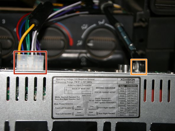

    • Remove the bundled cable connector from the back of the radio unit.
    • Remove the antenna plug from the back of the radio unit.
