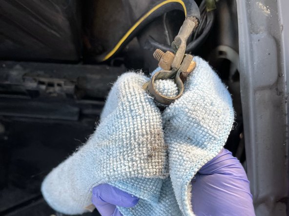

  4. 1998-2001 Nissan Altima Battery Replacement: crwdns2935265:04crwdnd2935265:01crwdnd2935265:03crwdne2935265:0 1998-2001 Nissan Altima Battery Replacement: crwdns2935265:04crwdnd2935265:02crwdnd2935265:03crwdne2935265:0 1998-2001 Nissan Altima Battery Replacement: crwdns2935265:04crwdnd2935265:03crwdnd2935265:03crwdne2935265:0
    • If the terminals are corroded, take the corrosion brush and insert the terminal into it and turn until the corrosion is gone.
    • If there is no corrosion, go to the next step.

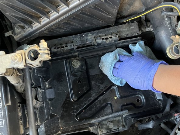

  5. 1998-2001 Nissan Altima Battery Replacement: crwdns2935265:05crwdnd2935265:01crwdnd2935265:03crwdne2935265:0 1998-2001 Nissan Altima Battery Replacement: crwdns2935265:05crwdnd2935265:02crwdnd2935265:03crwdne2935265:0 1998-2001 Nissan Altima Battery Replacement: crwdns2935265:05crwdnd2935265:03crwdnd2935265:03crwdne2935265:0
    • Remove the battery from the base.
    • Be careful as the battery is heavy. To prevent leakage of battery acid, never turn it upside down.
    • Wipe down the base and clamps with a damp rag to remove any dirt or dust that might be present.
  6. 1998-2001 Nissan Altima Battery Replacement: crwdns2935265:06crwdnd2935265:01crwdnd2935265:03crwdne2935265:0 1998-2001 Nissan Altima Battery Replacement: crwdns2935265:06crwdnd2935265:02crwdnd2935265:03crwdne2935265:0 1998-2001 Nissan Altima Battery Replacement: crwdns2935265:06crwdnd2935265:03crwdnd2935265:03crwdne2935265:0
    • Dry the base and clamps fully with a dry rag.
    • The clamps must be fully dry.
    • Place the new battery into the base, making sure that the bracket on the bottom is in place.
