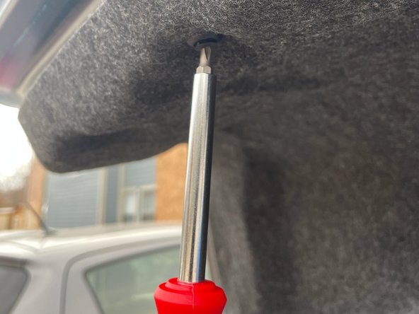

    • Open the trunk.
    • Loosen three 15 mm screws using a Phillips #1 screwdriver.
    • Pull the cover clips at the base to remove.
    • Potential for device damage: Do not pull the cover clips prior to unscrewing as the cover clips can break.
    • Remove the cover by folding the cover backwards to expose the bulb assembly.
