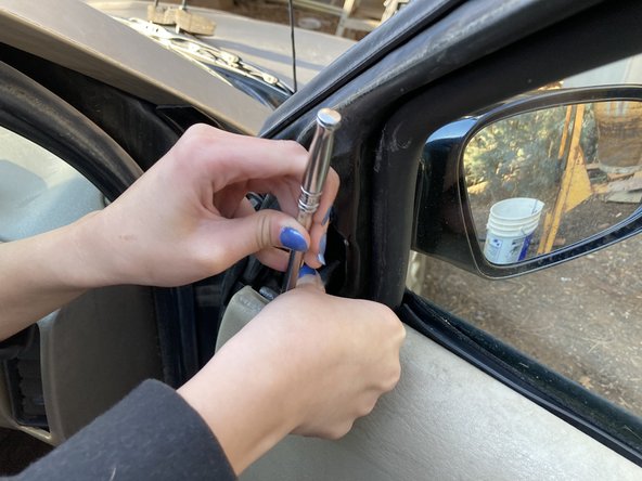

    • Pry the plastic panel away from the base of the side mirror with a metal spudger or your hands.

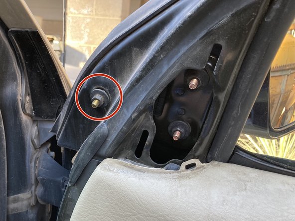

    • Remove the three 10 mm bolts using the 10 mm socket and ratchet extension.
    • If there is an existing side mirror attached, hold it to keep it from falling.

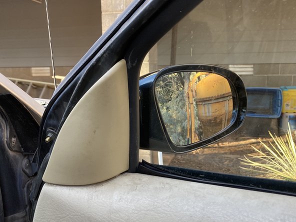

    • Replace the plastic panel by snapping it back on.
