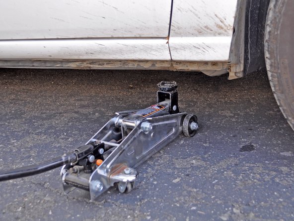

    • Begin by locating the jacking point. It is on the passenger side of the car, just behind the front wheel.
    • Place the jack between the two notches and jack the car up.
    • It is helpful, but not necessary, to jack up both sides of the car. Since the oil drain plug is on the passenger side of the car, jacking just the passenger side should be sufficient.

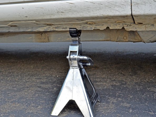

    • Lift the car high enough so that you can place a jack stand beside the jack. Slide the stand under the car, making sure that the top of the stand will connect to a solid portion of the car's frame when the car is lowered.
    • Slowly lower the jack so that the car is resting on the jack stand. Remove the jack.
    • Many hydraulic jacks are lowered by placing the open end of the handle over a knob and turning it counter-clockwise. Consult your owners manual for your jack if you don't know how to lower it.
    • Never work underneath a car that is only supported by a jack. The jack may slip or fail, resulting in serious injury or death.

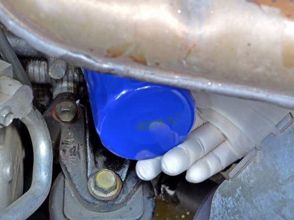

  8. 1997-2001 Toyota Camry Oil Change (3.0 L V6): crwdns2935265:08crwdnd2935265:01crwdnd2935265:02crwdne2935265:0 1997-2001 Toyota Camry Oil Change (3.0 L V6): crwdns2935265:08crwdnd2935265:02crwdnd2935265:02crwdne2935265:0
    • Use your hand to turn the oil filter counter-clockwise until it comes off the threads.
    • Pull the oil filter out of the engine bay with the threaded end facing up to prevent oil from spilling. Set the oil filter aside with the threads facing upwards.
    • If the filter is too tight to loosen by hand, use an oil filter wrench. A wrench that fits over the top of the oil filter would be ideal as there is very little space on the sides of the oil filter.

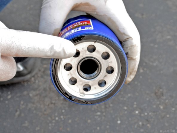

  9. 1997-2001 Toyota Camry Oil Change (3.0 L V6): crwdns2935265:09crwdnd2935265:01crwdnd2935265:03crwdne2935265:0 1997-2001 Toyota Camry Oil Change (3.0 L V6): crwdns2935265:09crwdnd2935265:02crwdnd2935265:03crwdne2935265:0 1997-2001 Toyota Camry Oil Change (3.0 L V6): crwdns2935265:09crwdnd2935265:03crwdnd2935265:03crwdne2935265:0
    • Wipe off the previous oil from the engine's oil filter threads, filter seal face, and any parts that were dripped on.
    • Use a clean glove to apply a thin layer of new oil onto the gasket of the new oil filter.
    • Place the filter on the engine's oil filter threads and turn it clockwise by hand until it is snug.
    • Do not over-tighten or you may strip the oil filter threads.

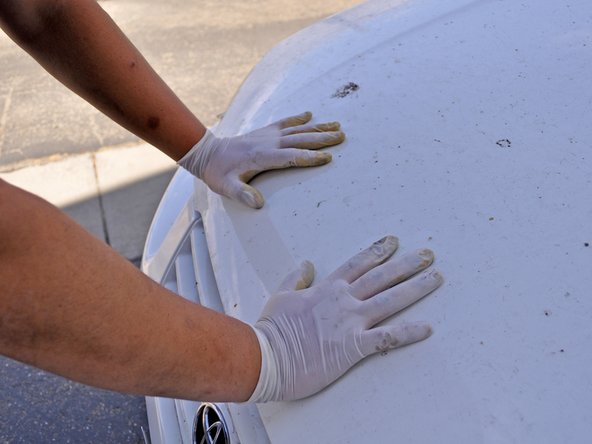

  13. 1997-2001 Toyota Camry Oil Change (3.0 L V6): crwdns2935265:013crwdnd2935265:01crwdnd2935265:02crwdne2935265:0 1997-2001 Toyota Camry Oil Change (3.0 L V6): crwdns2935265:013crwdnd2935265:02crwdnd2935265:02crwdne2935265:0
    • Use one hand to support the hood and your other hand to lower the hood prop rod back into its holder.
    • Make sure the hood prop rod is clipped into its holder to prevent damaging it.
    • Gently lower the hood until it clicks into the secondary latch.
    • Press firmly on the hood until it clicks again, indicating that the primary latch has engaged.
