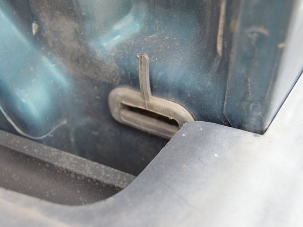

    • Open the trunk door. In order to remove the rear light assembly, it must be accessed with the trunk open.
  2. 1997-2001 Jeep Cherokee Brake Light Replacement: crwdns2935265:02crwdnd2935265:01crwdnd2935265:01crwdne2935265:0
    • Remove the three screws that are holding the rear light assembly to the body of the Jeep. Use the wrench to remove the screws.

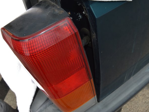

  3. 1997-2001 Jeep Cherokee Brake Light Replacement: crwdns2935265:03crwdnd2935265:01crwdnd2935265:01crwdne2935265:0
    • Gently pull the rear light assembly away from the car to gain access to the bulbs and wires.
    • Be careful when pulling away the rear light assembly. The wires will still be attached to the inside of the car.

  9. 1997-2001 Jeep Cherokee Brake Light Replacement: crwdns2935265:09crwdnd2935265:01crwdnd2935265:03crwdne2935265:0 1997-2001 Jeep Cherokee Brake Light Replacement: crwdns2935265:09crwdnd2935265:02crwdnd2935265:03crwdne2935265:0 1997-2001 Jeep Cherokee Brake Light Replacement: crwdns2935265:09crwdnd2935265:03crwdnd2935265:03crwdne2935265:0
    • Set the light assembly back in place. There is a tab on the bottom of the light assembly that must line up with the hole in the car.
    • The red brake light should be on top.

It is not easy to get the taillight assembly back into the slot. The side bumper prevents direct access. However, it is possible if done bottom in first gently but firmly.
