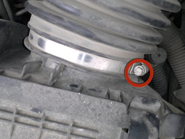

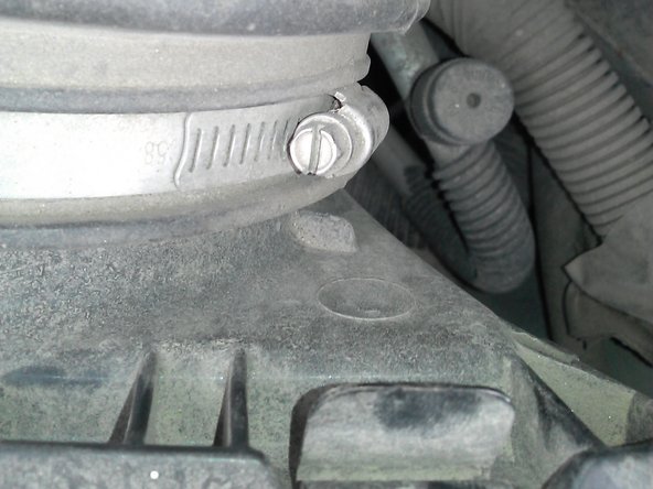

  3. 1997-2003 Pontiac Grand Prix GT Air Filter Replacement, Removing the Intake Tube Brace: crwdns2935265:03crwdnd2935265:01crwdnd2935265:02crwdne2935265:0 1997-2003 Pontiac Grand Prix GT Air Filter Replacement, Removing the Intake Tube Brace: crwdns2935265:03crwdnd2935265:02crwdnd2935265:02crwdne2935265:0

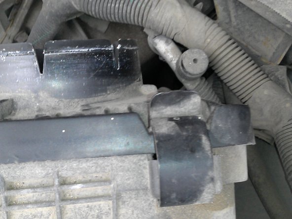

    • Using the flat-head screwdriver, unscrew the brace until it is very loose. but not completely off!

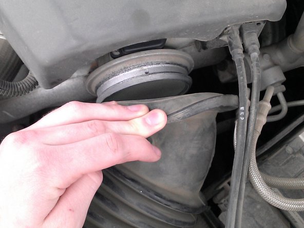

    • Simply tug on the rim of the tube and pull downward.
    • It's not meant to come off easily, so it will take some working to get it off.
    • There, your intake tube is now off. Set this somewhere you will not lose it.

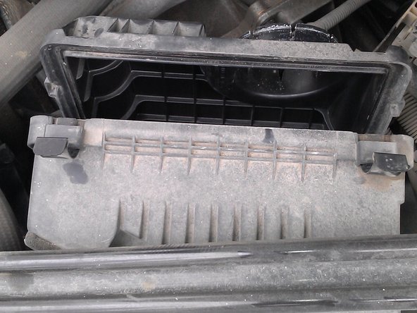

    • Undue the two tabs on the left and right sides of the filter box and lift the cover out.
    • Put the cover somewhere you will not lose.

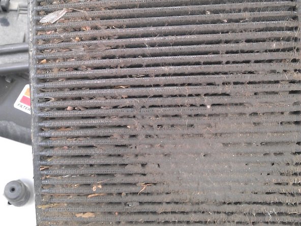

  6. 1997-2003 Pontiac Grand Prix GT Air Filter Replacement, Removing the Old Filter: crwdns2935265:06crwdnd2935265:01crwdnd2935265:02crwdne2935265:0 1997-2003 Pontiac Grand Prix GT Air Filter Replacement, Removing the Old Filter: crwdns2935265:06crwdnd2935265:02crwdnd2935265:02crwdne2935265:0
    • Use the indent under the tab to pull the filter out.
    • The second photo shows why changing the air filter is important. A dirty filter makes it harder for the engine to breathe.
    • Put the old filter in the trash, you have no need for it anymore.

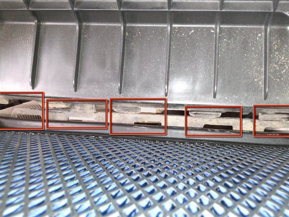

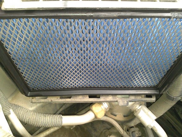

  7. 1997-2003 Pontiac Grand Prix GT Air Filter Replacement, Installing the New Filter: crwdns2935265:07crwdnd2935265:01crwdnd2935265:03crwdne2935265:0 1997-2003 Pontiac Grand Prix GT Air Filter Replacement, Installing the New Filter: crwdns2935265:07crwdnd2935265:02crwdnd2935265:03crwdne2935265:0 1997-2003 Pontiac Grand Prix GT Air Filter Replacement, Installing the New Filter: crwdns2935265:07crwdnd2935265:03crwdnd2935265:03crwdne2935265:0
    • The filter must go in the same direction as shown in the first photo.
    • The second photo shows the view of it from the inside of the engine bay.
    • When putting the filter box cover back on, be sure to line up the tabs and holes at the bottom of the box. Then securely snap the tabs back onto the filter box.
  8. 1997-2003 Pontiac Grand Prix GT Air Filter Replacement, Reattaching the Intake Tube: crwdns2935265:08crwdnd2935265:01crwdnd2935265:03crwdne2935265:0 1997-2003 Pontiac Grand Prix GT Air Filter Replacement, Reattaching the Intake Tube: crwdns2935265:08crwdnd2935265:02crwdnd2935265:03crwdne2935265:0 1997-2003 Pontiac Grand Prix GT Air Filter Replacement, Reattaching the Intake Tube: crwdns2935265:08crwdnd2935265:03crwdnd2935265:03crwdne2935265:0
    • Push the engine side of the intake tube on first. Be sure to firmly press it back into place. You do not want the intake tube coming off while driving down the road.

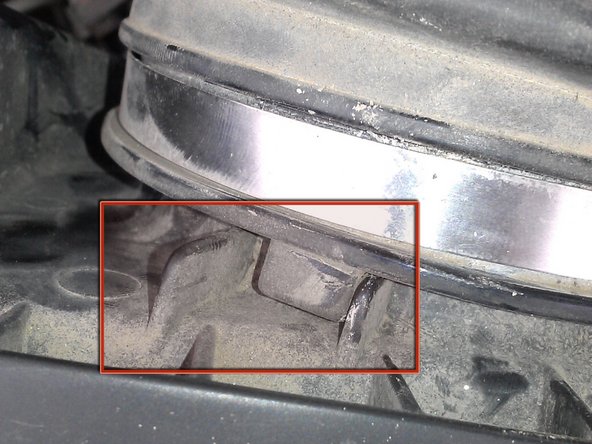

    • For the filter-box half of the intake tube, first be sure to place the little tab on the tube inside of the notch as shown in the second photo.
    • Now tighten up that screw. Get it very tight. As with the other end of the intake tube, you do not want it coming off while driving.

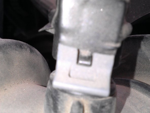

  9. 1997-2003 Pontiac Grand Prix GT Air Filter Replacement, Reattach the Sensor: crwdns2935265:09crwdnd2935265:01crwdnd2935265:02crwdne2935265:0 1997-2003 Pontiac Grand Prix GT Air Filter Replacement, Reattach the Sensor: crwdns2935265:09crwdnd2935265:02crwdnd2935265:02crwdne2935265:0
    • This is also critical, forgetting this could be fatal for your car!
    • Line up the plastic tab and push it into place. You should hear a small click.
    • lightly tug on it to be sure it is in place.
