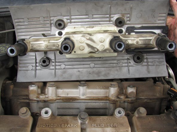

  3. 1997-2003 Chevrolet Malibu Spark Plugs Replacement: crwdns2935265:03crwdnd2935265:01crwdnd2935265:02crwdne2935265:0 1997-2003 Chevrolet Malibu Spark Plugs Replacement: crwdns2935265:03crwdnd2935265:02crwdnd2935265:02crwdne2935265:0
    • Remove the spark plug cover.

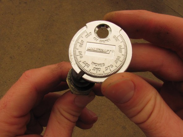

    • Before installing the new spark plugs check that the spark plugs' gap is between 0.048 and 0.052 inches.
    • If it needs to be widened, use a gap setter to increase the size of the gap until it reaches the desired width.
